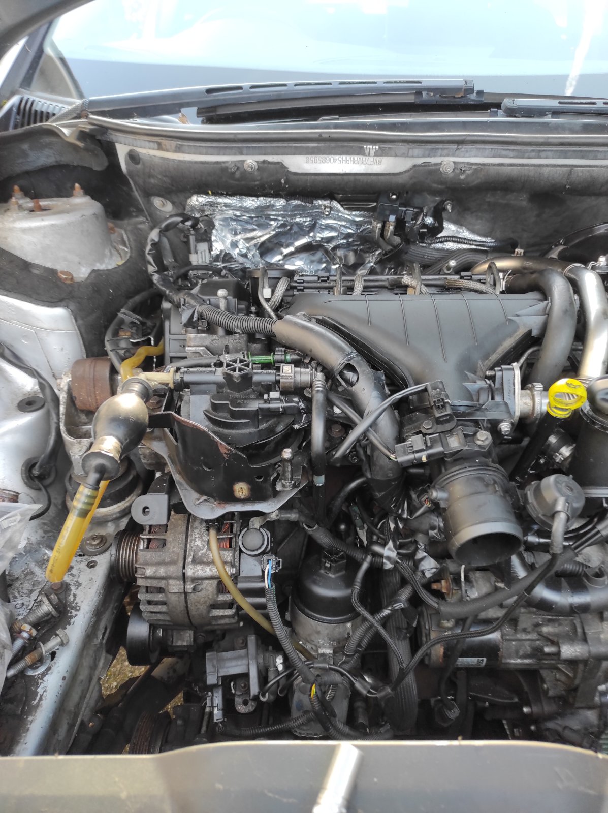

Hi Lads just waiting on a gasket for the egr valve and need to pick up a new 5mm bolt for the cam sensor. I should be ready to refit the engine and gearbox then
. Then hopefully she'll start without too much hassle.if it doesn't I think I will lose the plot.

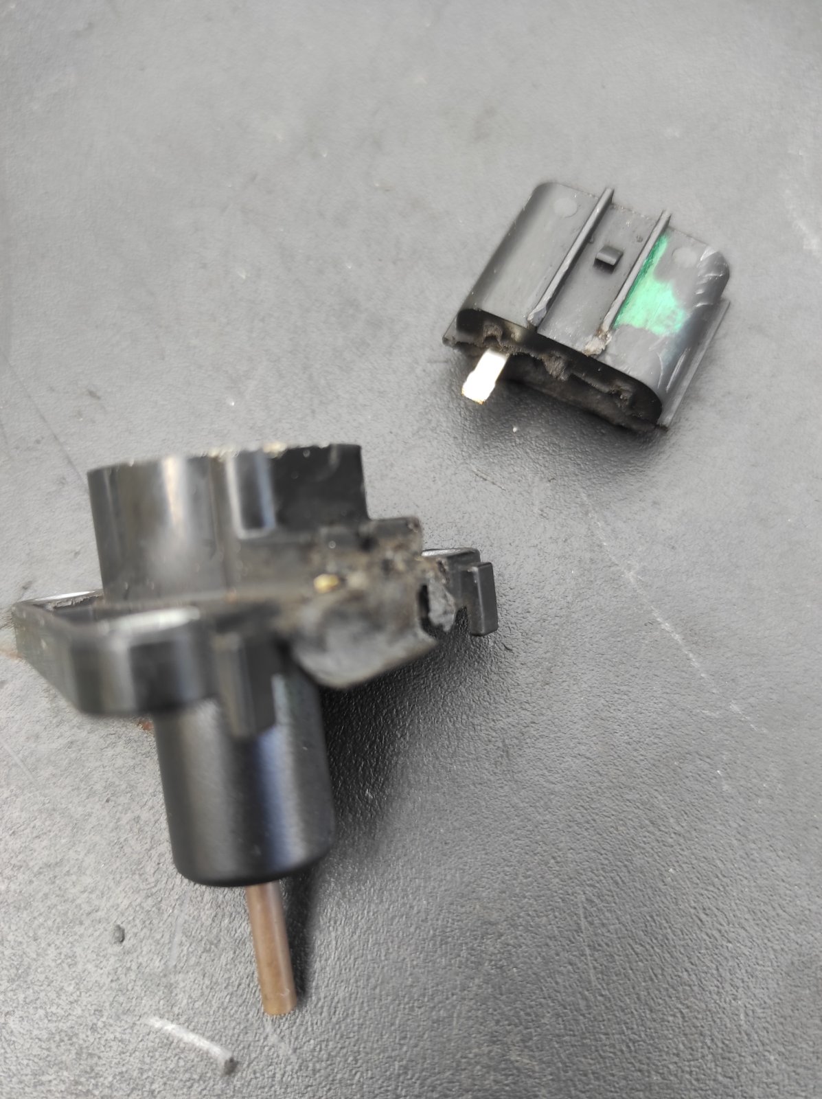

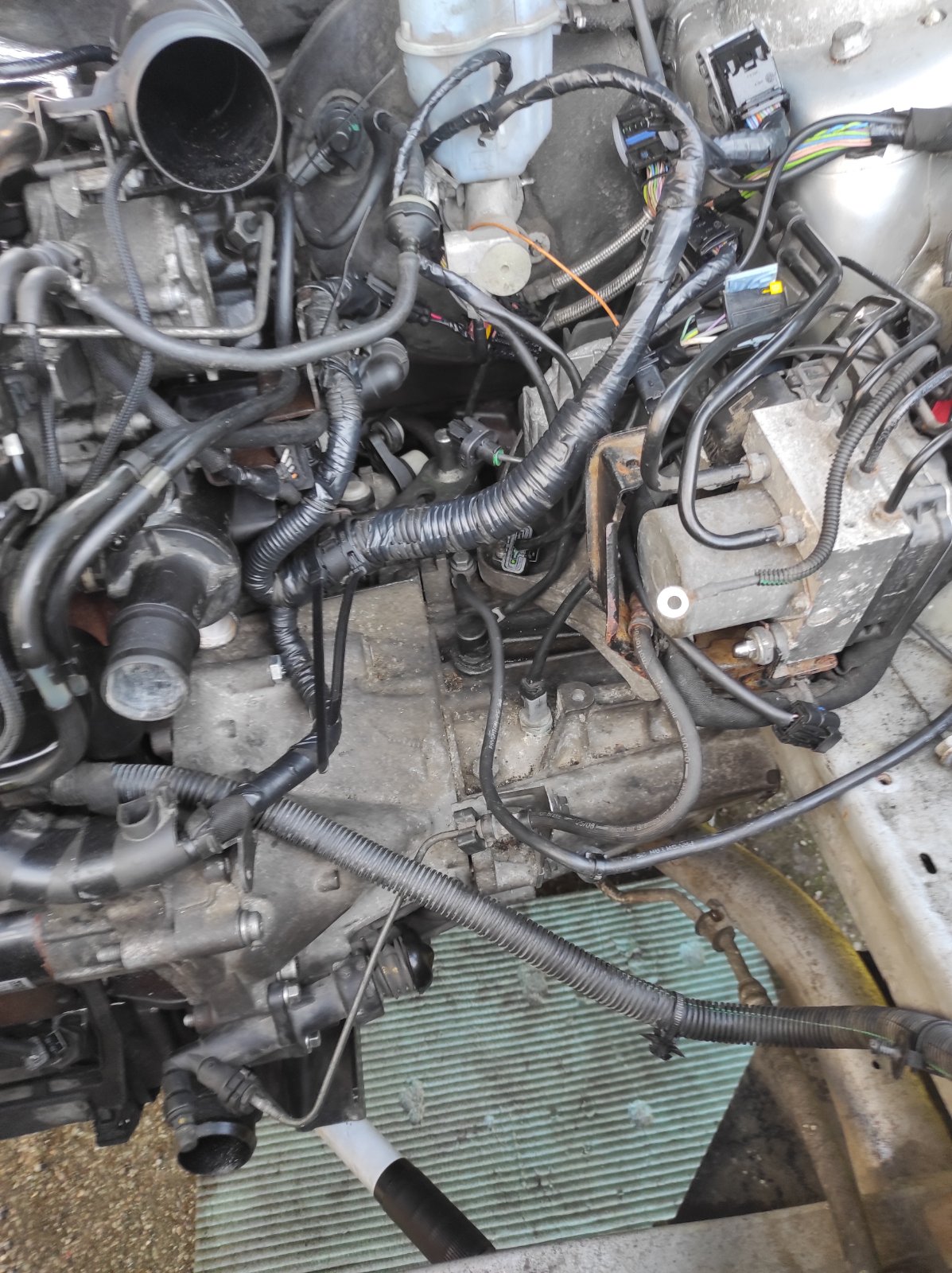

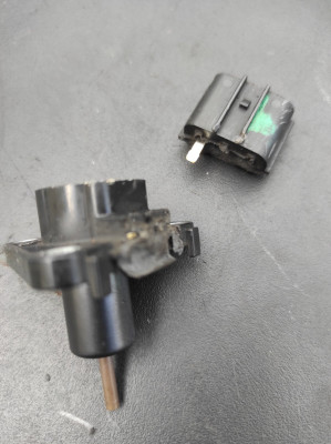

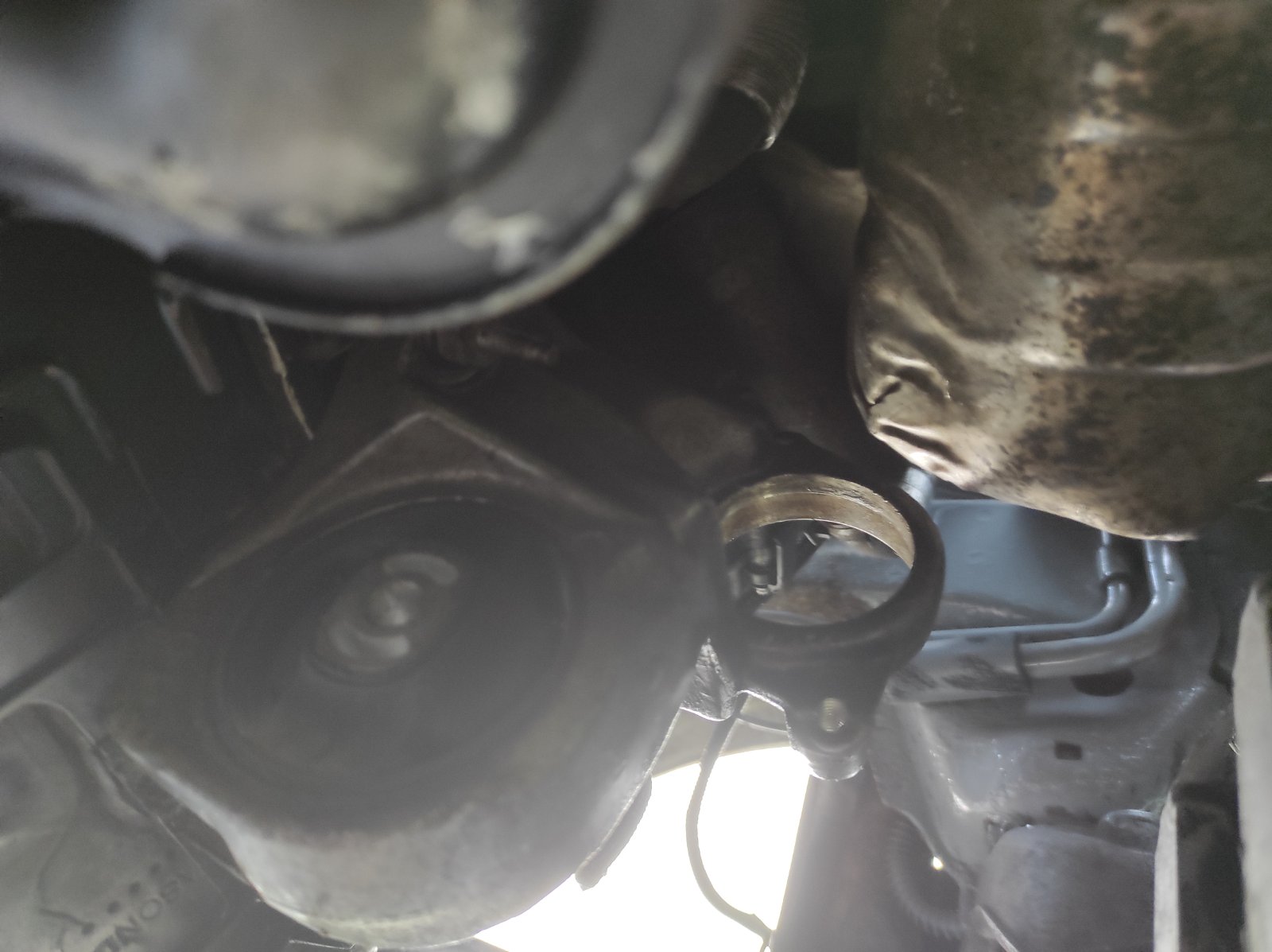

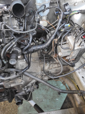

Hi lads, I put the engine and gearbox back in this afternoon, unfortunately I broke the turbo actuator position sensor in the process as you can see in the picture below. I also damaged the condenser, there's not much room using a crane to drop it in .
It had happened before I could react.
I did get it in though so happy about that
. Plenty to do while I wait but I will wait to put drive shafts and exhaust back in. Clutch operation seems smooth but can't check until I have linkage reconnected.

I ordered a new sensor €60 including postage so not terrible. I have the ECU in and gear linkage and reverse hooked up I do need to screw a few bits down but I also need to wait on Aircon bits to come aswell.getting close now lads

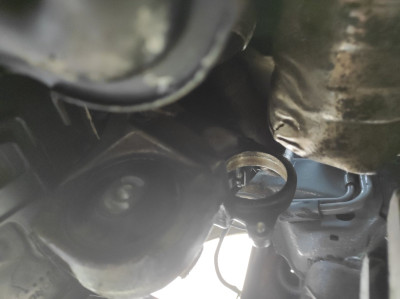

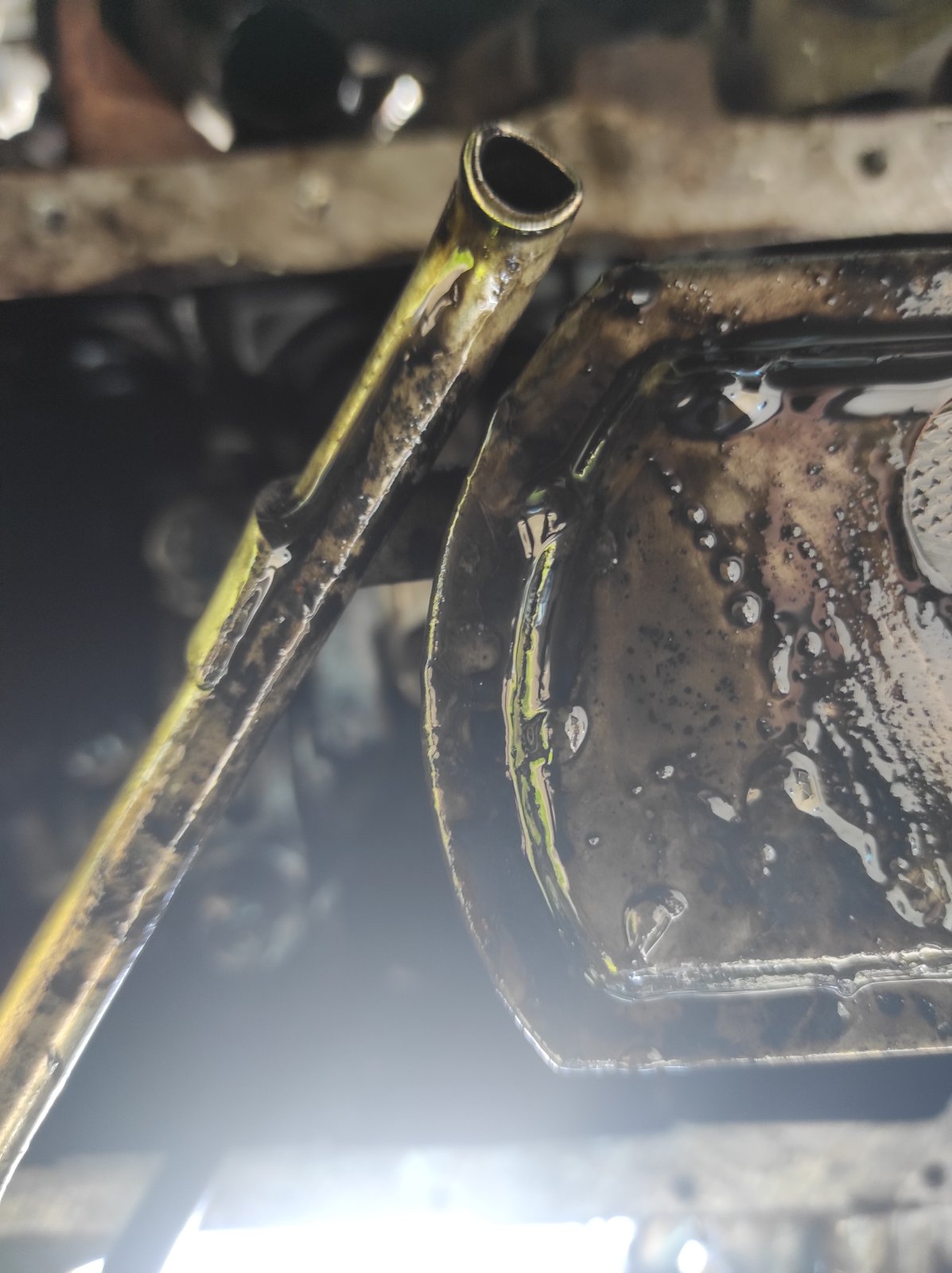

Well took it off very clean looking under there but discovered a split in the sump though that I hadn't seen before so yet another part to replace. Just keeps giving. Any the cylinders are fine no rust so just have to wait for parts now.

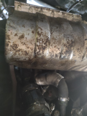

Re: Injectors misbehaving but trying to understand the numbers

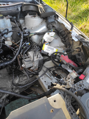

I noticed my left hand head lamp is a bit loose so pulled the front bumper forward. I discovered the two tabs behind the bumper are broken, I am just wondering what is the purpose of the helical part of the tab closest to the radiator.

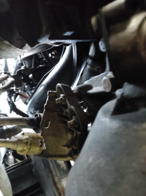

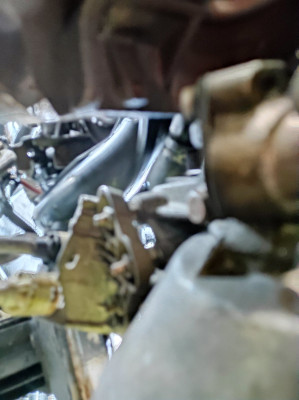

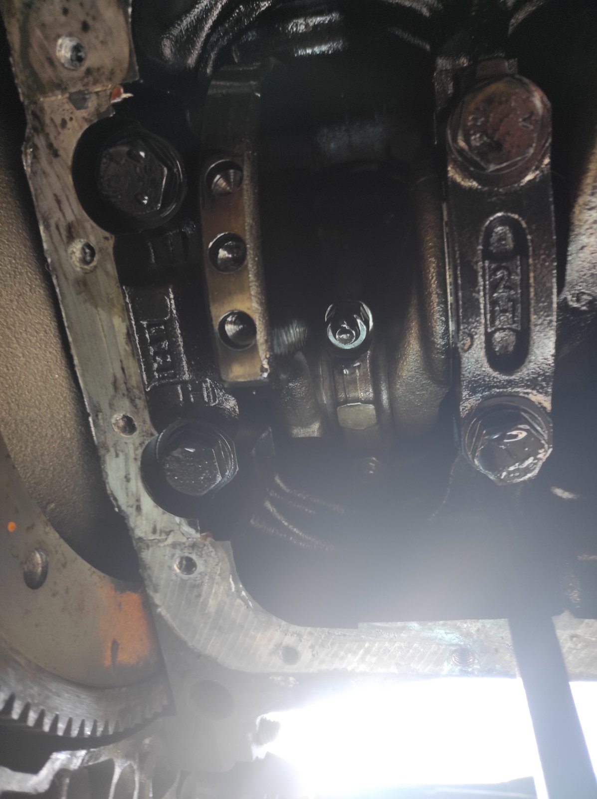

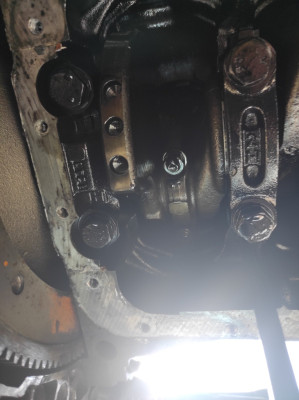

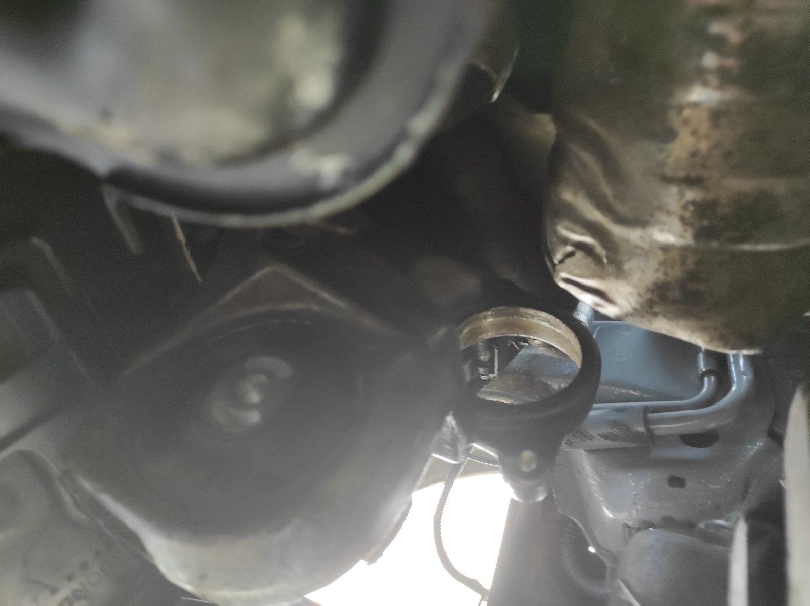

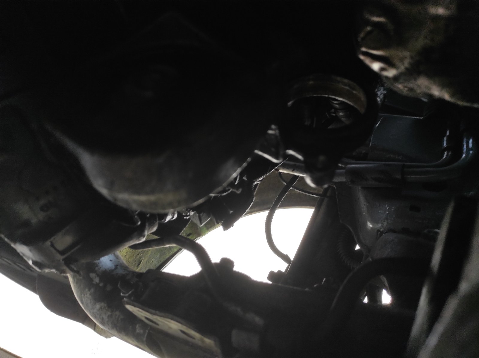

I forgot to add these photos of the bottom end of the engine. I know they're not great but it's not great under there for photography
