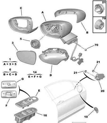

Re: Does anyone run a C5 X7 diesel estate?
I can't find any details for how to remove the mirror, but here's a generic illustration of what's in there. I think 'Nut 70' is accessed from inside once you've removed the door trim.
Oh dear, didn't know it was that complicated Marc. The 406 mirror you can remove from outside. Perhaps deleting the folding mirrors would be the easiest answer. First vehicle I have had with folding mirrors, so I don't think I will miss them. Thanks anyway.
