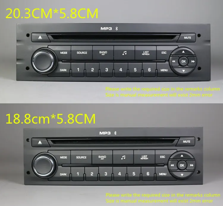

The saga continues....
https://www.aliexpress.com/item/Genuine ... b06c31b78e
I ordered the 18.8cm radio.
Interestingly it has a third Fakra connector on the rear:
Could this be for DAB?
