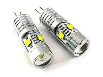

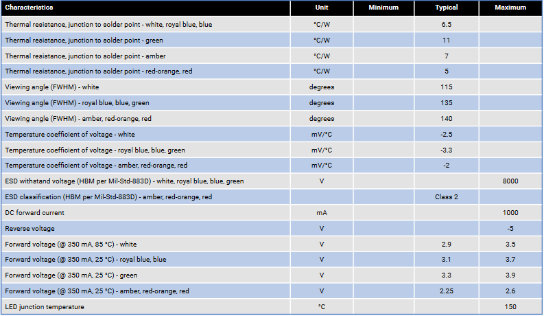

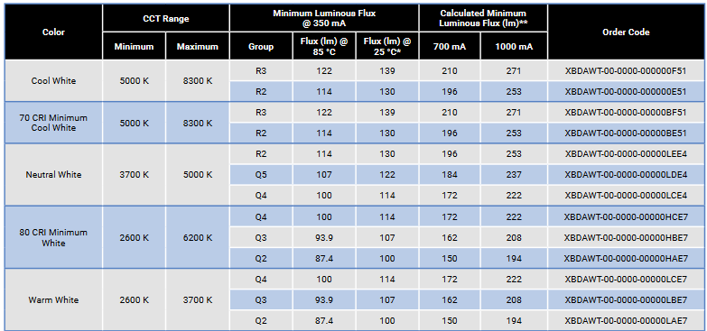

Here are the specs direct from CREE themselves. So this obviously applies to a single LED. The bulb I am getting below contains 5 of these individual LEDs. Click to zoom the tables so you can read them.

So using this info, and the original PH19W filament bulb being 19 Watt - so we assume that is the power that will be supplied to the LED.

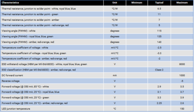

So just to get back to the resistance issue, the data sheet indicates:
  • The forward voltage for the white LED (which this is), as being 2.9 Typical and 3.5V Max
  • The car battery Voltage at 12V
  • The DC Forward Current (mA) as 1000
(a) So V(supply) - V(Drop) / I (Current) shows the resistance to be 8.5 Ohms

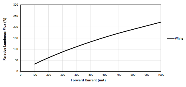

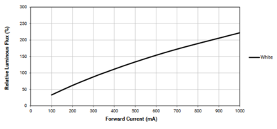

So according to the data sheet the MAX Forward Current for the LED is 1000 mA, which indicates this would achieve the maximum brightness. On the second Diagram, the 'Cool White' Flux characteristics chart (looking at the top row) say calculated minimum lumens at 700 mA are 210lm and 271 lm at 1000 mA.
So would I be right in saying that if I increased the Ohms (resistance) that I would be reducing the power going through the LED and consequently reducing the lumens? I.e. if I put in an 11 Ohm resistor, this would reduce the current to 750 mA and this would reduce the brightness - as per the following chart?
