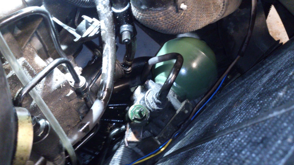

I also got an LHM leak :-D
The rubber return pipe from the top of the front hydractive firmness regulator joins the main return from the pressure regulator in a T. This had split and was oozing out. It steadily got worse until it was now syphoning LHM out from the tank.
A rubber hose right behind the radiator for 23 years that's so much lower than the tank is trouble!
