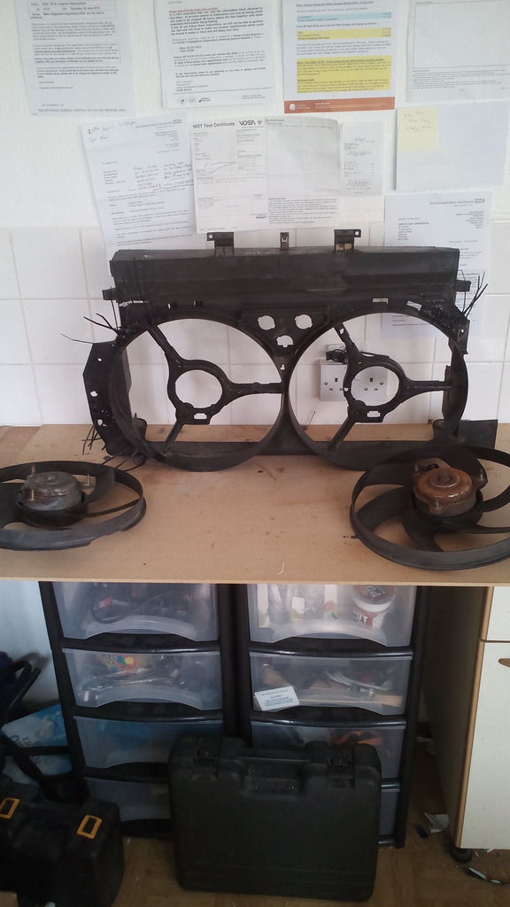

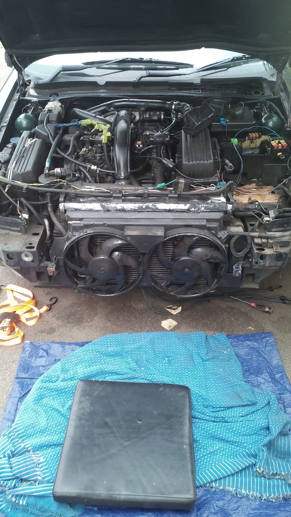

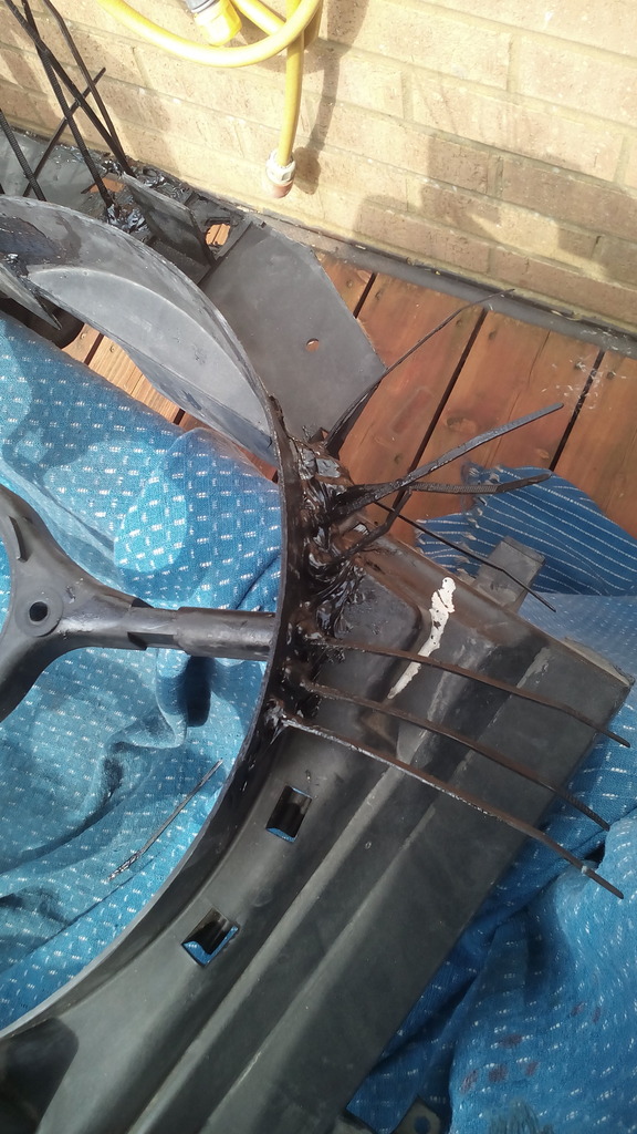

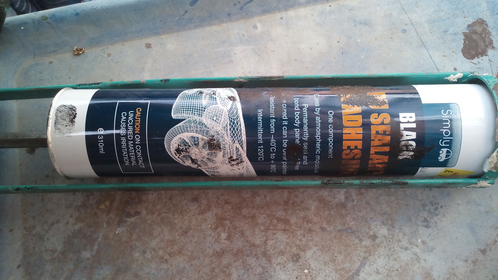

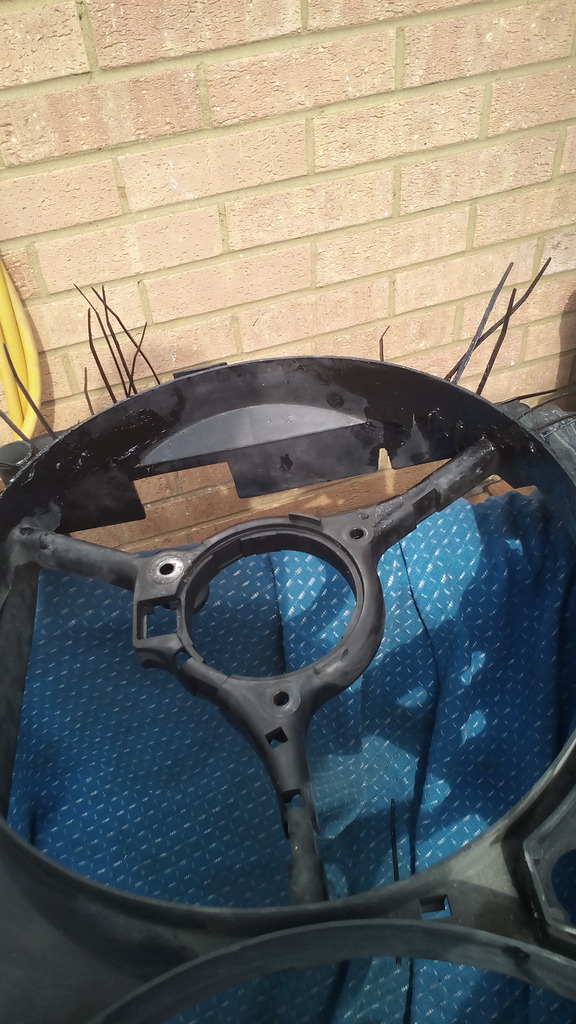

Finally I squeezed the time to get My Xantia back on the road,
it wasn't easy but with some body panel glue I managed to
drill holes either side of the cracks/fractures in the dual fan casing
and stich it back together with zip ties which have been left in place.
heres some pics below. I used a slow curing epoxy similar to fibre glass, it is slightly flexible,
to stick a strip of fibreglass around the circumference of the Fans to stick them together
hopegully preventing them from coming apart, one is slightly off balance but nothing to write home about
at this stage. it certainly beats £699.00 for a whole new fan casing and condenser radiator with fans and motors.
A special Thank you to Jim who in troubling/stressful times helped me with some parts.
Thanks everyone for the advice shared on this thread.
regards.
Nigel.. ps if the front bumper looks grey that's because I ran out of paint but I decided it was probably best painted on the car.
