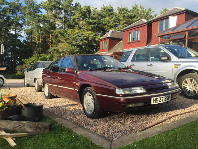

PS John, isnt it GREAT when a car arrives on a trailer and goes away under its own steam! Wish I had the place to do it in evenings though, but living 40 miles away from where I have my stuff puts a big delay on things...
I had a simmilar thing, I recived an XM V6 24v Manual minus an engine and box... and initially after a time scale of 6 months it ended up two years, but it drive away from my yard!
Engine going in, after removal from donar car..
To arriving at the owners house..
Had I not got a job when I started the project it would of been done a lot quicker....
