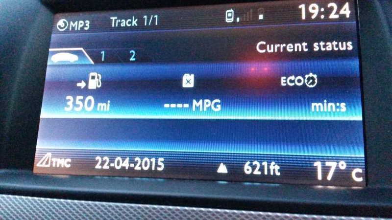

The new head unit finally arrived (it's a long way by road), disconnected battery, plugged it in, reconnected battery, fired it up and success.
Just one thing threw me, I seem to have a new mode.
Didn't have this before and in the few minutes I had to play with it I couldn't get to the other two tabs.
Not a problem though, new features are always good.

The trip details page can be activated on the RNEG, I never did it on mine ... good to see you're back with picture and sound once again in the car

Where can it be activated? Is it in the bsi section or the rneg section do you know please?

That should be in the nav unit (whichever it is) details, has nothing to do with the BSI actually

Any idea what the option is called at all?

Shoot me, can't remember ... it's been a long time since I had the RNEG at my disposal ... I'll try to find it on some of the other forums I frequented
