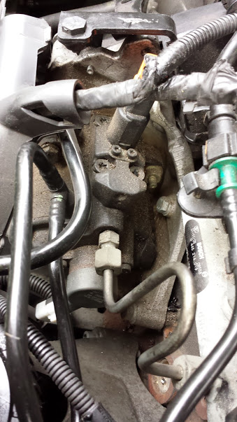

It's Bosch if it's got a lift pump - the filter doesn't seem to tie up with the injection system fitted! Post up the last 8 digits of the VIN, and service.citroen will confirm.

I think the word Bosch written on the fuel rail may give a clue lol

Yea bosch pump alright john.
Needs to come from another 8v 2.0 family engine either xantia or 406... 90 or 110bhp too.
