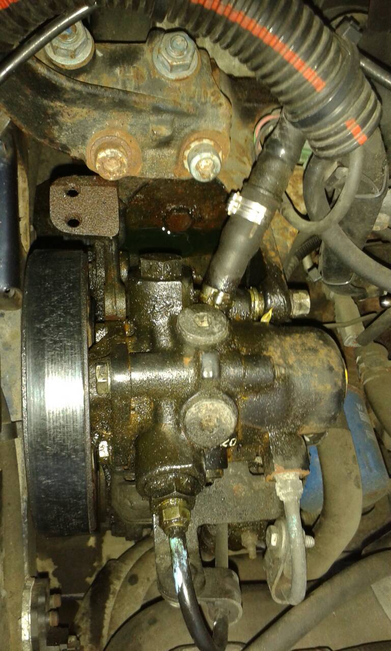

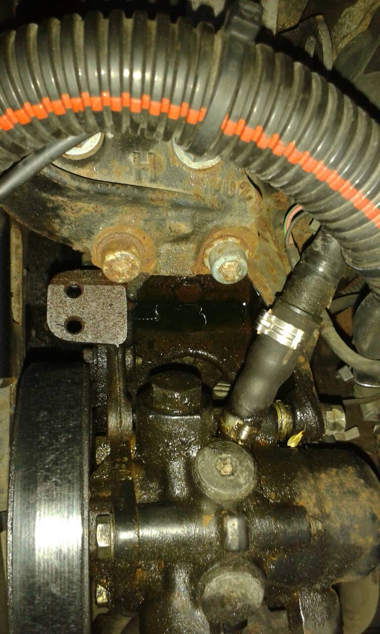

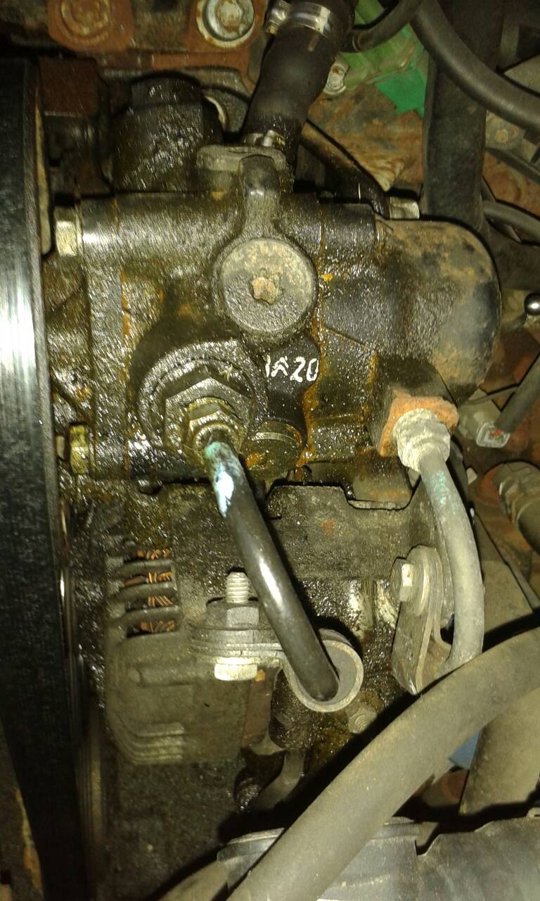

These are the pictures of the hydraulic pump.ImageImageImage
Any suggestions gratefully appreciated.

Posts: 11821
Joined: 28 Mar 2013, 21:05
x 1999
Re: Death of another Activa now double trouble
Unread post by Stickyfinger »
Yep.....sort the leak before it stuffs your Alternator as well, which it will very soon.
Others better qualified on pumps will tell you how.
Posts: 55032
x 8365
And alternators on a TCT are not the easiest in the world to swap...
Firstly, give the pump a really good clean and then it'll be easier to see from where it is leaking..
Deanxm
Posts: 3327
Joined: 18 Dec 2008, 17:57
x 87
Unread post by Deanxm »
yep, de-grease it and get it gleaming like a pin, you will never see where its coming from with all that crud everywhere, air flow in the engine bay can make the leak look like its coming from anywhere.
