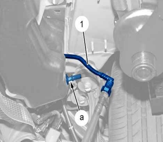

The tank is located under the rear left hand side as in this photo
Remove the protector under the body .
Uncouple the pipe (1) (at "a").
You will need to gravity fill the reservoir from the filler kit and then you must reset the additive counter using a Lexia diagnostic tool with Diagbox. This is so the computer knows the tank has been refilled as it is an estimate and calculated figure, not a measured figure. The warning will not go without doing this and will go into limp mode before long.

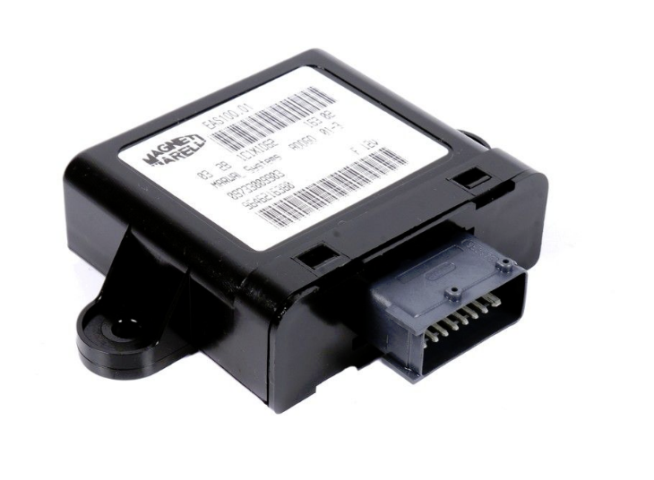

It's not that the additive hasn't been filled and the counter reset - it's that this particular ECU is well known to dealers in that it will very often not reset - resulting in the additive level low warning. That is why a lot of dealers changed this module as the same time the additive was refilled.

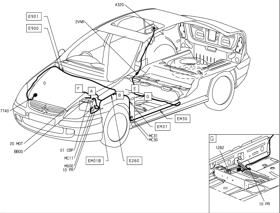

They are located in different locations, and I'm not 100% sure where it is located - the picture below shows the Additive ECU (1282) in Diagram 'G' and where 'G' is located on the car in the larger diagram - so hard to see if this is in the passenger floor well somewhere or not!. It is part number 1525AZ - but again to be 100% sure I need you VIN for this MK I 2.2 C5. The picture is for recognition purposes only - there are several types.
Important: Prior to replacing the Additive ECU with another one, it is important to note the existing values of:
- Quantity of additive deposited in the pollutant particle filter
- Quantity of additive deposited in the particle filter since the last filling
- Type of Additive Fluid (DPX42 or Eolys 176)
You will need access to Lexia ideally in order to configure the new ECU - or if you don't have the old values, then default limits need to be programmed in according to mileage (I have these if needed)
Additive ECU
Location (suppposedly) of the Additive ECU (1282)

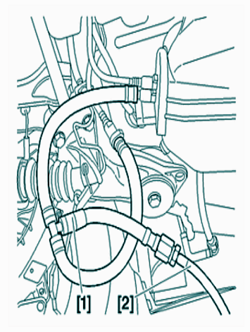

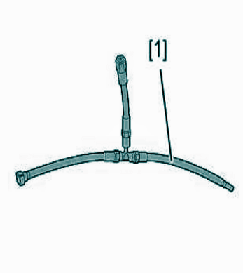

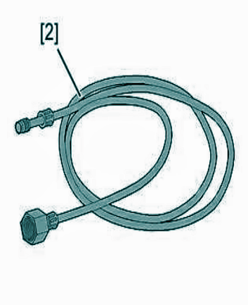

Good luck and make sure that they are sure - as if it is the ECU you will have replaced the additive pump for nought. The only way to test the pump for correct pressure is to use this test
[ 1] union for venting fuel pressure 4215-T (diameter 10 mm).[ 2] Pressure take-off extension 4251-T.[ 3] Pressure gauge for controlling the pressure 4073-T.A (kit 4073-T).
Place the vehicle on a 4-post lift.
Remove the heat shield located under the diesel additive reservoir.

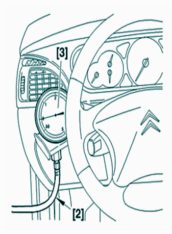

Fit the tool [ 1] as an adaptor in the additive pump pressure circuit.
Connect the tool [ 2]to the tool [1].

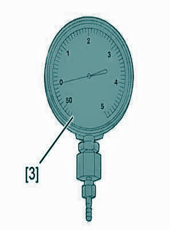

Place the pressure gauge [ 3] inside the vehicle.
Connect the tool [ 2]to the tool [3].
CAUTION: As soon as the ignition is switched on, the additive pump is supplied for 5 seconds.
Switch on the ignition , Check the pressure indicated by the pressure gauge [3].
The correct pressure should be 3 ± 0,5 bar.
Remove tools [ 1], [2] and [3].
