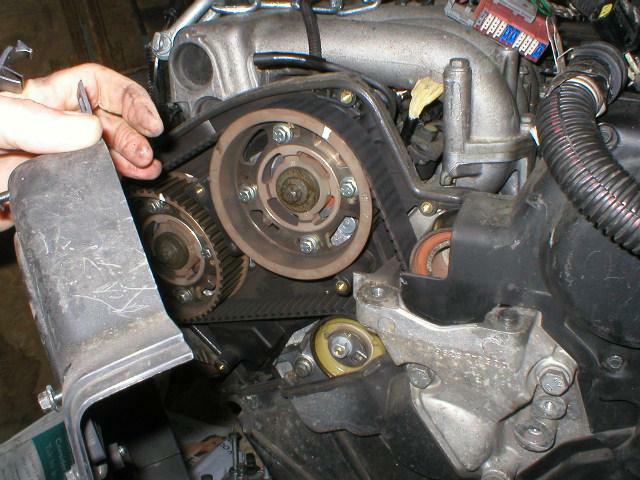

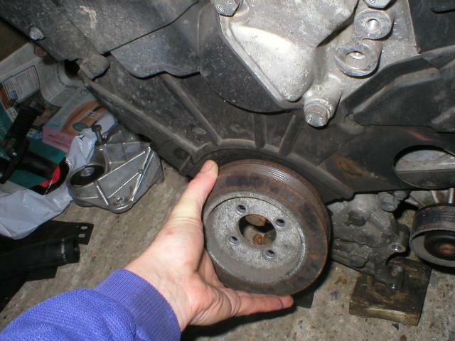

This comes off easily :D Next, the crank pulley. It's not one of those suilly dual-mass things and is attached with four studs to a boss so no need to undo the crank centre bolt :D
The cambelt covers are held on with small captive bolts and they all slip off very easily, unlike say, a 1.9TD :D
In a trice, they're all off!

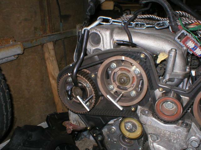

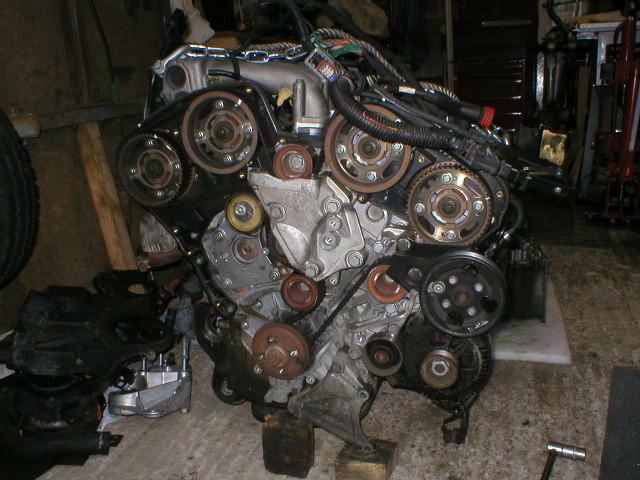

The crank is then locked with a pin...
And then the cams are locked after loosening the four studs in each cam sprocket. The special tool is used to move the cams slightly to allow the locking pins to slip in.

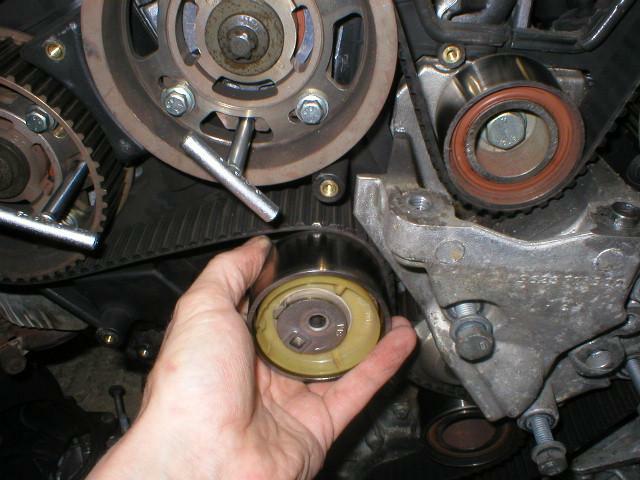

Then it's off with the eccentric tensioner..
And then the belt can be removed.

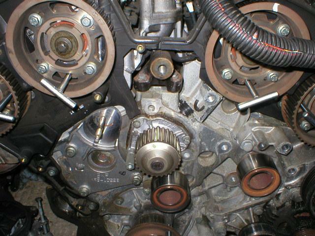

Before the water pump is exposed, the engine mount must come off and before this can come off, the jockey wheel between the cam sprockets (effectivly in the valley of the vee) must be removed.
Finding the tensioners all in good condition means I've saved a few bob in not having to replace them :D I just hope I don't live to regret not replacing them now...
I've used the Citroen special tools to lock the crank and cams but these are by no means essential.

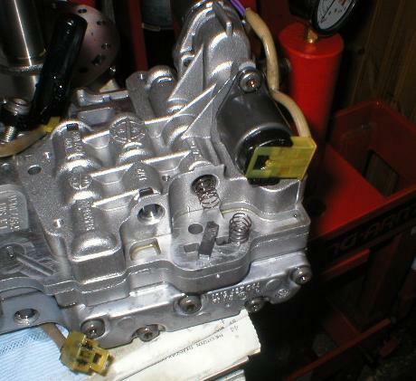

Xac came to visit this evening and in looking at the gearbox valve block, he spotted a spring hanging out of the block.
On further investigation we found that the spring that preloads valve SIV was broken and the spring stop "T" piece broken in half :shock: The remains of the "T" piece exhibited a lot of fretting marks.
The picture shows the broken spring and "T" piece.. There are marks on the end of the SIV pistion that suggests it had spent time hitting the "T" piece hard, thus eventually breaking it.
Valve SIV is only active in 3rd gear emergency mode. It operates Clutch B, the one that burned out.
Our train of thought on the failure is this. The spring broke and allowed valve SIV to flutter and allow Clutch B to engage when it should have been disengaged. In 4th gear, the drum of Clutch B is prevented from rotation by Brake C. If SIV fluttered and allowed Clutch B to partially engage whilst its drum was braked, it would slip, get very hot and destroy itself.
Therefore it looks like one little spring in the valve caused all this mayhem!

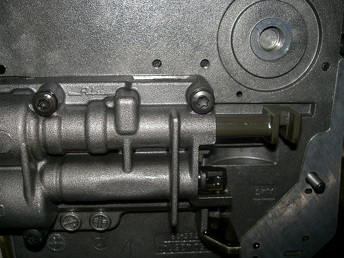

This picture shows the underside of the valveblock, the upper valve with the plastic arm is the selector and the one below that is a little more heavy duty is the kickdown/load sensor, what had happened is the return spring in the valve had snapped, so when you pushed on the throttle, in the valve would go and when you released the throttle in it would stay, the box was always shifting rough when throttling light because it thought you where pedal to the metal (or near enough) all the time, although not as dramatic as your failure it was very uncomfortable :D just glad i sorted it asap.
Glad you found it anyway Jim, wouldnt want to put that back in the car, clutch B wouldnt of lasted that long :x
