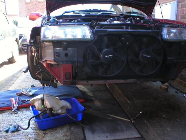

Pleased to report this week has been a good week and I'm feeling very much better now although still taking it easy...
So well in fact that this past week I've been to London and in doing so laidd a ghost. The only sensible way of travelling to London from here is by train and we often have a choice of a London Midland commuter special or if lucky a non-stop Virgin Pendolino. The Pendolino is the Activa of the train world; the high-speed tilting train. Last time I rode one I hated it and found the tilting most off-putting and actually a little scary as the line between here and London has some rather tight sweeping curves in places where the train really does tilt like a good 'un. Well, on Wednesday I rode a Pendolino again and thoroughly enjoyed it
No uneasy feelings. I'm getting better
I've also been doing some gentle spannering in the evenings this week on the Activa. I'm replacing the cambelt, waterpump and radiator. As i say, just gentle, easy stuff..
The cambelt on an Activa is delightfully easy and that was no real problem but by gosh the radiator has been a challenge. Firstly, the access is a bit on the tight side and secondly, the bottom hose bayonet was well and truly corroded into the socket on the radiator; it just would not play and come free however I tried. I tried all sorts and cogitated over it a bit. I thought I'd look at the trick you can do on a 2.1TD and remove the rad complete with the bottom hose and then deal with the problem in the workshop. On the Activa the bottom hose has a tee along it with a pipe going up to the expansion tank so that avenue is firmly closed. Removing the expansion tank to get at the bottom hose would involve a heck of a lot of work, including depressurising the aircon
Salvation arrived in the shape of Chris570
He's had past experience of this and his method was to take a hefty cold chisel to the socket and break it off the radiator. Then the remains of the socket stuck on the hose bayonet vcan be attacked with rather more access. Chris did the deed and the rad was soon out. However the ramains of the socket was still firmly on the bayonet. Much care an patience saw me cut a slot across the socket with a broken junior hacksaw blade being careful not to nick the O ring on the end of the bayonet. After 15 hours of careful cutting I could finally wedge a screwdriver in the cut slot, twist it and get the remains of the socket off the bayonet. Another 15 hours has been spent carefully cleaning up the bayonet ready for fitting the new radiator.
The old rad was weeping and it's core was well choked with debris and oily muck. It was the original and seeing how blocked it was it was no real wonder the car ran a bit warm last summer
I've given the aircon condenser and intercooler a good clean whilst I had access to them.
I've taken photos and will do a write-up on Activa cambelt and radiator replacement. The latter job is a bit of a devil on an Activa at the best of times; it is amazing what needs to be removed to give sufficient access to lift the rad in and out. Give me a V6 any day
Hopefully, tomorrow will see it all smoothly go back togetehr...

Had the same issue with the socket on Juliet, had to smash it off the old rad then fight to get the remains off.
As for space, imagine trying to squeeze in a 406 rad which is slightly larger.
I would not have been able to do it without Ian's help.

Absolutely yesrobert_e_smart wrote: The TCT is easy to change the belt on. Nice access, and one tensioner/idler.
And even then there's a a big 'gotcha' with the crank pulley timing hole. Because it's on the outer edge of the dual-mass there's no guarantee it's accurate; invariably it's not
So there you go, typical Activa, even a prima facie simple job has a big complication....

Um, I don't recall doing that with Juliet Jim, took the rad out and the new one in via the top...
