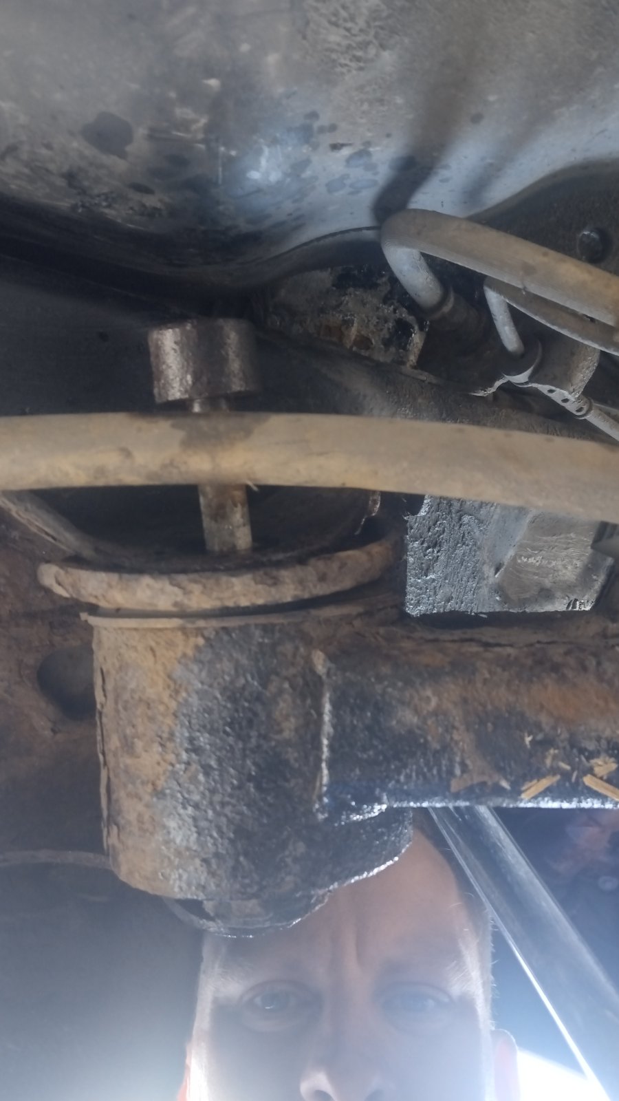

Yes the gauge of the steel is thinner on the new ones. The extra length did make installation more difficult 6 I had to loosen the front mounting bush at one side - I picked the drivers side (right) then wished I hadn't!
1 it was well seized in the bush/bracket.
Nut: off without issue. A close fitting tube, chunky punch and walloping the exposed end of the bolt, first with 4 Lb hammer then a few good goes with the sledge hammer = not a budge! Ultimately, small breaker bar on the T55 torx on the other end broke me some rotational movement. Free? Nope! More walloping but on the move at last!
2 the bloody fuel tank is in the way! There's the full width of the bush , of extra bolt length, still to go and that point!
Loosened the 4 bolts (2x 16mm, 2x 13mm head, both same thread size!) and dropped bracket away from the car. But not quite enough to clear the tank. Dropping axle limited by brake flexi hose. Tilting the wheel end of the axle upwards, raising the whole thing upwards (with the jack - it's a heavy lump!) just about got the bolt out. And it fits the other way, hurray!!
Extra clearance got the two springs in place no problem (passenger side without removing front bush bolt, enough flex to get the spring in as is.
Clearance at that side to actually get that bolt out = loads, only exhaust anywhere near! Interesting to see if that is also seized in place. Both bushes looking pretty tired, so I'll be here again soon I think.

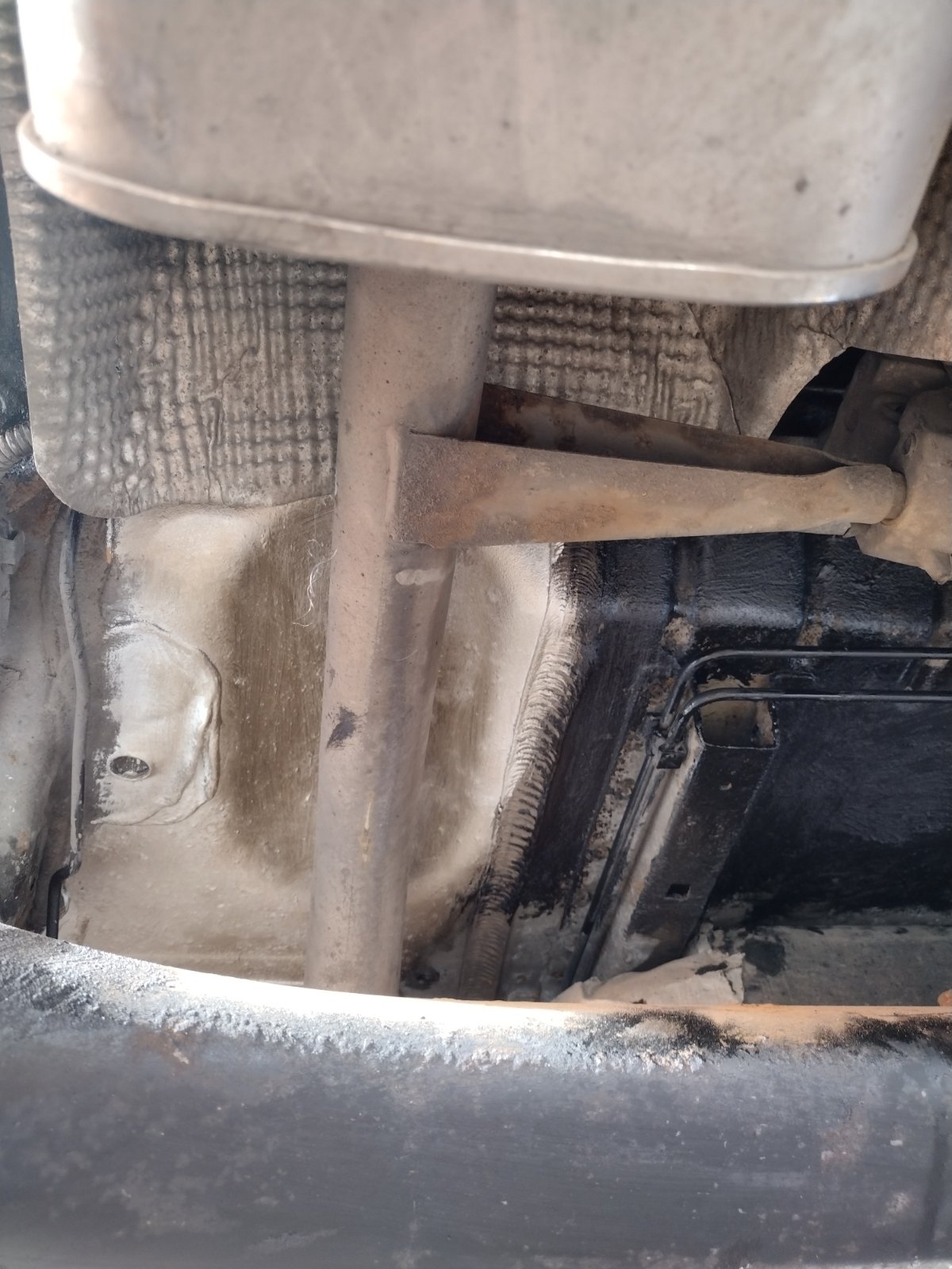

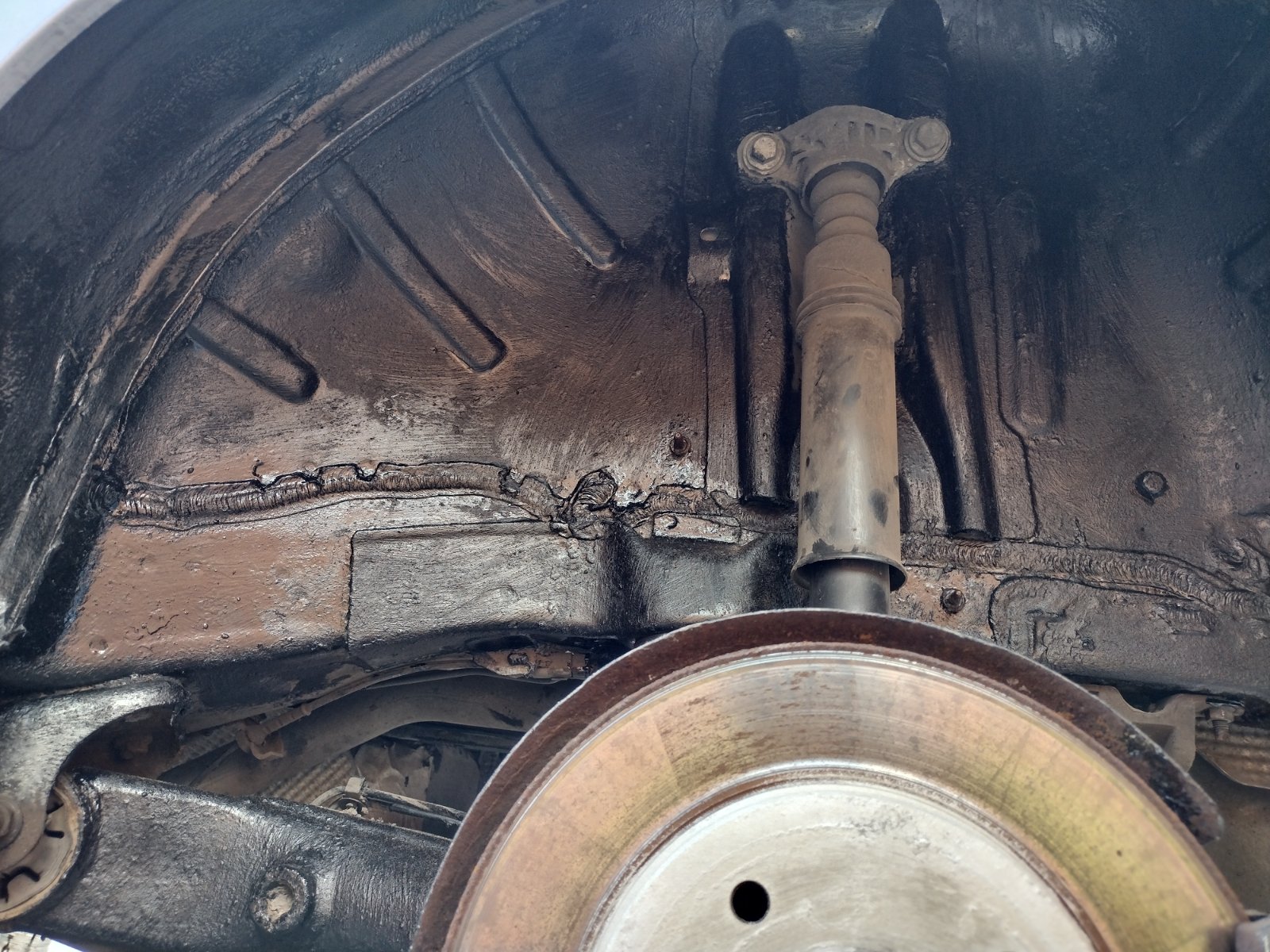

Just ahead of getting arch liner back again. Liner put back with "my signature" penny washers from numberplate plastic and standard M6 nut. Lots of copper grease on stud so hopefully it will undo next time.
You might notice a bit of silver on brake disk centre, I painted an area of the underbody with silver aluminium paint where there was a daft gap between two heat shields! Next up heat shield under rear silencer, one bolt hole had fatigue around the (large integral washer M6) fastening and a second (of the 4) wasn't far away.

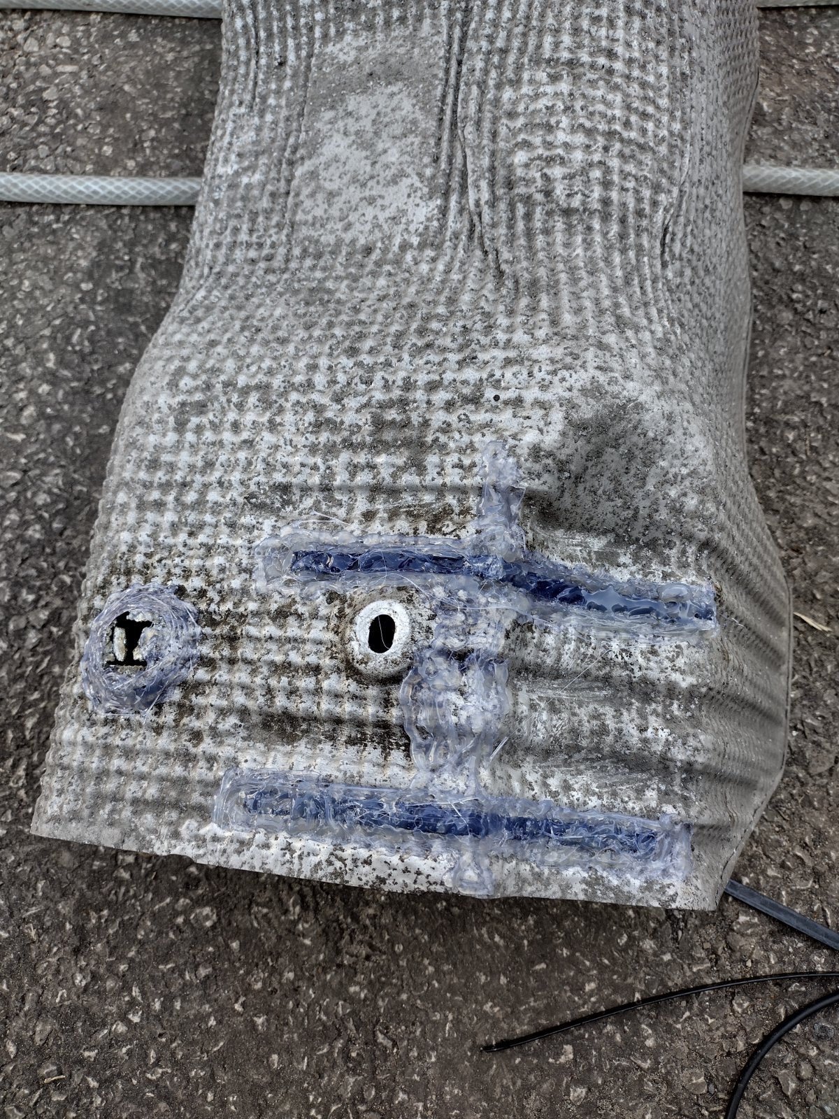

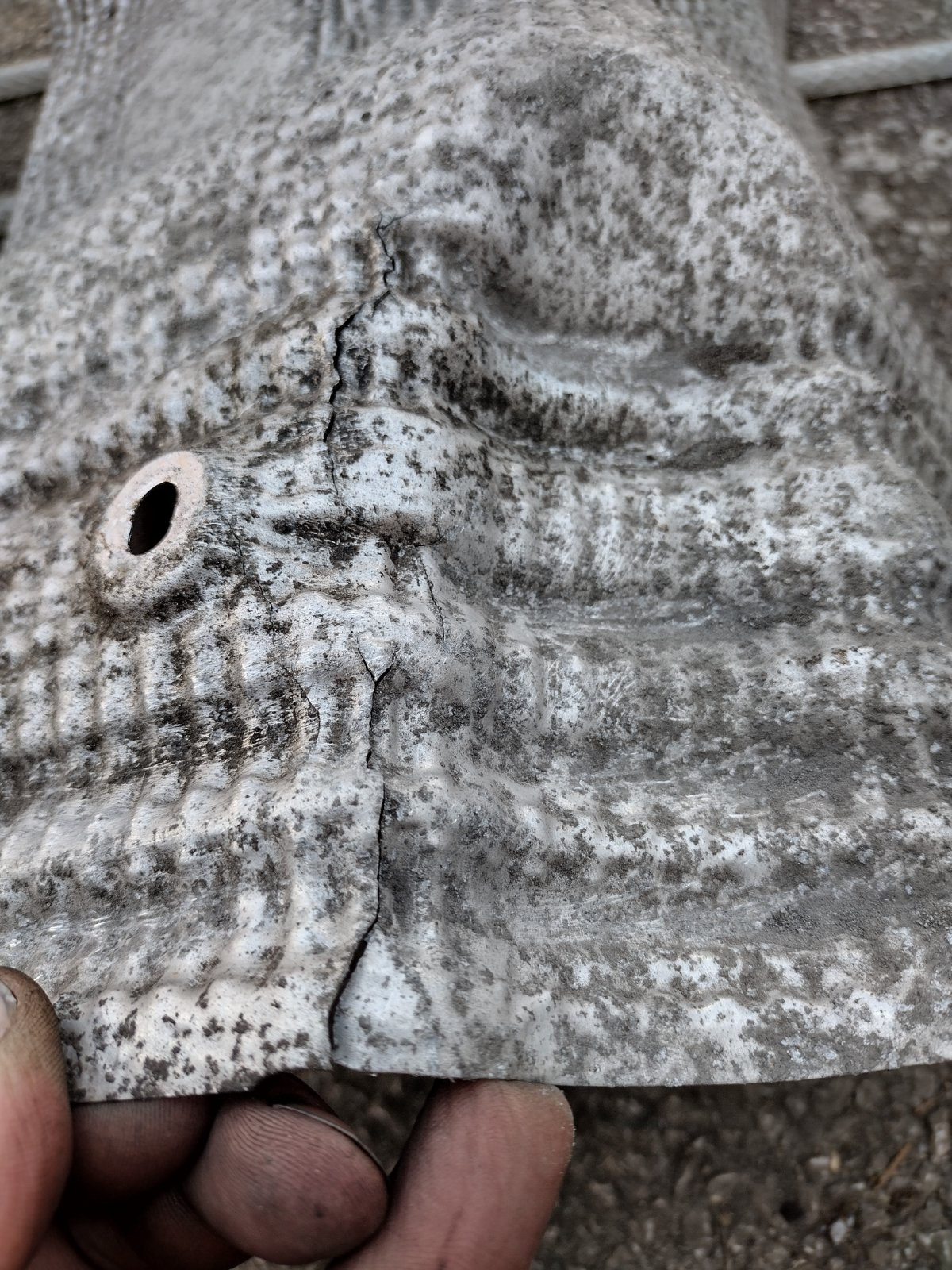

Heat shield also found to be cracked: So, in the hope I'm correct that it doesn't actually get that hot, I've used glue gun to fasten a few strips of bent thin steel (ex wiper blade I think. Certainly second hand and out of my scrap pile) like so: Might not work but will see how it goes.

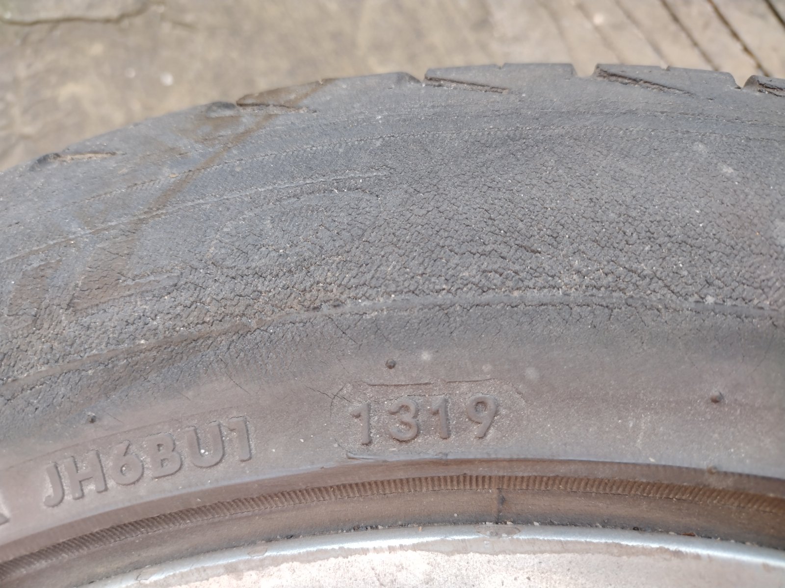

Next, spare was found to be quite perished! Strangely is the outer sidewall (which sees the sun when in use obviously, but faces upwards when stored as spare, it wasn't like that when put in place as I'd not have used it as spare in that case!) inner sidewall looks ok. Anyway, there's another matching alloy with tyre in a non-perished condition, so that is now the spare. Finally has a quick look at the towbar bodgery, I mean wiring! This has always been in the way of the wheel brace and towing eye getting stowed away correctly, so thought work a look. Not great! Blob of duct tape hides a crimp spade terminal in a single pin of a large (original) terminal. Think this is the live feed to run the show (and may explain why certain trailer functions Vs ignition switch position are a bit odd!!
Slightly tidier but will have to have another go another time (belly was rumbling!)

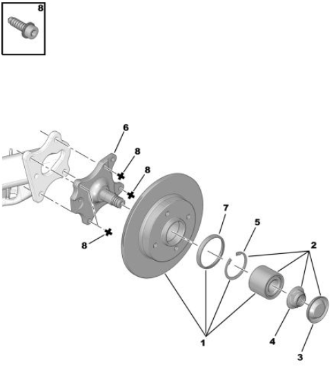

Just putting this good information here for easy reference:
And a link back to the specific post on the long thread: viewtopic.php?p=807547#p807547GiveMeABreak wrote: 29 Jul 2024, 10:58 On the first vehicle, there's no 5134G4 part number listed at all Matt. Here are the 2 diagrams referring to the rear torsion bar and hub, - but note on the Torsion bar diagram there is no item (3) listed for this vehicle. Let me know the item(s) from the relevant diagram.

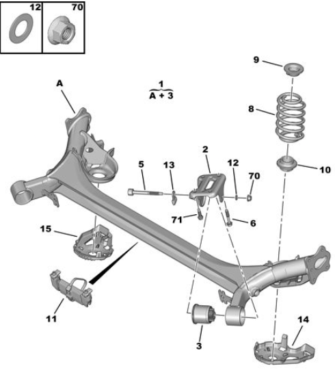

Rear Torion Bar
Rear Hub
Heat Shield
The only Heat Shields present for the exhaust system are those shown (except for a small one on the catalytic converter / DPF Assembly).

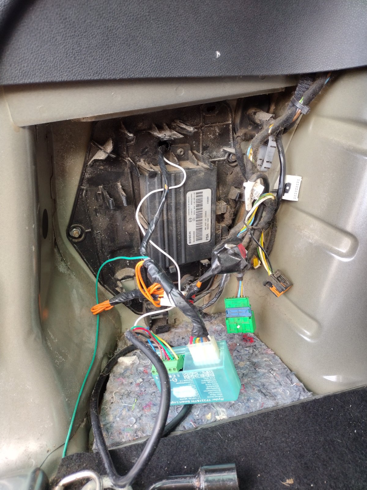

Second Vehicle

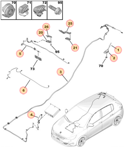

Aerial
Notes:
(5) Tailgate washer pipe includes an aerial harness in the assembly.
(20) Aerial Amp is for AM / FM1
(21) Aerial Amp is for FM2
FM2 Aerial is imprinted onto the rear screen.
If fitted with DAB, the aerial is 'J'
Towing
There is a specific Electrical Harness showing for this vehicle with your build date (others are not compatible), so: TOW BAR WIRING LOOM 13-TRACK, part: 1611864380, £209.23 should be correct.
Comes with a 13 way socket, and Generic Trailer Relay Unit
Features:This is the only toolbar listed for the vehicle with this wiring harness:
- This harness is particularly suitable for providing the lighting supply to trailers or cycle-carriers on tow bars.
- This harness has been developed to incorporate all of the vehicle special features.
- It also provides an electrical supply to the fog lights and reversing lights.
- Comes with a 13-way socket to correspond to the trailer socket.
- It incorporates all the features needed for good compatibility with this vehicle and is SAFE, RELIABLE and EASY to fit.
- In addition to deactivation of the parking aid when the vehicle is towing, this wiring loom incorporates the blown bulb detection function.
- The functionality of the harness will be obtained by configuration of the BSI (fitting by the network is imperative).

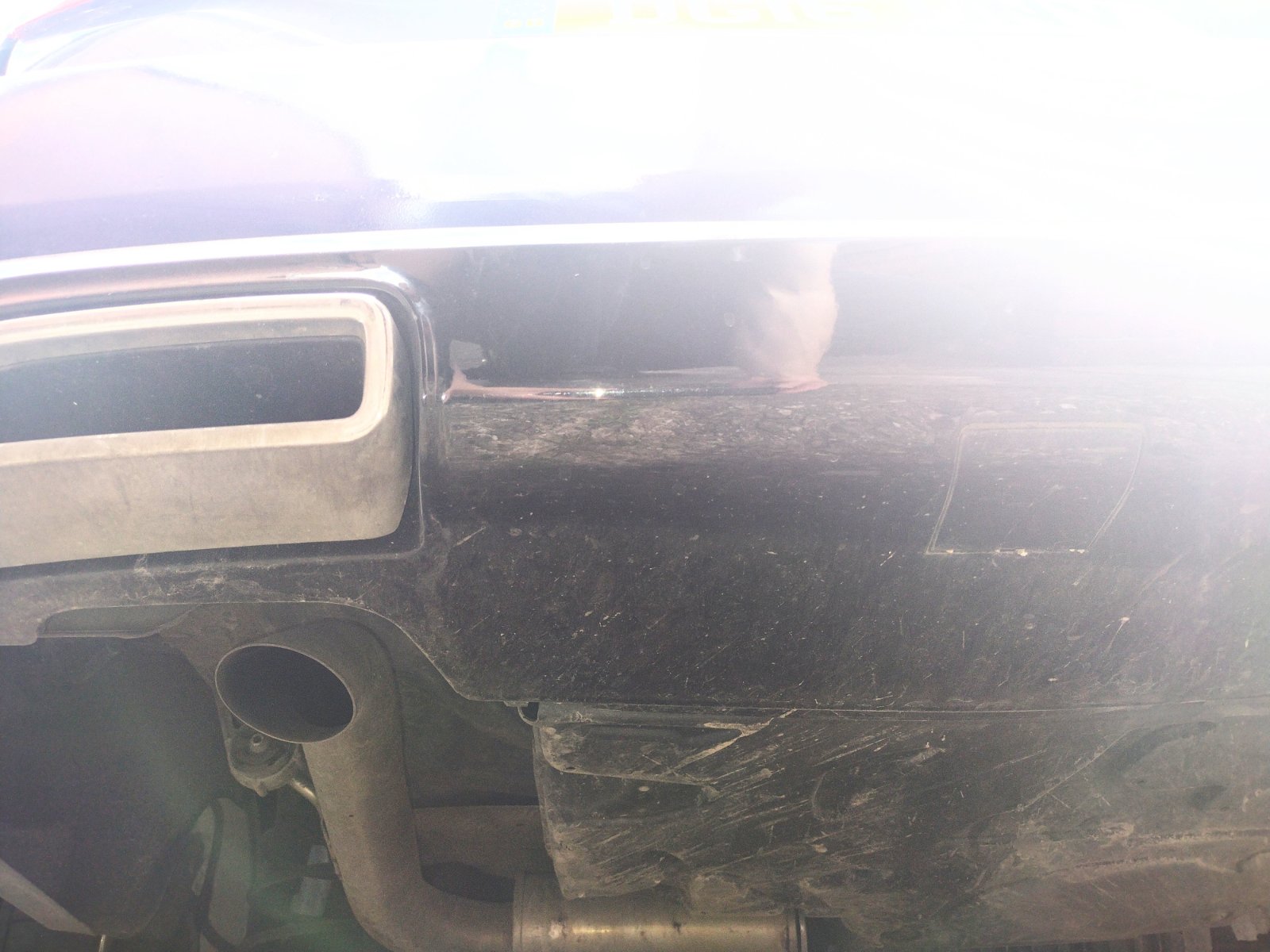

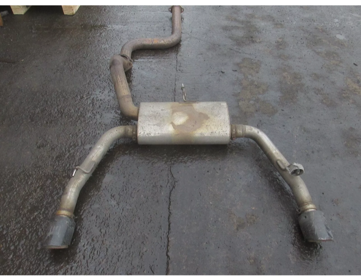

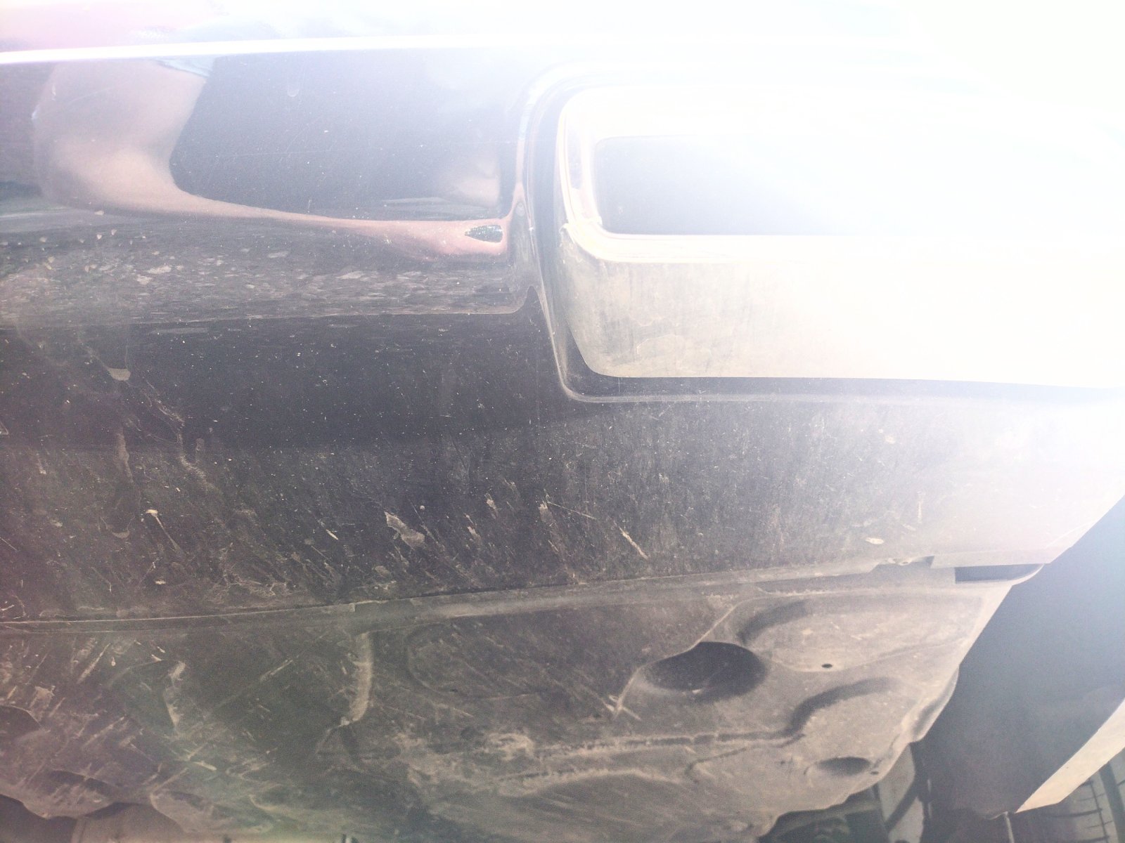

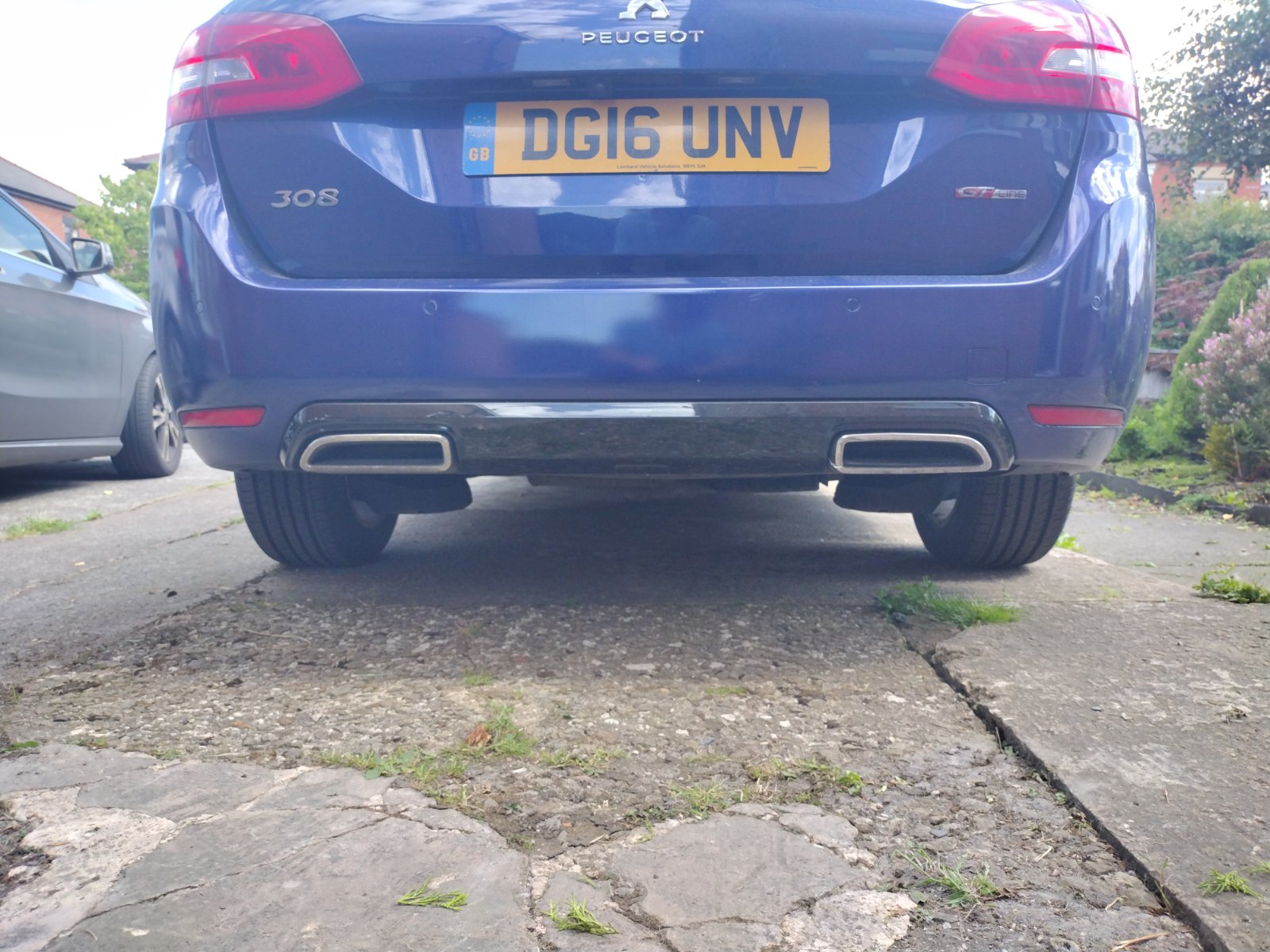

Good news on the towbar front, my heart sunk when I read this:
From the good info Marc shared it seems the aftermarket has got carried away and grouped GTi and GT-Line together.
The GTi has fancy twin tailpipes: https://www.ebay.co.uk/itm/295542088766
Which must get in the way.
The GT-Line has ....
- Spoiler: show

Sorry, terrible pictures as had to whack brightness and contrast up for the gloomy under car Vs brilliant sunshine!

Hey Matt, have you checked out or contacted powerflex for trailing arm bushes? They make poly bush replacements. Highly recommend them if you can't find anything oem

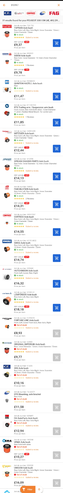

Not a bad idea at all, I did come across a russian? Site that had some possibly suitable polyurethane trailing arm bushes. This one:dylan26__ wrote: 29 Jul 2024, 17:24 Hey Matt, have you checked out or contacted powerflex for trailing arm bushes? They make poly bush replacements. Highly recommend them if you can't find anything oem
https://polypro.com.ua/en/katalog/citro ... 2006-2013/
Actually that result is off a search for 5131G4
I need to have a measure of the existing bush, if it looks like dimensions are a match then a couple of these (£11.85 each)
RTS Trailing arm / Suspension arm bush https://m.autodoc.co.uk/rts/12972471
Is probably what I'll try. This would be not Heavy Duty but I can take it easy going to the tip

Need to find the other 308 SW (the new blue one) 's OBD port as realised it will likely tell me if it's aerial is having a problem (on the basis it's pretty new, so like the C5 will have its own flipping ECU listing on DiagBox!)

The Parts Asia site (all be it treat with a dose of salt) does list this elusive bush, with another part number:
5131H7
Inner diameter 12mm (or 12.1 or 12.3)
Outer diameter most 72, a couple of stragglers state 71.2,
Then gets interesting "width 50mm" different item: "height 82.5" a couple unstated, next "width 83.5", "82.5"
The 50mm seems to be the odd one out. Not sure if 83 Vs 82 is just a typo
