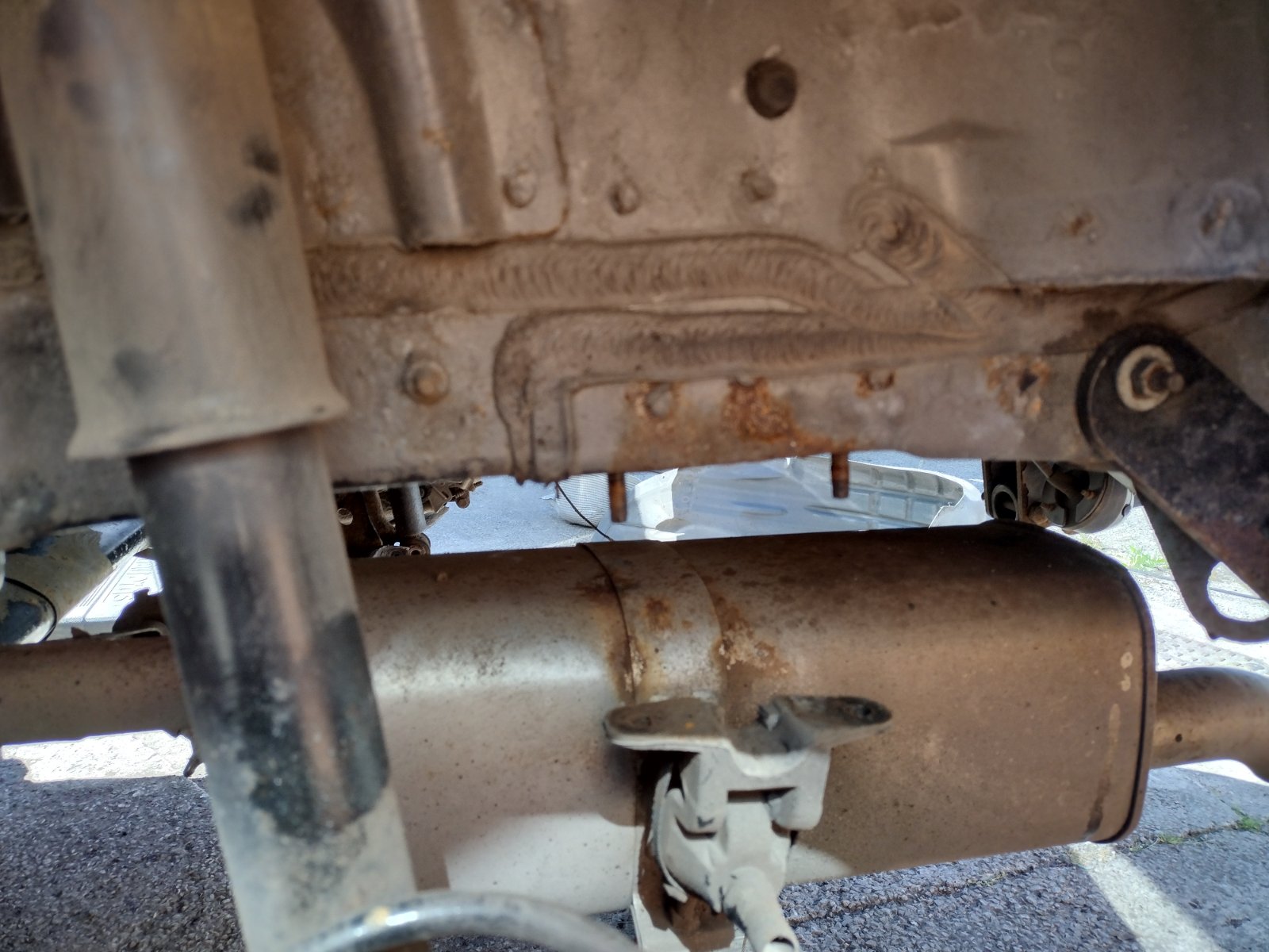

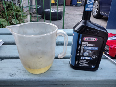

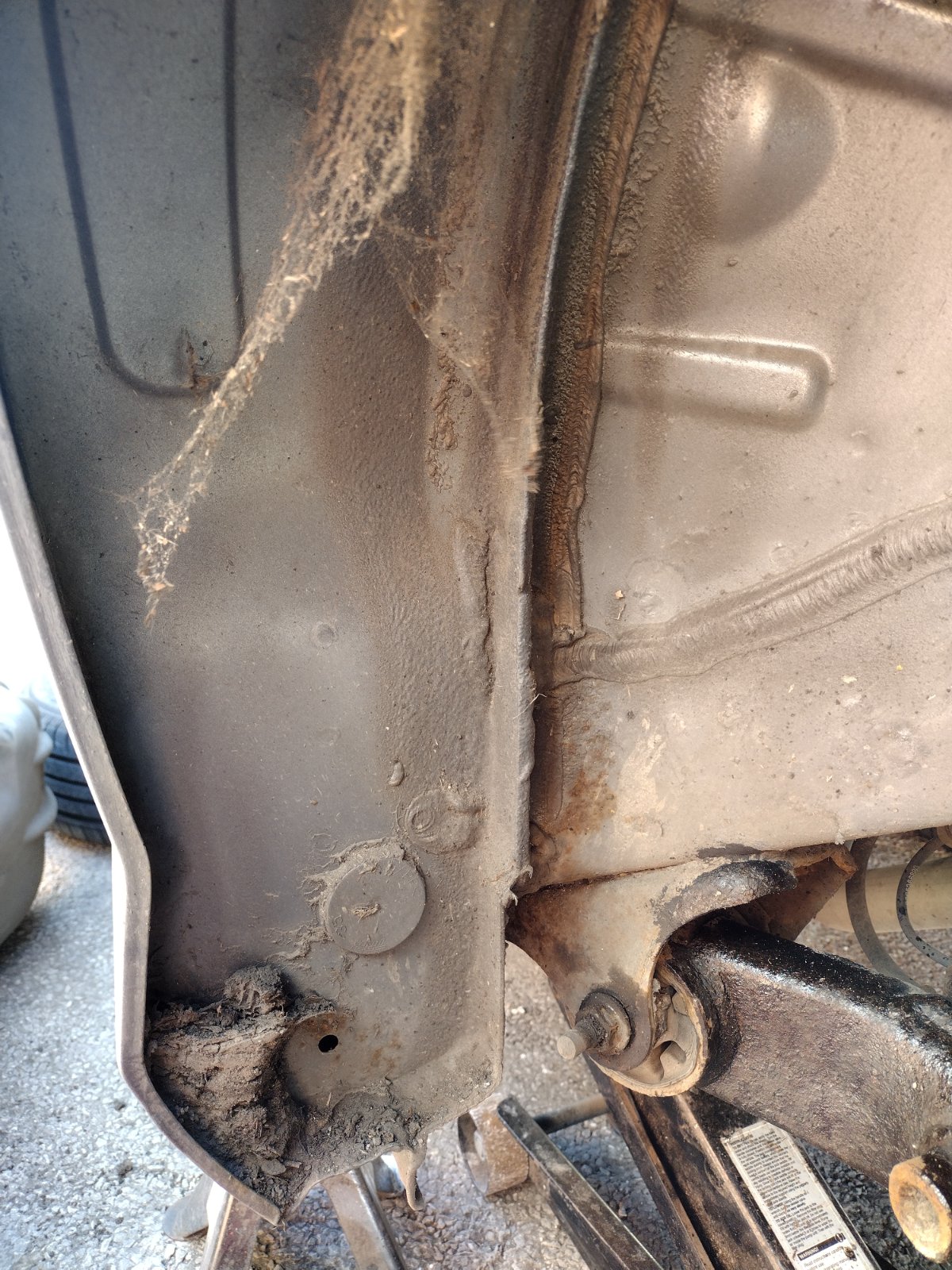

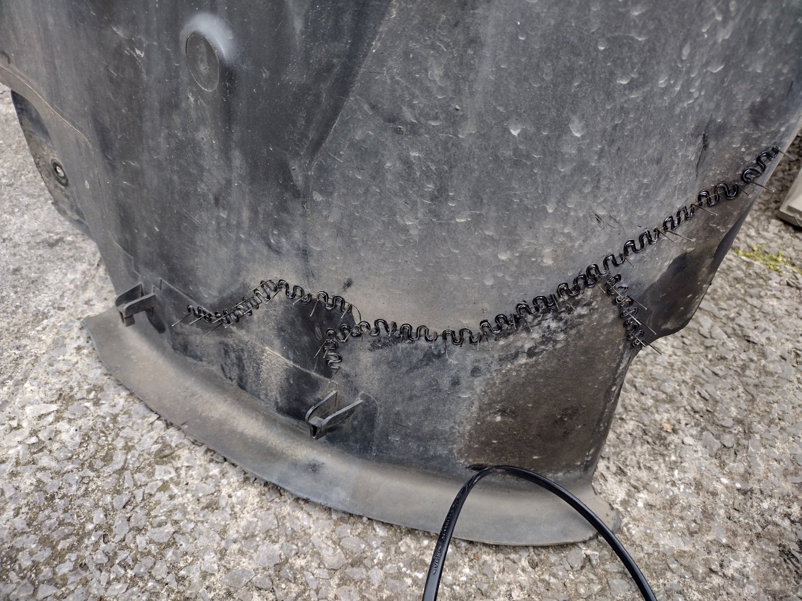

Arch liner : hot staples back together

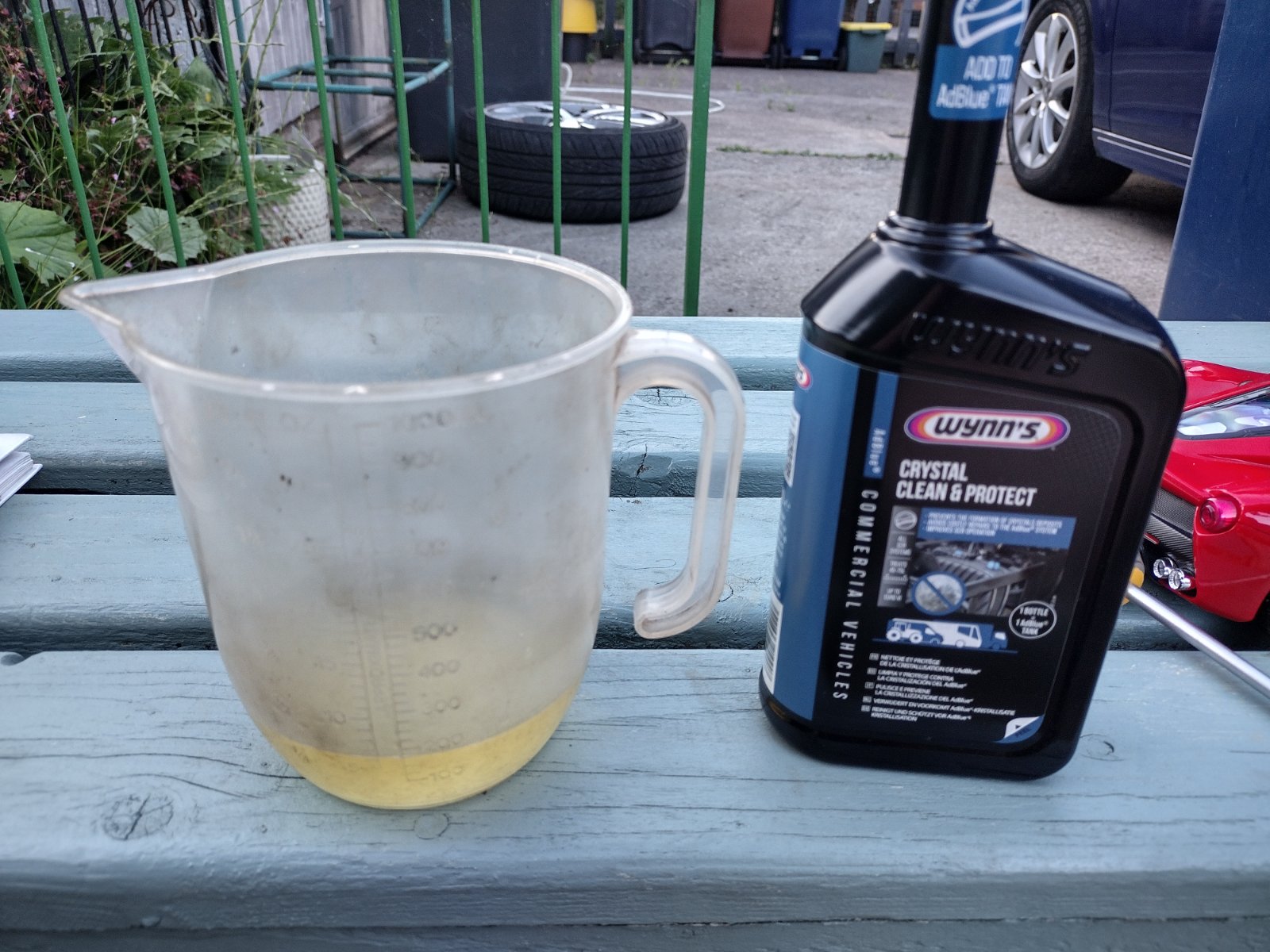

Wynn's treatment measured out

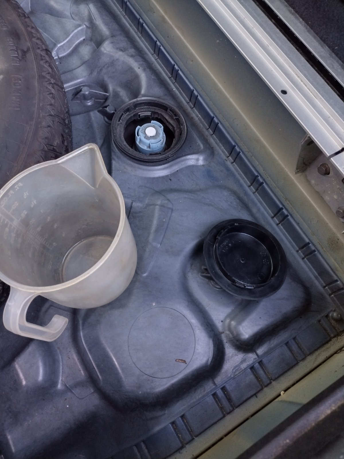

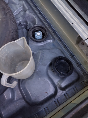

Adblue filler position:
- Posts: 55182
- x 8440
That's similar to where mine is Matt! Looks a right 'mare to top up. That long spouted jug looks ideal for the jobMattBLancs wrote: 21 Jul 2024, 07:37Not sure where your filler is Jim, but the 308 SW it's low down in the boot, next to spare wheel - boot floor and polystyrene thing.CitroJim wrote: 21 Jul 2024, 05:33 I've yet to top mine up with Adblue but looking around the filler, previous top-ups have been a bit messy! Lots of crystals in evidence...
Good to see you've gone for the anti-crystallisation additive

Yes the jug worked well, if you fill it to the 2 Litre mark though then it's starting to pour before the spout is close up against the hole!CitroJim wrote: 21 Jul 2024, 16:33That's similar to where mine is Matt! Looks a right 'mare to top up. That long spouted jug looks ideal for the jobMattBLancs wrote: 21 Jul 2024, 07:37Not sure where your filler is Jim, but the 308 SW it's low down in the boot, next to spare wheel - boot floor and polystyrene thing.CitroJim wrote: 21 Jul 2024, 05:33 I've yet to top mine up with Adblue but looking around the filler, previous top-ups have been a bit messy! Lots of crystals in evidence...
Yes talked about lots on here so got some and chucked it in!Good to see you've gone for the anti-crystallisation additive![]()

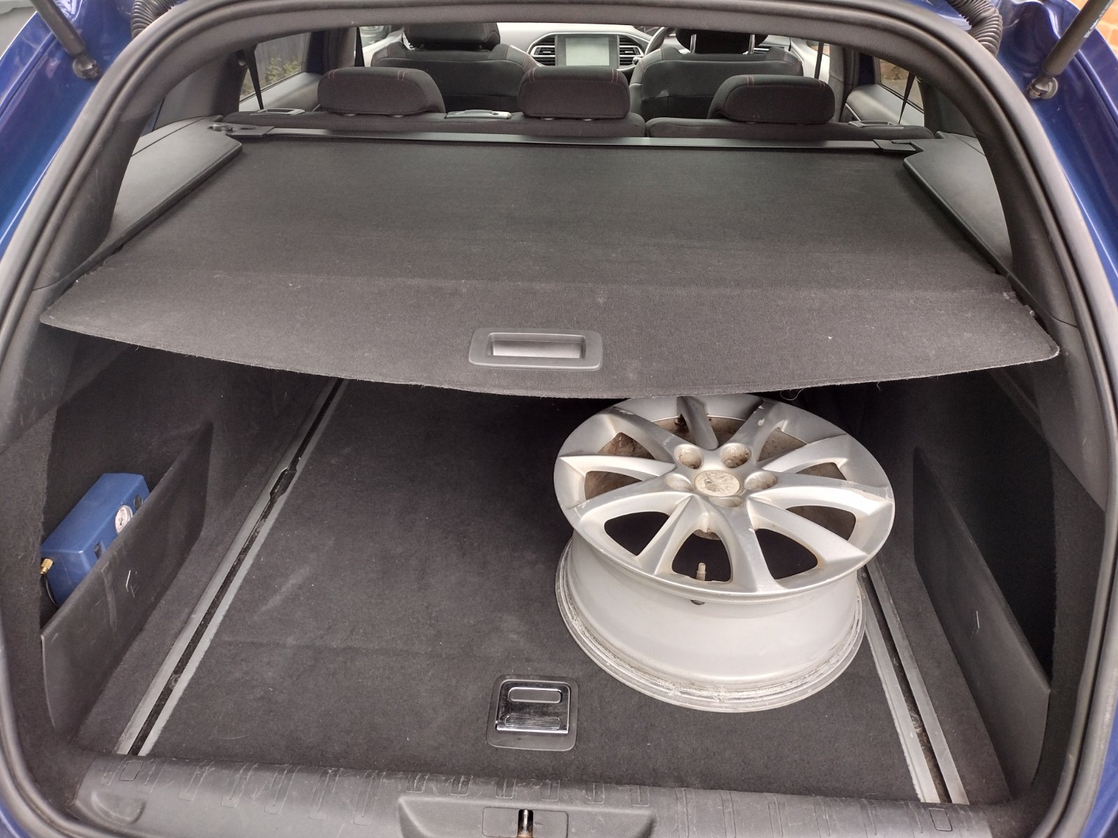

Not very exciting, but hurrah! Parcel shelf is here:
- Posts: 55182
- x 8440
Excellent

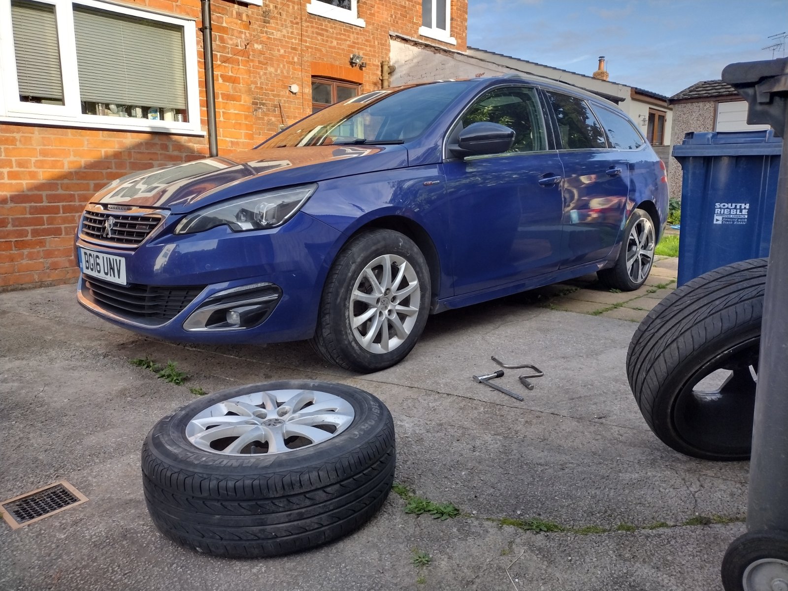

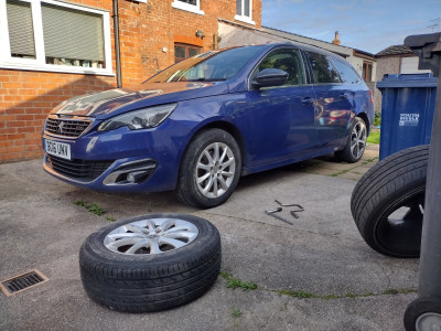

Done! (Though ultimately I'd like to respray the new wheels as they are not seriously oxidised but are a bit tatty.
- wheel swap to get rid of the awful tyres (and oxidized rims

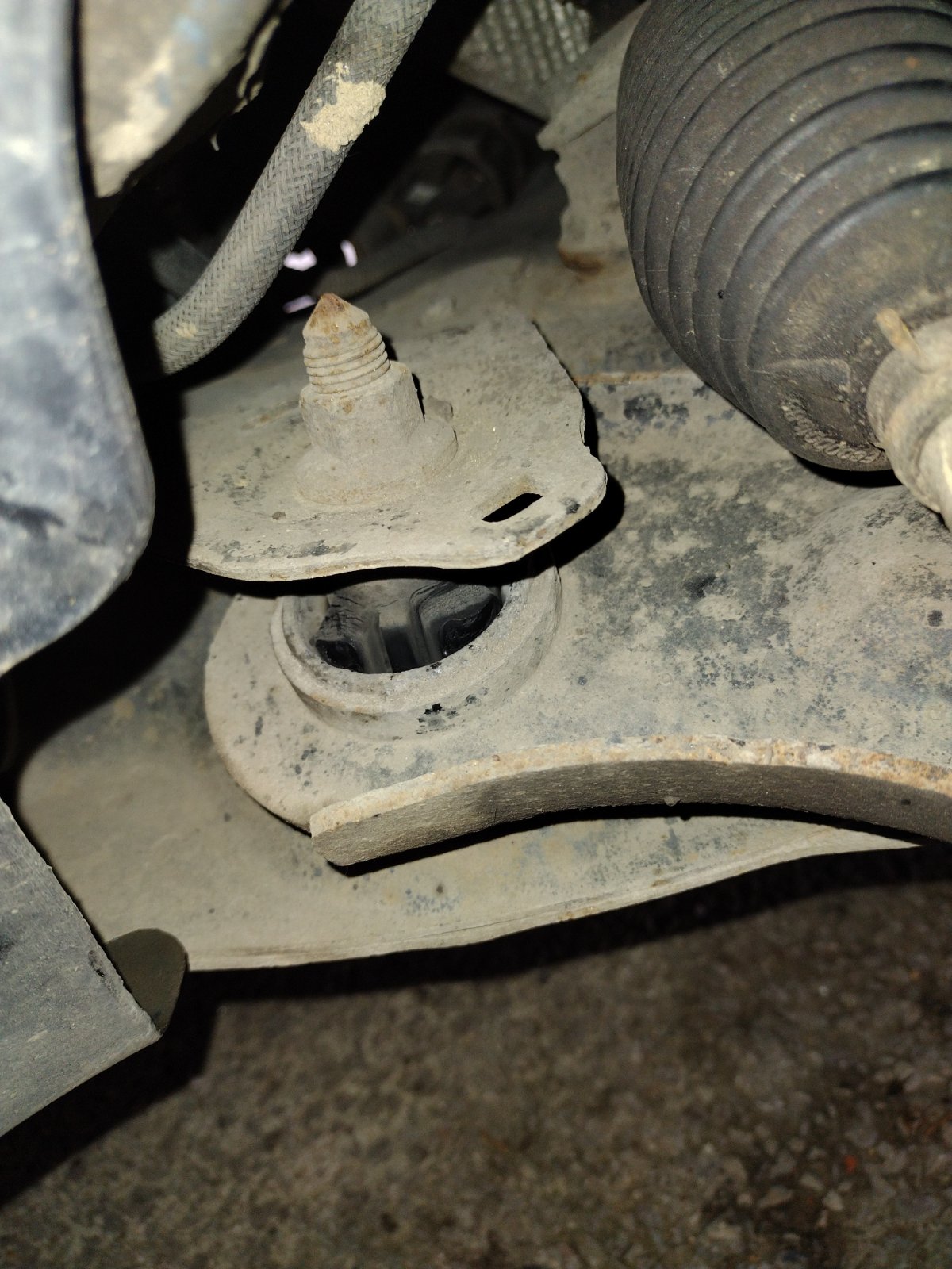

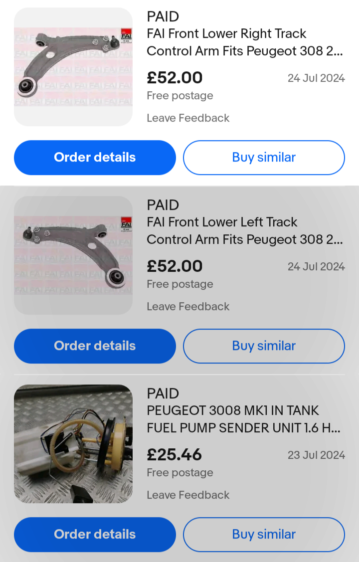

Two full wishbones, including ball joints, FAI brand, bought this morning. I've gone for the fancy cast alloy wishbones over the slightly cheaper stamped steel version. When including the ball joints there's very little price difference (and they won't rust the same, feel more receptive to bush replacement in future)MattBLancs wrote: 14 Jul 2024, 21:29 Oh and tired looking wishbone bushes, rear end of both front wishbones:
Wishbones were £59.99 each, immediately received a "seller best offer" of £56.99 so posed a best offer of £52 each on basis of combined postage. Kindly accepted.
The 3008 fuel pump is a backup plan for the C5 (will strip the electric in tank fuel pump from this sender unit to hopefully fit in the C5's sender. Well, more hopefully I don't have to dig into the tank again given that bloody awful pig of a sealing ring that put up such a fight last time)
Fuel pump had a voucher so actually was £21.39 all told - seemed daft not to grab it at that price.
I've also bought a load of O-rings to hopefully swap into all the fuel pipe connectors to test out my air ingress hypothesis.

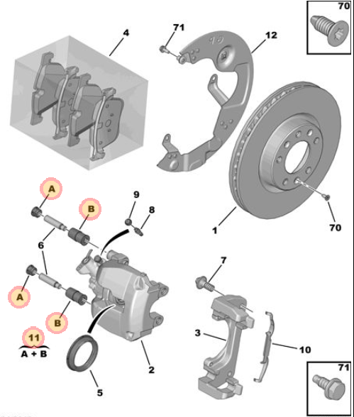

On the brake caliper guide pin cap front, Marc has kindly provided the following:
Anyway, 443914 into eBay suggests:
MEYLE 014 698 0006 GUIDE SLEEVE KIT BRAKE CALIPER Front
https://www.ebay.co.uk/itm/354608171824?
£7.45 for 2 guides + 2 caps.
Autodoc fed the same 443914 suggests Stark brand 2 guides + 2 caps £3.64 as follows :
STARK Guide Sleeve Kit, brake caliper https://m.autodoc.co.uk/stark/15753580
Or better still, £3.41, same brand, but includes the guide pins too:
STARK Guide Sleeve Kit, brake caliper https://m.autodoc.co.uk/stark/8113909
Looking online, I've bought a couple of new nuts in this thread size. Interestingly they are 32mm hex so perhaps what's on there currently is not too far wrong! One has definitely been cross threaded though so will be changing regardless. £3.09 each.
Quite surprised how expensive these are too especially given it's only guide tube and cap, no bolts etc as far as the imagery shows (not sure if that's two caps and two guide tubes or if it's double that cost per caliper!

Ta da!
These 508 alloys are pretty rough cosmetically, but that's another day's worrying.
Two "Yokohama BluEarth-GT AE51" in size 215/55R16 97W they are "XL" extra load rated, will see how ride comfort is with these.
Discount £10.00 making the bill £215.98 for the pair. Asda tyres seemingly cheaper than Black Circles this time.

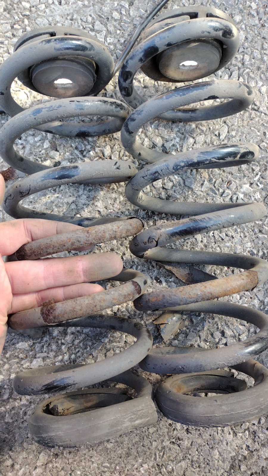

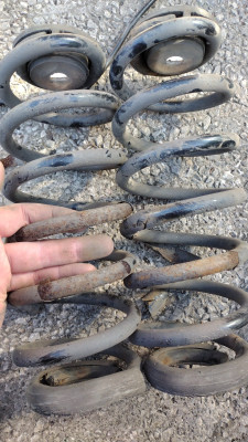

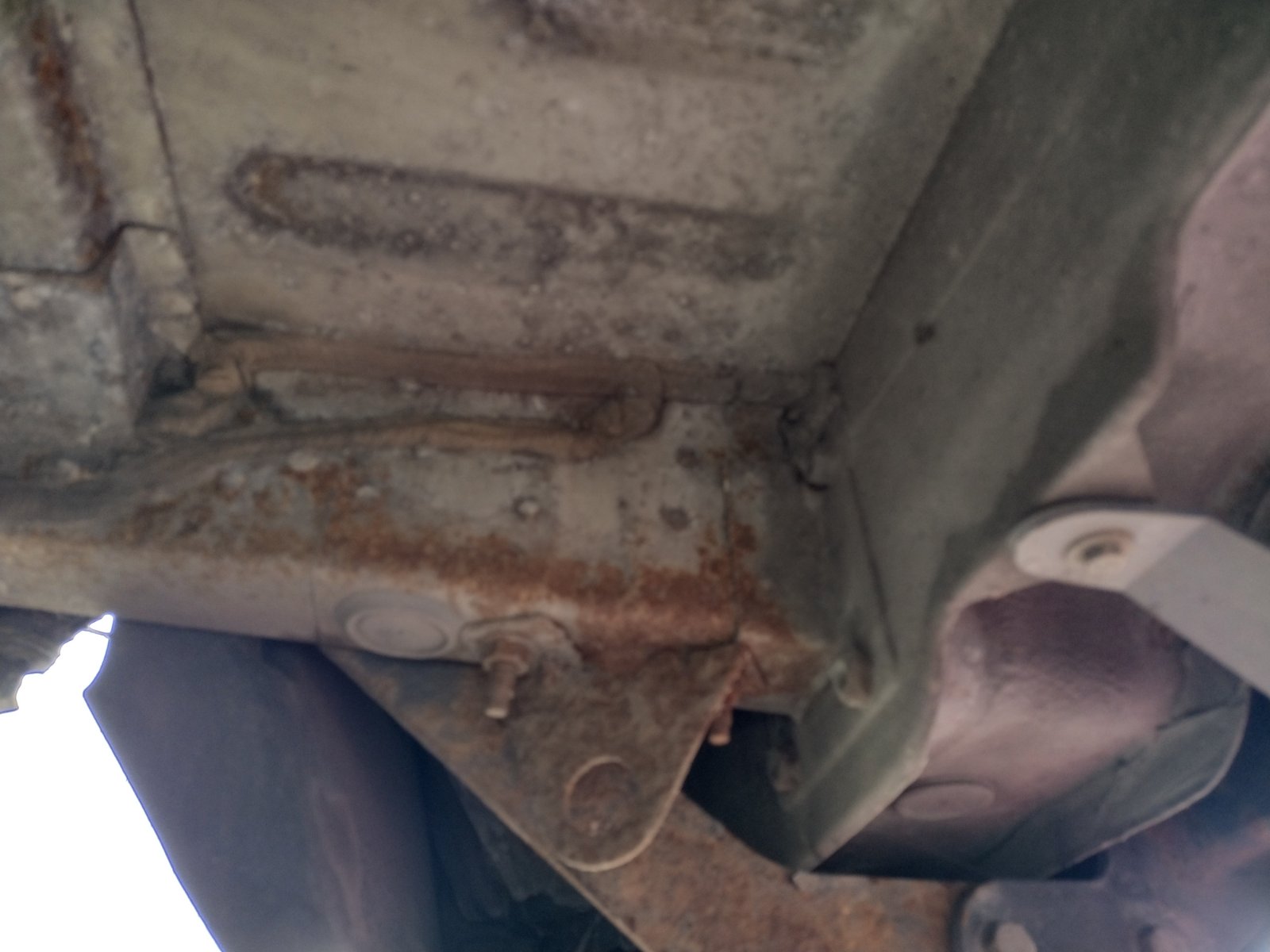

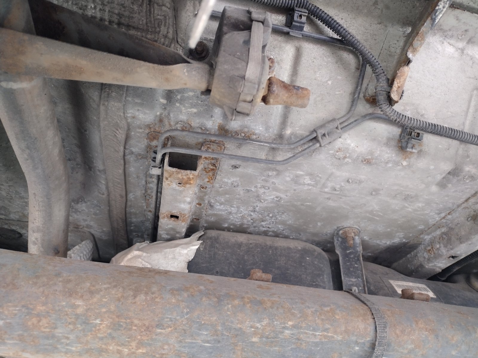

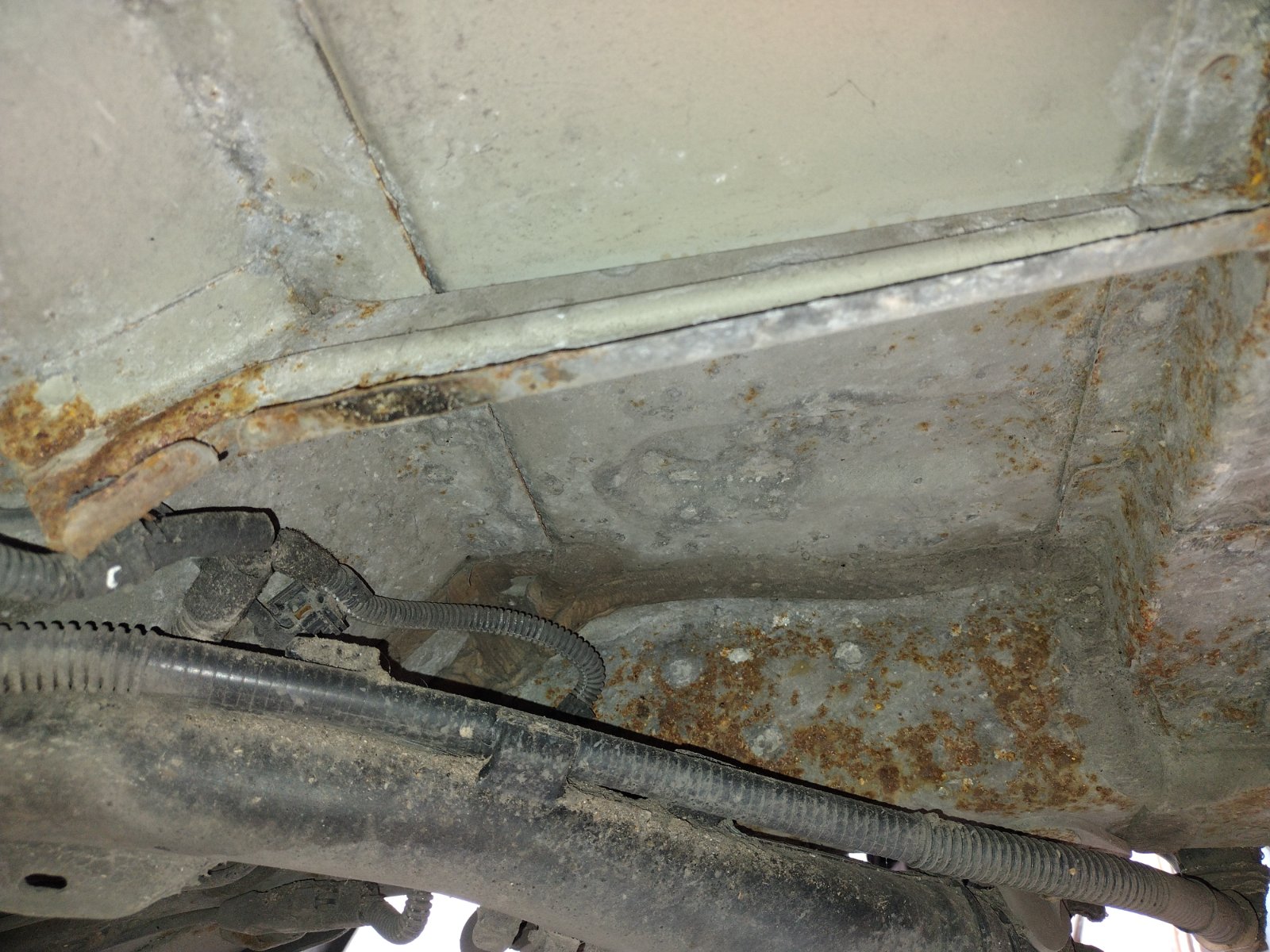

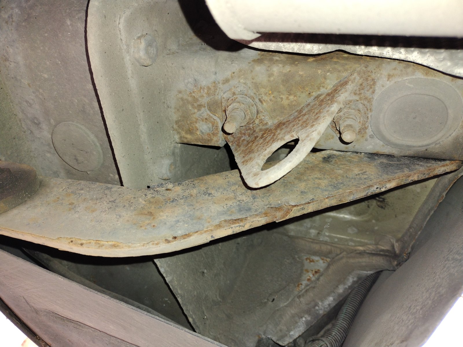

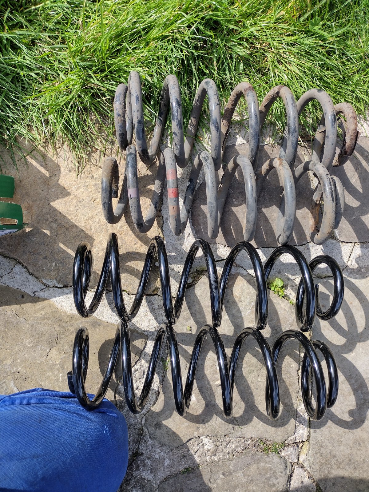

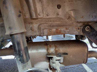

Grey 308, MOT advisory said rusty rear springs, so time to change those.
Quite a lot of surface rust in wheel arches and under the boot floor so sanded back, phosphoric acid, the end of my tin of zinc 182 and a coating of chassis black in both arches and most the boot floor.
- Posts: 5364
- Joined: 25 Apr 2022, 09:03
- x 2367
New ones are going to put up more of a fight going in than old ones did coming out!! Quite a bit extra uncompressed length.
Tried removing the beam's front mounting bush bolt (to let me drop the beam to the limit of the flexi hoses / ABS cables) - nut is free but the bolt seems rather seized in place! Annoyingly the bush looks a bit tired so I will be tackling this seized bolt at some point.
Arches and boot floor have had chassis black then top coat of Tetroseal
