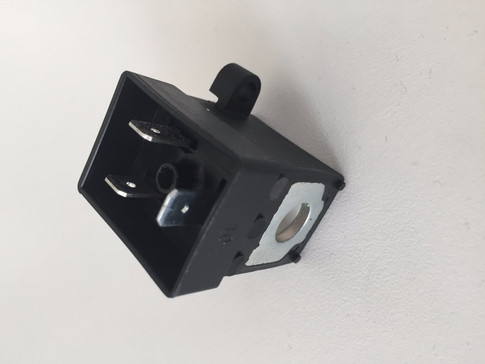

So this little bugger failed on Saturday. Anyone want to guess what it is and for extra points what it is out of ?

Mandrake wrote: 18 Jul 2017, 09:55 So this little bugger failed on Saturday. Anyone want to guess what it is and for extra points what it is out of ?
A new one should be arriving today...
Door lock or water solenoid out of a washing machine? Hotpoint...

RichardW wrote: 18 Jul 2017, 11:08Mandrake wrote: 18 Jul 2017, 09:55 So this little bugger failed on Saturday. Anyone want to guess what it is and for extra points what it is out of ?
Good try, but no.
Any other takers ?

- x 1751
Re: Simon's new Xantia V6 and Peugeot Ion blog
Only three contacts, so maybe not a relay....although a 3-contact relay is possible, if unusual.
Is there a hidden something on the back? Tube, twiddler...?

Ok I'll stop teasing.white exec wrote: 18 Jul 2017, 16:00 Only three contacts, so maybe not a relay....although a 3-contact relay is possible, if unusual.
It's the gas control electrovalve. The coil went open circuit so although the pilot light stayed on it failed to ignite the main burner when commanded... It turns out the coil sleeve is a separate part that just screws onto the main gas control module with a couple of screws, and slips over an aluminium post which will have a magnetically operated needle valve inside. Very much like the HA2 electrovalves in a Xantia!
