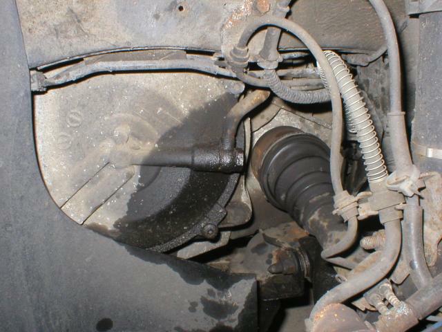

Ran down to Somerset in the New V6 on Sunday to see the folks. The girls came with me and we had a great day. V6 ran like a dream.
Monday I'd planned to do a little light spannering on Old V6 to sort out the starter motor; it was a little reluctant to disengage on the first start of the day.
Before getting to Old V6, I gave New V6 a quick check over after her run and was shocked to find a puddle of oil under her. Closer inspection showed it to be transmission fluid :o
the cause was a leak at the Banjo union on the end of the gearbox where the pipe from the cooler terminates. It was a tad loose and a tighten has almost stopped the flow but not completely. I need to replace the copper washers eiter side of the banjo.
Here's the guilty party:
In 300 miles the gearbox lost a litre and a half of fluid. Good job I spotted it. A leak like that could have pumped the 'box dry...

Lucky you caught that leak when you did Jim!

Good spot on the leak Jim, isn't it strange that a bolt can stay sealed for 12 years and suddenly start to leak :?
