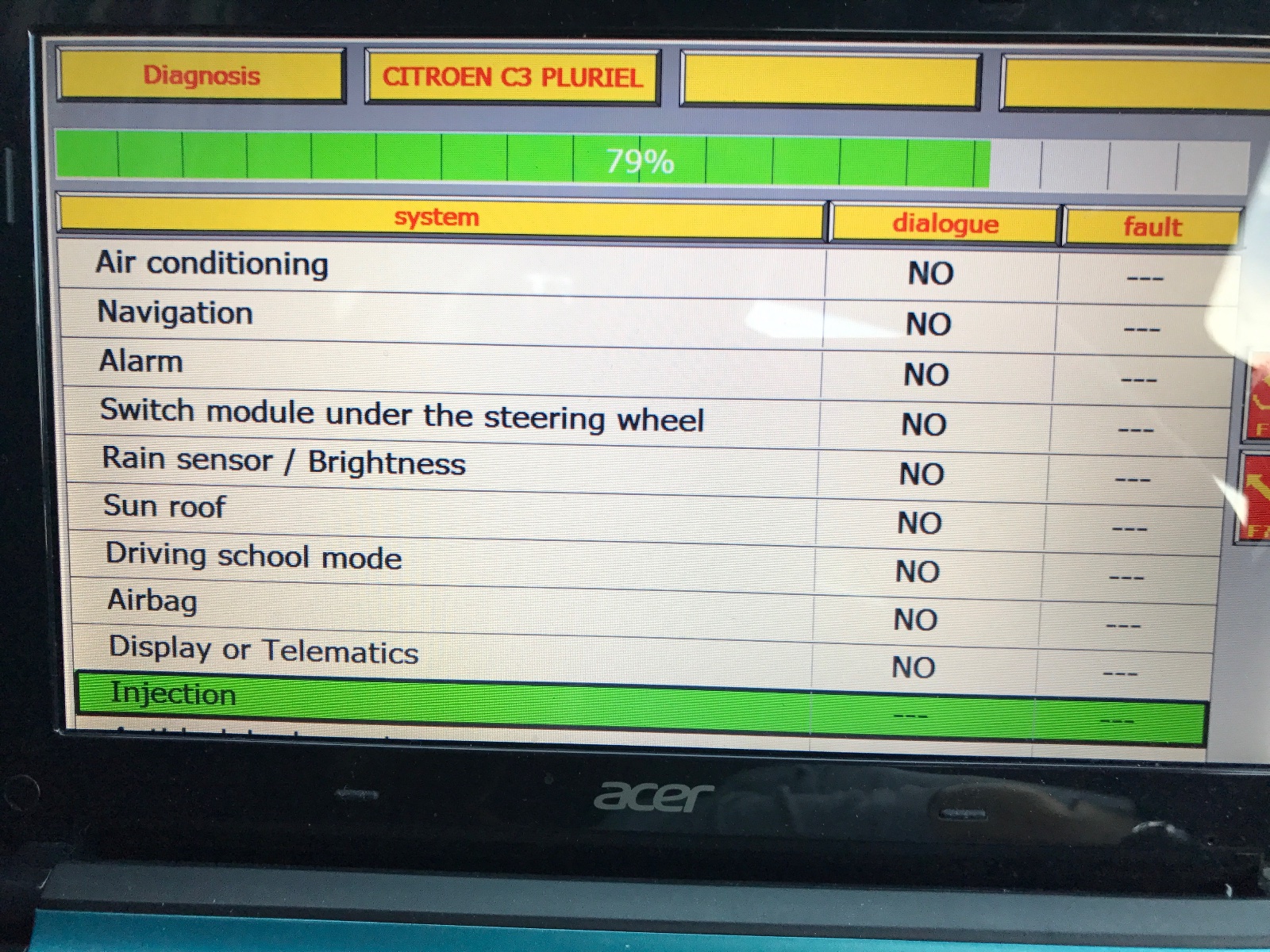

I'm hoping for some advice on the following - I've installed Diagbox on a Windows 7 netbook, and after a bit of hassle it seems to be installed correctly. It's version v.07.02 and the car is 2007 C3 Pluriel. It correctly reads the VIN and I enter the RPO number (1112). When I select the global test the dialogue box on each of the tests in NO (see attached image). I know there is a fault with the airbag (I disconnected the airbag to remove the steering wheel and now need to clear the fault), but it doesn't seem to be connecting.
Is there something basic I am missing/doing wrong?

Re: Merged Lexia & Diagbox threads
Tim, this is indicative that your VCI is not communicating with the car - the NOs mean there is no dialogue with those ECUs. Until you resolve this, you won't be able to do anything.
This may be for several reasons - here are a few pointers:
1) What version of Windows 7 are you using and is it a 32 or 64 Bit? You won't be able to use a 64 Bit version with this software outside of a VM.
2) Assuming you are using a 32 Bit Operating System. when you installed the software, did you enable all the firewall requests to go through? - These requests must be allowed, otherwise communication may be blocked.
3) If you have more than 1 USB port on your Netbook, ensure that you plug in the USB from the VCI into each port, and leave it to ensure that Windows installs the driver for each port.
4) If using your Netbook on battery only whilst it is connected to the car, ensure that you have gone into the Windows Control Panel, open up the Power Management applet and then go into custom or advanced settings to modify the current power plan. From here expand all the options until you find the settings for USB ports. Ensure that they are NOT set to turn off the USB ports OFF to save power - this will disrupt / stop communication between the VCI and the Netbook if it detects a period of inactivity.
5) It has been noted on this thread that Netbooks can be borderline on the minimum system requirements to run Diagbox / Lexia as these are very resource hungry programs.

GiveMeABreak wrote: 20 Jun 2017, 08:49 Tim, this is indicative that your VCI is not communicating with the car - the NOs mean there is no dialogue with those ECUs. Until you resolve this, you won't be able to do anything.
Unfortunately I've checked those and I am still having problems (it's a 32 bit install). The other laptop I have is a new MacBook with Sierra OS which only supports Windows 10 in Bootcamp. Is there any other way of getting it to run on Windows 10?

Following my last post, I installed Parallels and with W7 32 bit and managed to get Diagbox working on my Mac - I've just connected it to the car and I am having the same issue (no dialogue). Could it be a faulty cable? Would an incorrect RPN have an effect. I have attached the information plate on the car and would be grateful if you could confirm the number I should be using.
Thanks!

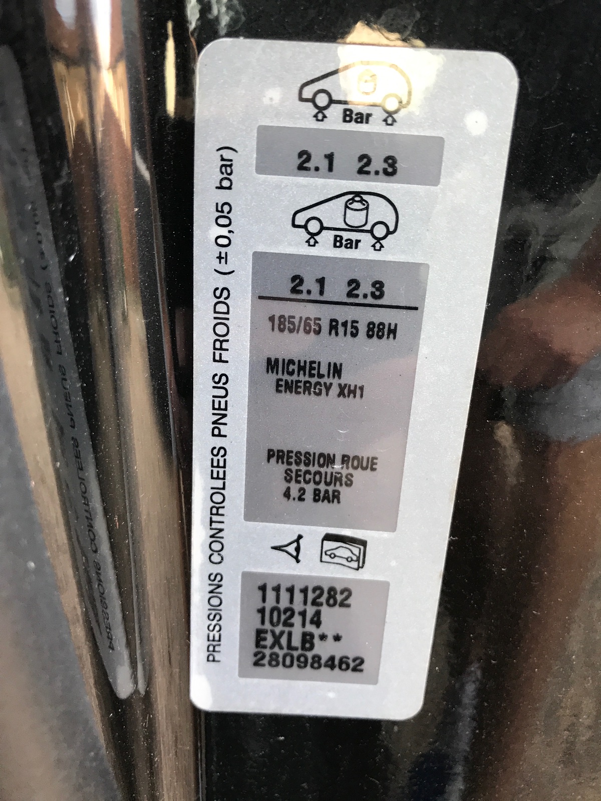

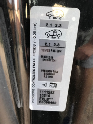

The RPO won't cause that (10214) is the RPO number. There is a comms issue. Is there a green light on the VCI? Are you sure the USB Evolution drivers have been installed? I wouldn't like to hazard a guess as to whether these would work under a Mac OS even running emulation software. The drivers for the VCI must be installled properly. It is a possibility regarding the cable could be faulty; the only way would be to try another cable or Lexia. It's quite difficult to troubleshoot remotely. The software may be running but it cannot communicate with the VCI, so cables, VCI or drivers are the likely cause.
