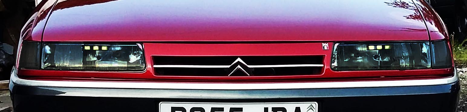

I will take a couple of pics tomorrow so you can see better if I may.....

Does this help ?xantia_v6 wrote:I might have been misled by artifacts in the .jpg. The early lenses have a rectangular pattern to the fluting, the later ones, more of a diamond pattern. I have seen later cars with early lenses fitted as replacements. The early lenses illuminate the footpath nicely, but not so much the road ahead.

The RH lens (at the left of the photo) still looks like an early one to me. Can you see, looking at the actual car, that the pattern over the dip lights is the same on both sides?Stickyfinger wrote:Does this help ?xantia_v6 wrote:I might have been misled by artifacts in the .jpg. The early lenses have a rectangular pattern to the fluting, the later ones, more of a diamond pattern. I have seen later cars with early lenses fitted as replacements. The early lenses illuminate the footpath nicely, but not so much the road ahead.

I must admit I thought they were the same....I will check the lamps on the donor car this morning

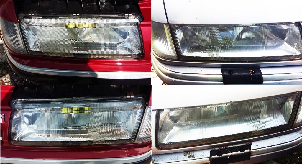

This is what I have available to me.....

Those are all late lenses except for the top left, which is an early one. I am not sure whether the early reflectors are different, I have fitted a late lens to an early reflector and the pattern seemed OK.
