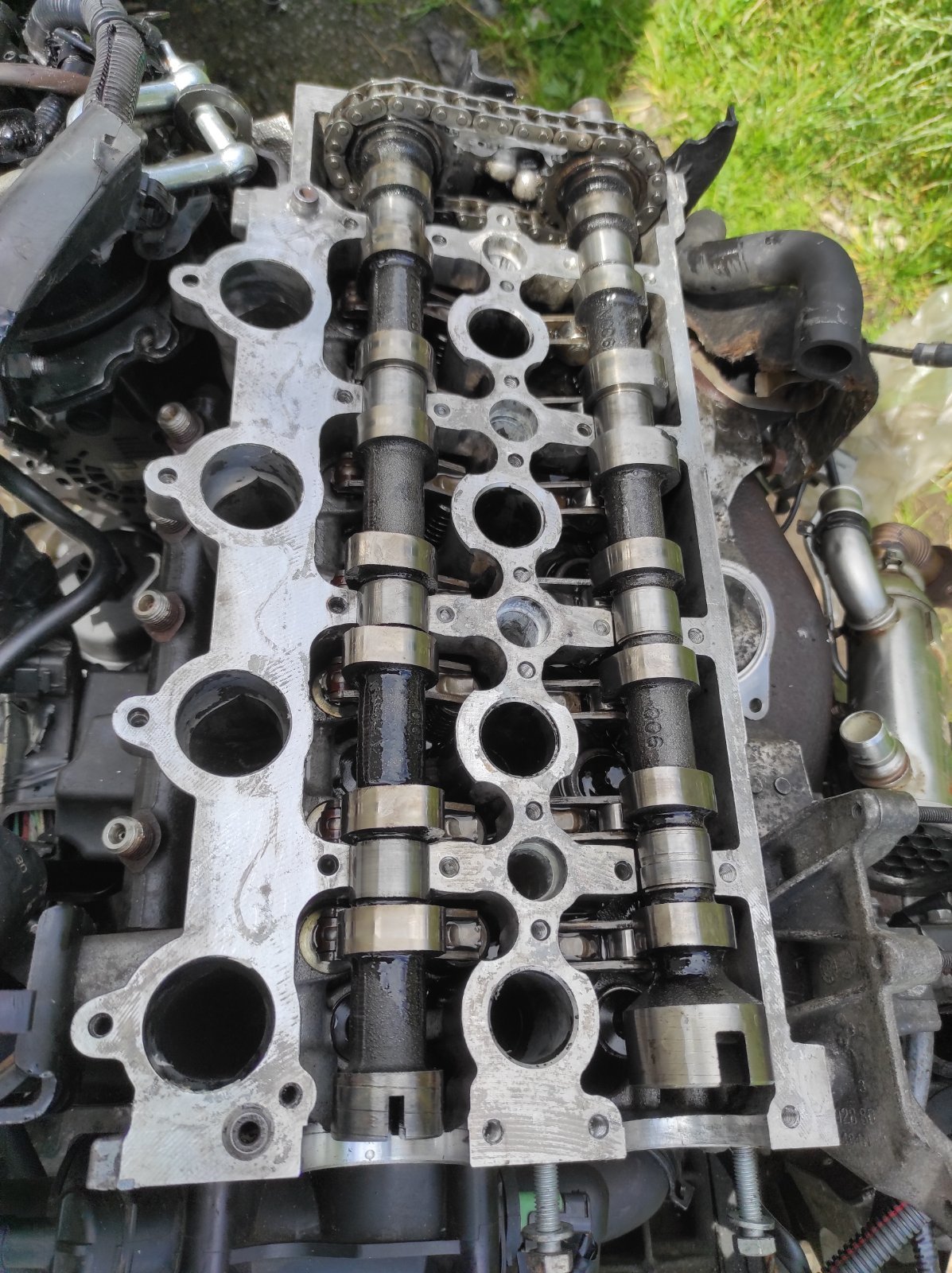

Well it just took another turn when I went to put the intake back on I noticed one of the rocker arms on cylinder 3 was lying on its side in the head so I had to pull the valve cover off again
. I have now ordered a replacement which should be here early next week. So the past couple of days work is undone, this engine doesn't seem to want to be fixed or at least cylinder 3 doesn't. Cleaned up put tools away until then and I think a few beers tonight are on the cards. Back in work on Tuesday so enjoy the last few days of my holidays if you could call them that. I did trade my hawk and trowel for an engineering gig during the last recession so go in there and have a rest

Glad you spotted it rather than missing it and trying to start it like that - try and hold on to the positives, that was a lucky save there! Keep on going am sure you will overcome it!! But stick some more pictures up if you get chance, helps us come along on your journey/saga/trials and tribulations!

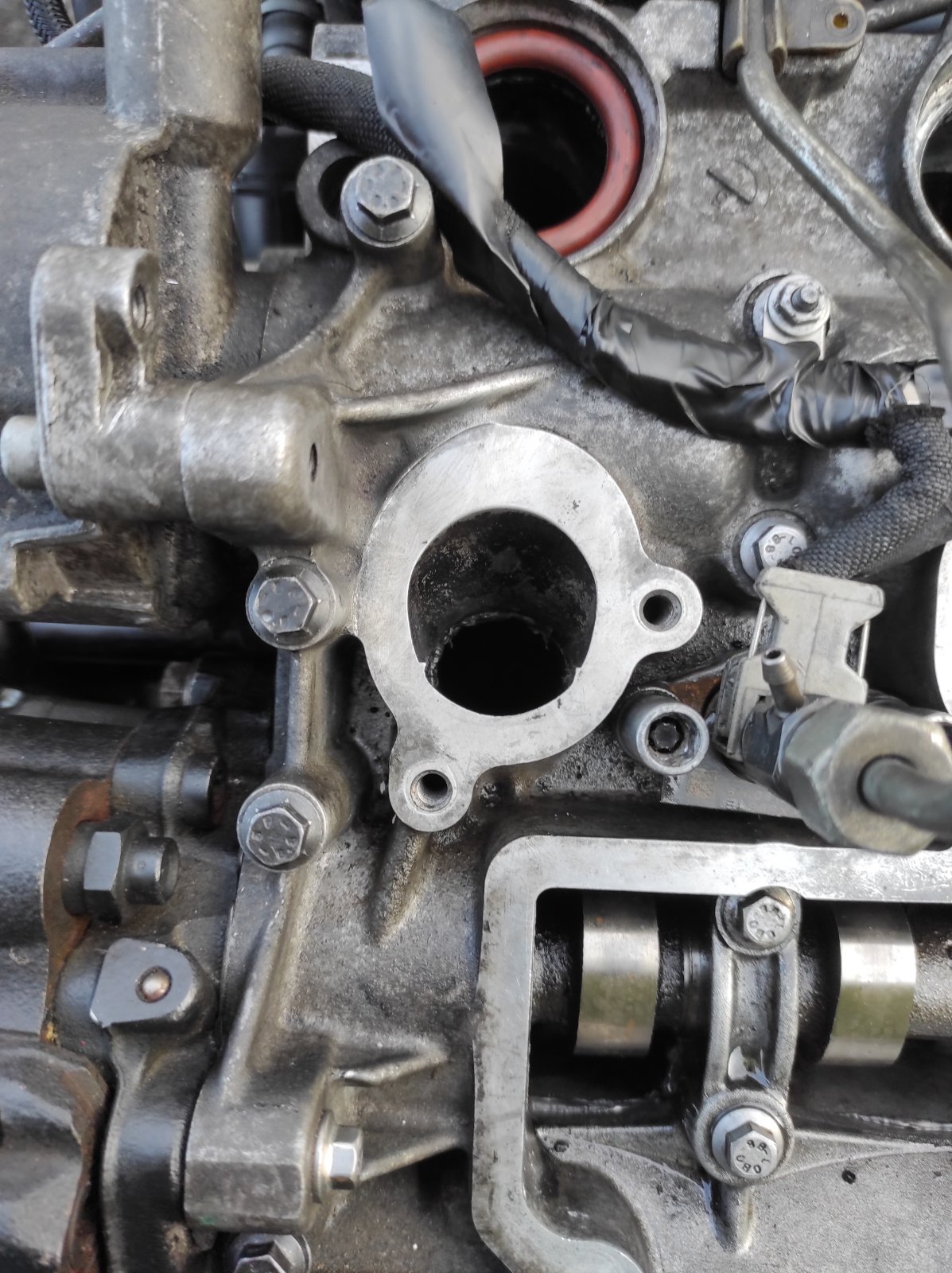

Rebuild back underway had Torrential rain here for the past few days. Water got under the polythene somehow and into no4 cylinder so had to pull egr and glow plugs again!! Blew out the cylinders with compressed air . I have everything back together just have to button up the intake and make sure I am not forgetting anything. I hope to have it back in by the Monday. I had to buy a new small torque wrench 5 -25 Nm. For the valve cover. I had to work fast between showers so pics are few and far between. I will try and get a few more there are a couple of bits I am not sure of their position so may need help identifying them

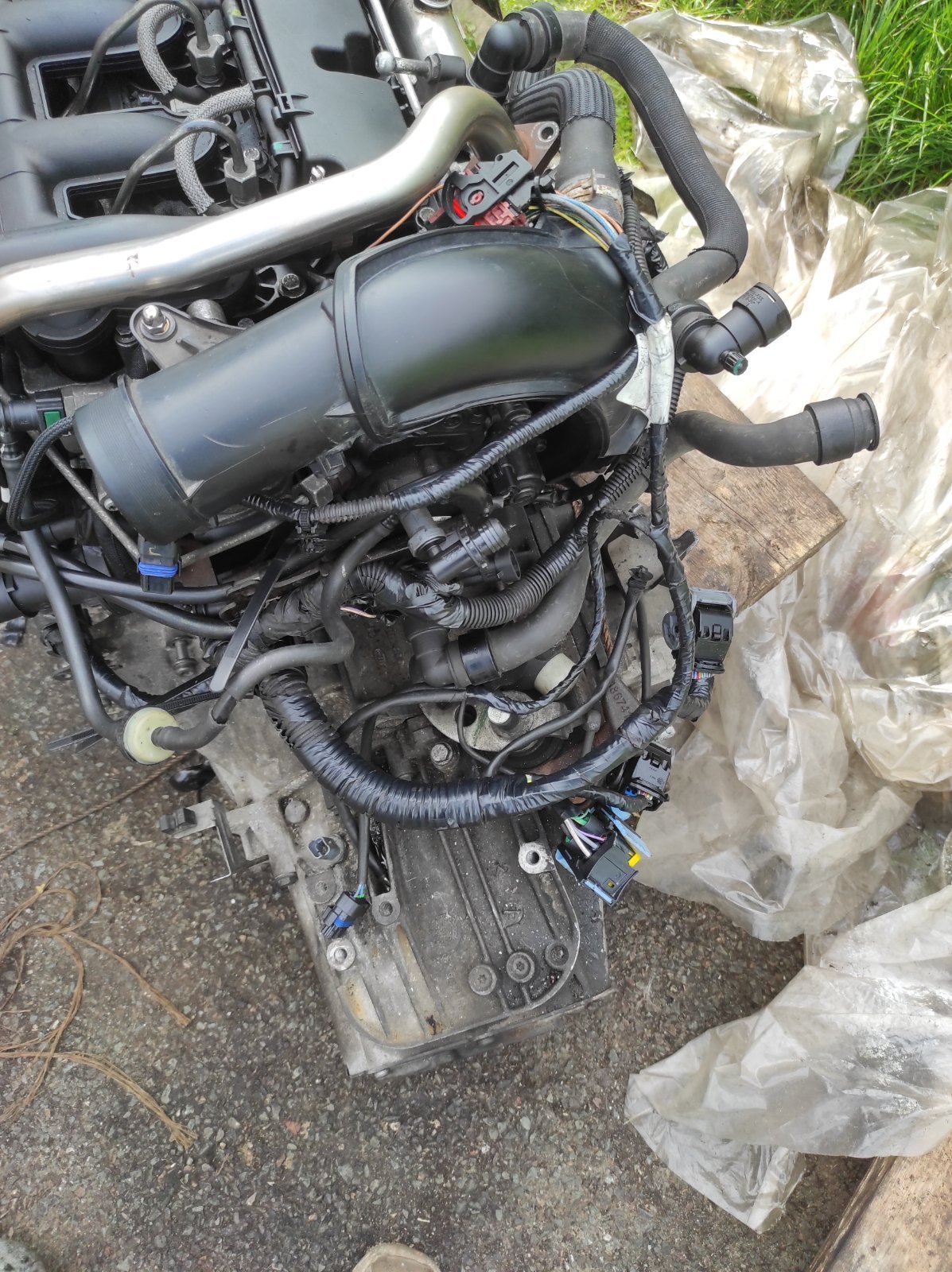

I got the upper intake, egr to intake pipe and vacuum and high pressure diesel pumps back on last night.
I have a bit of loom I am trying to figure out placement on, I think I found pics last night that will show me where it goes.There are so many little bits to get right on these engines.

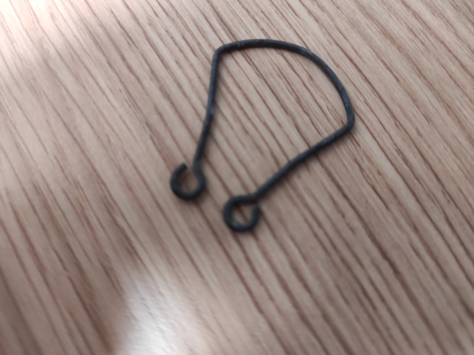

I broke the yellow clip that holds the crank case ventilation hose to the intake when I first took it apart but forgot about it and can't find a replacement online.
I wonder if Marc could post up a part number?

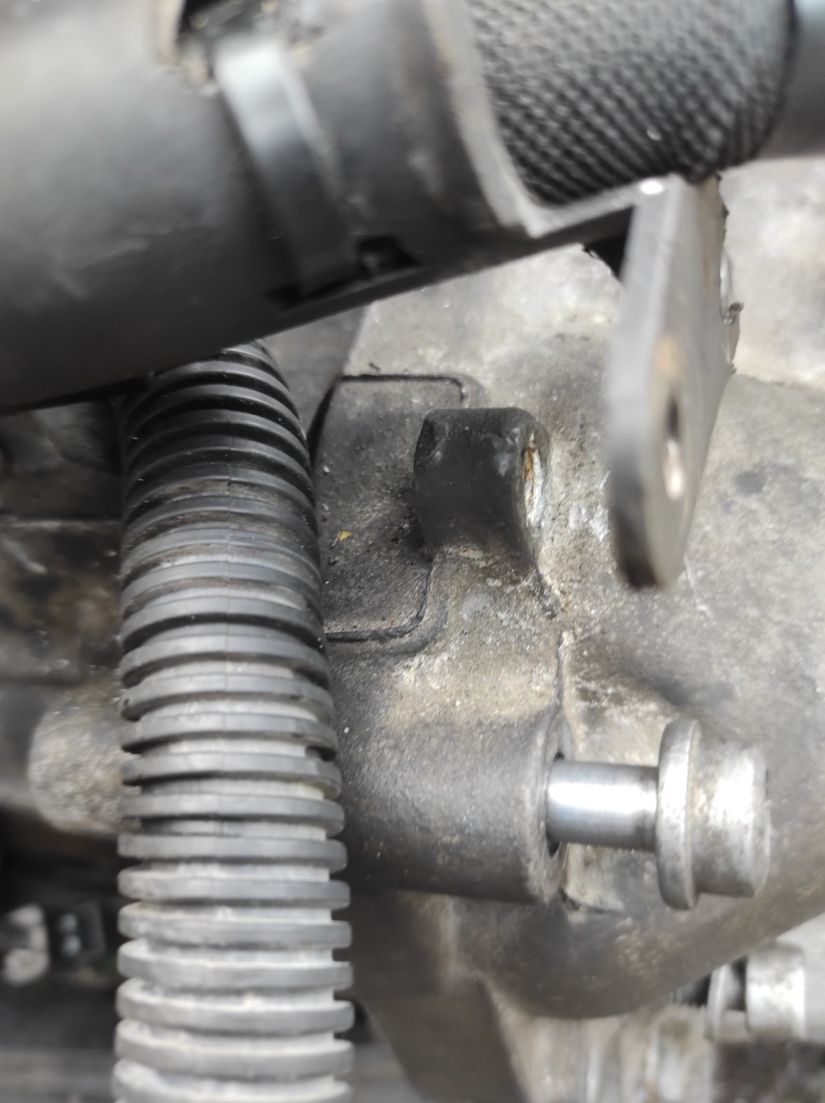

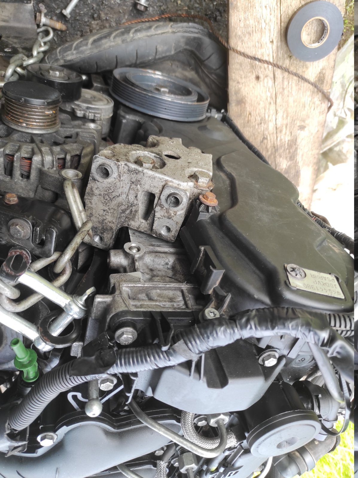

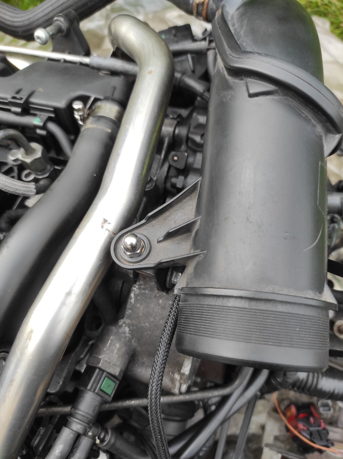

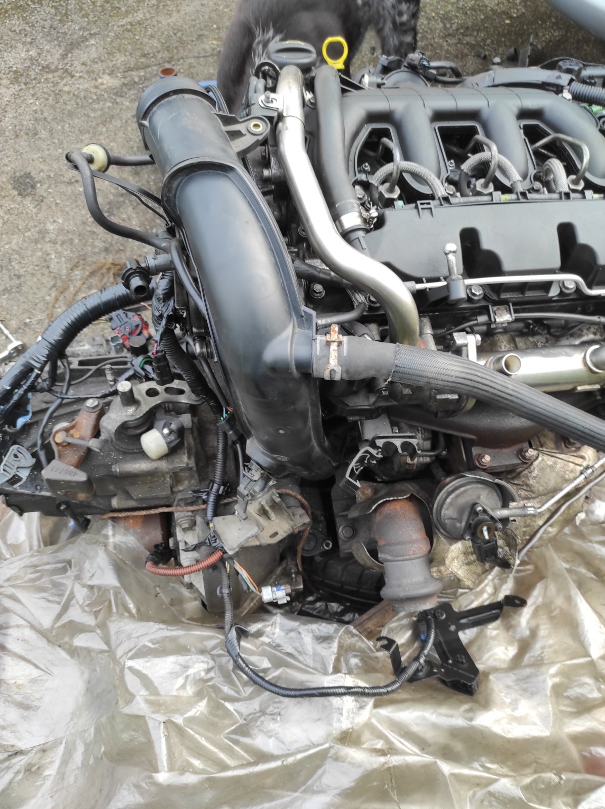

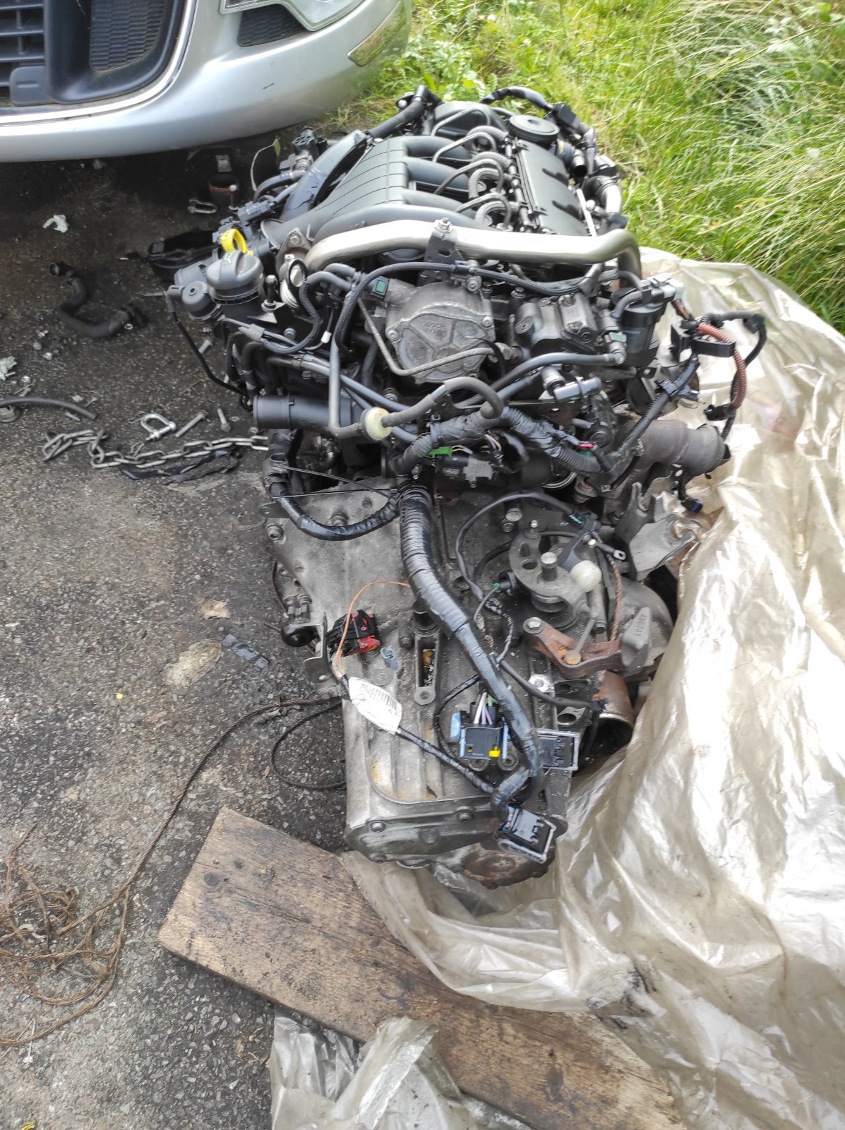

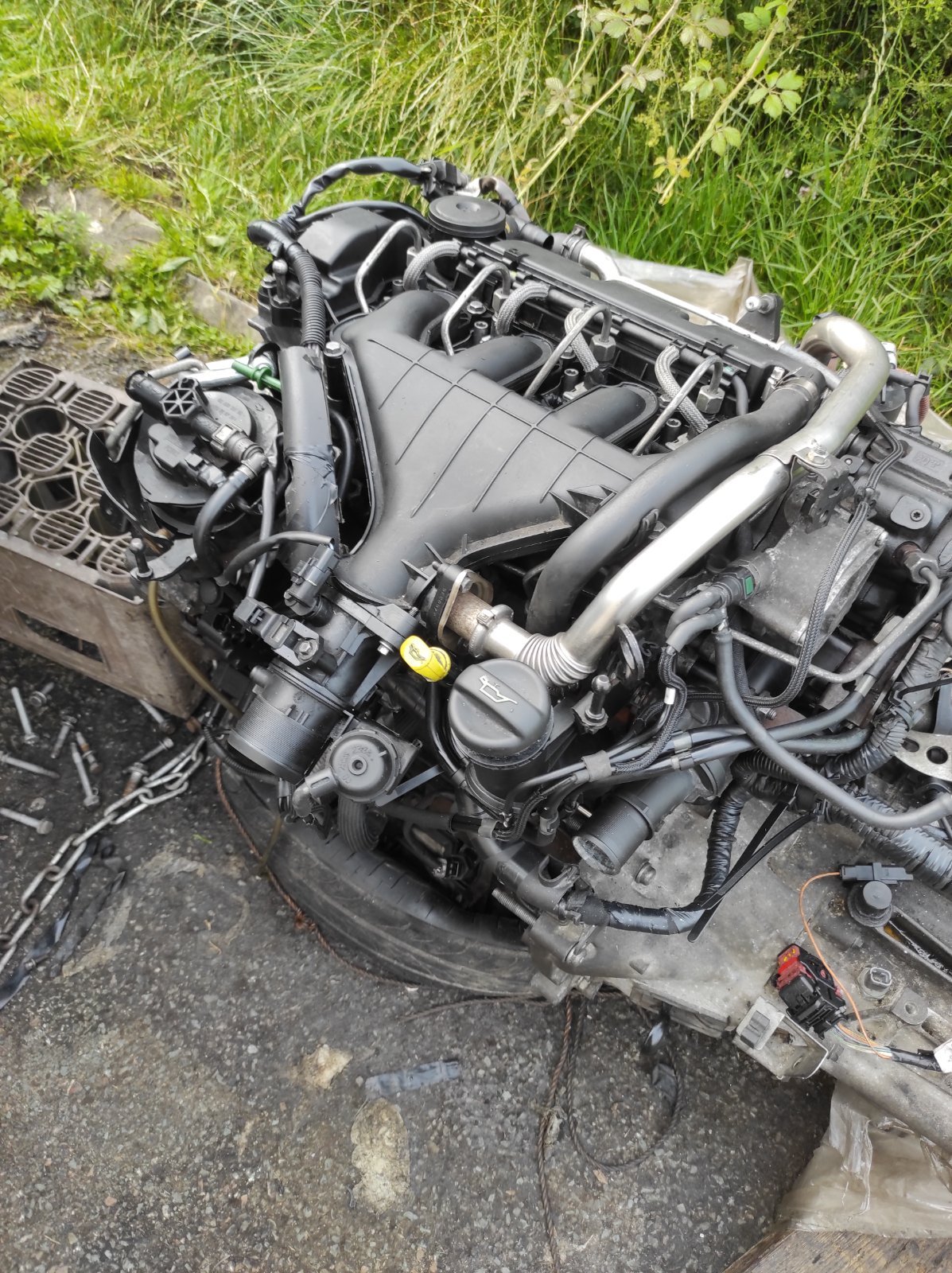

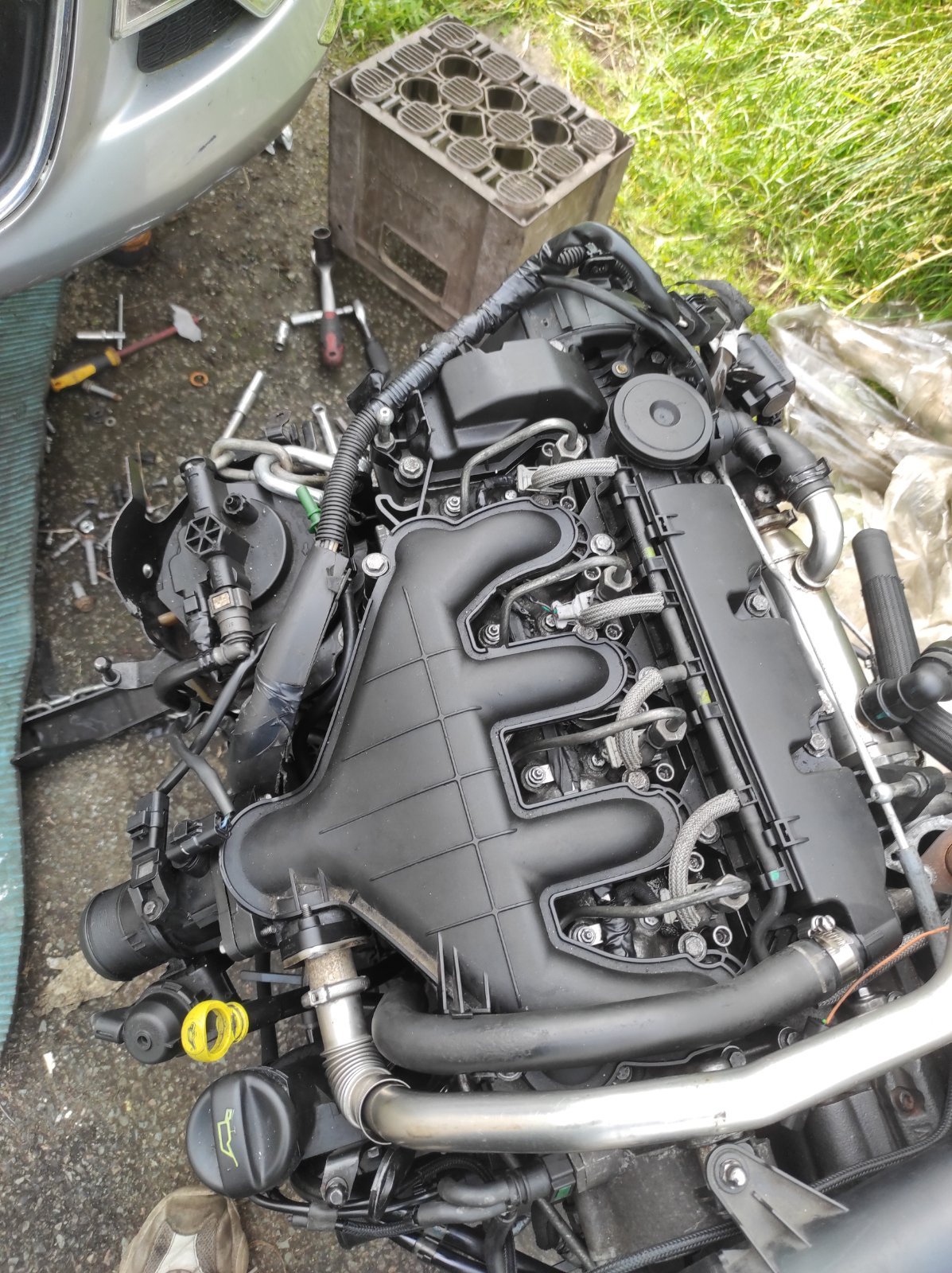

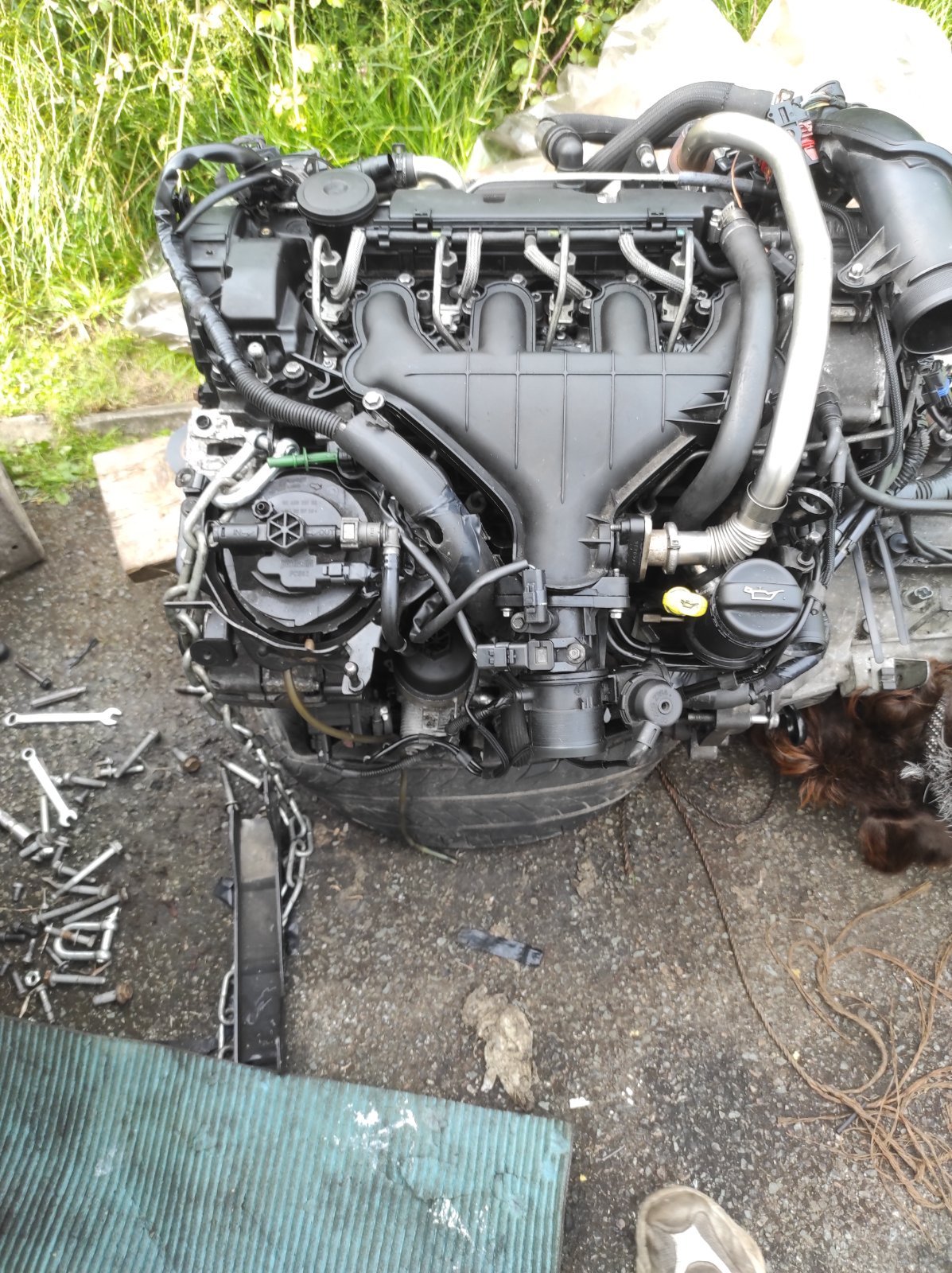

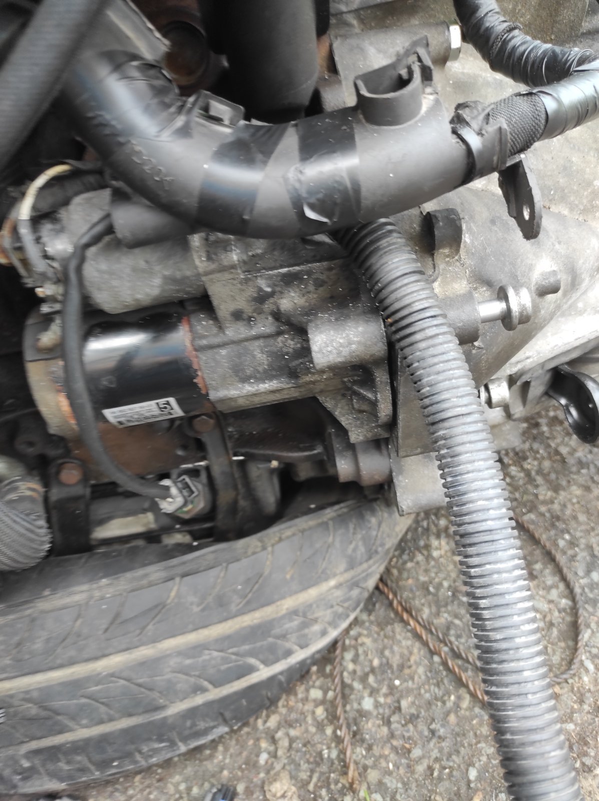

This is where I am now lads and ladies. I have it all timed up and starter back in. I have lost 3 bolts and a pipe clip for the hose to the heater matrix. If anyone knows the part number or any other suggestions please let me know. The turbo pipe that runs under the engine is split as well at the joint under the engine I am trying some Tiger seal but I am not sure it will bind it properly.

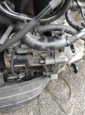

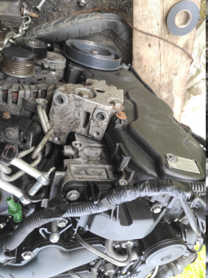

Can you take a picture of the area in question? I'll try and look on the parts Asia site when I get chance. Presume not those pictured (11th and 12th pictures) above gearbox (near starter Allen head bolts) = think standard M8 about 25mm long would do for them. One is threaded hole in gearbox, the other: captive nut in bracket (clearance hole in gearbox protuberance)darbuck wrote: 20 Jul 2023, 20:12 This is where I am now lads and ladies. I have it all timed up and starter back in. I have lost 3 bolts and a pipe clip for the hose to the heater matrix. If anyone knows the part number or any other suggestions please let me know.
Would think the oily nature of turbo pipework would make an adhesive struggle. Not used Tiger Seal myself so not sure on its capabilities.The turbo pipe that runs under the engine is split as well at the joint under the engine I am trying some Tiger seal but I am not sure it will bind it properly.
All looking lovely and clean - especially considering sat on a tyre on the floor for all you've done!

Hi Matt, the bolts are M10 x30 I think that are missing they go under the into the gearbox standard thread 1.5 I think if memory serves me right. Tiger seal is a polyurethane sealant very strong and oil resistant as a bonus it's sitting in the shed clamped I will check when I get home. I'm not concerned about the oil it's the air pressure of the turbo blowing it apart that concerns me. I will track one down online later I think. To clarify I am looking for the part number for the clip in the photo, sorry for the confusion. They're is my current engine stand and the crate is my stool
