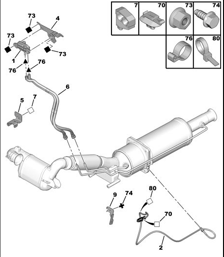

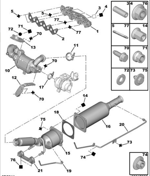

| 19 & 20 are the particle filter pressure pipes, 2 is the gas temp. sensor | 1 is the Diff Pressure Sensor, 6 the particle filter pressure pipes |

So the downstream temp is fine. Thanks for the confirmation. I saw a reading on the diff pressure twice from 6/7 revs, the first 2. Thanks for the pics Marc, Is the noted '2' on the first diagram the '2' on the second 'cause 2 on the first looks like a gasket and I can't see '1' on the second, unless it's '2'? I've got onto Service Box now but have to do it through a VPN in the UK or it asks for my Siret No. (business No.), not sure if it's checked? But hey it it works 'if I'm in the UK!' I'll have a look, but can't teleport whilst writing! I think I need to get under the car, to have a look if nothing else. Just need to figure out why it's in a constant state of regen, though if it does a regen on a non motorway run that will, at least, have sorted the initial issue.

No Pete the component numbers are not the same. These are 2 different diagrams. On the left hand diagram 19 & 20 are the pressure pipes, but 2 on the right hand diagram is the Exhaust gas temperature sensor. If you look closely along side the particle filter on the right diagram you can see the pressure pipe running alongside.

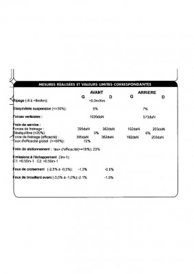

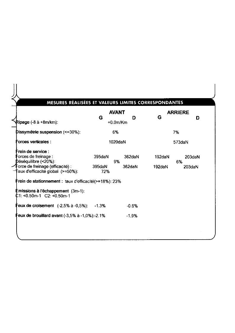

I agree, do you know where the sensor is and if it's checkable? I've checked underneath and there isn't any obvious damage. It's been through the French MOT on the new regs so I don't think the DPF has been played with, also the previous owner had it for the last 100000m and isn't the sort. It does seem odd that 'apparently' it's in a permanent state of regen, however it doesn't keep the soot down to zero ish which is what I would expect if that was really the case, fuel consumption is good also. I'd guess that a high diff pressure would force a regen? What else would ask for a regen?
This a copy of the CT with the emission values, it would be interesting to compare the figures.

I can't really see that picture as it's a bit pixelated.
Could you get an assistant to floor the throttle whilst you look at the exhaust? There should be no hint of black smoke with a fully functioning DPF.

Elis, click on the image then you get a plus sign, or at least I do, just checked it my Diag laptop as well. No smoke what so ever, I watched during a rev test on the CT, I will do it again though, to do it with an auto, better in park or neutral?

Ok, I can see it now, however I should probably brush up on my french!

On my C5 the Diff pressure sensor is located on the bulkhead in the engine bay with the tubes running down to the exhaust tunnel.

Found it, centre top of the bulkhead. It's got the factory fitted pipe clips so I'm not going to touch it until I've got some replacements, the spring loaded clips that hold the fuel lines on mowers look the job. I'm presuming once I've unclipped them I should be able to blow down them easily. That should see they're blocked at the exhaust end, and then if I unscrew the metal pipes from the exhaust and block them up, blow again and I shouldn't be able to. Not going to do anything until I've taken my daughter to Wales though, every things working and I don't want to compromise anything. I say every things working, the ABS ecu is not talking to the 'puter, no warning lights, but I've found a broken wire in the front rh w/arch, guessing it will be that then. Something else to stop be getting bored!
