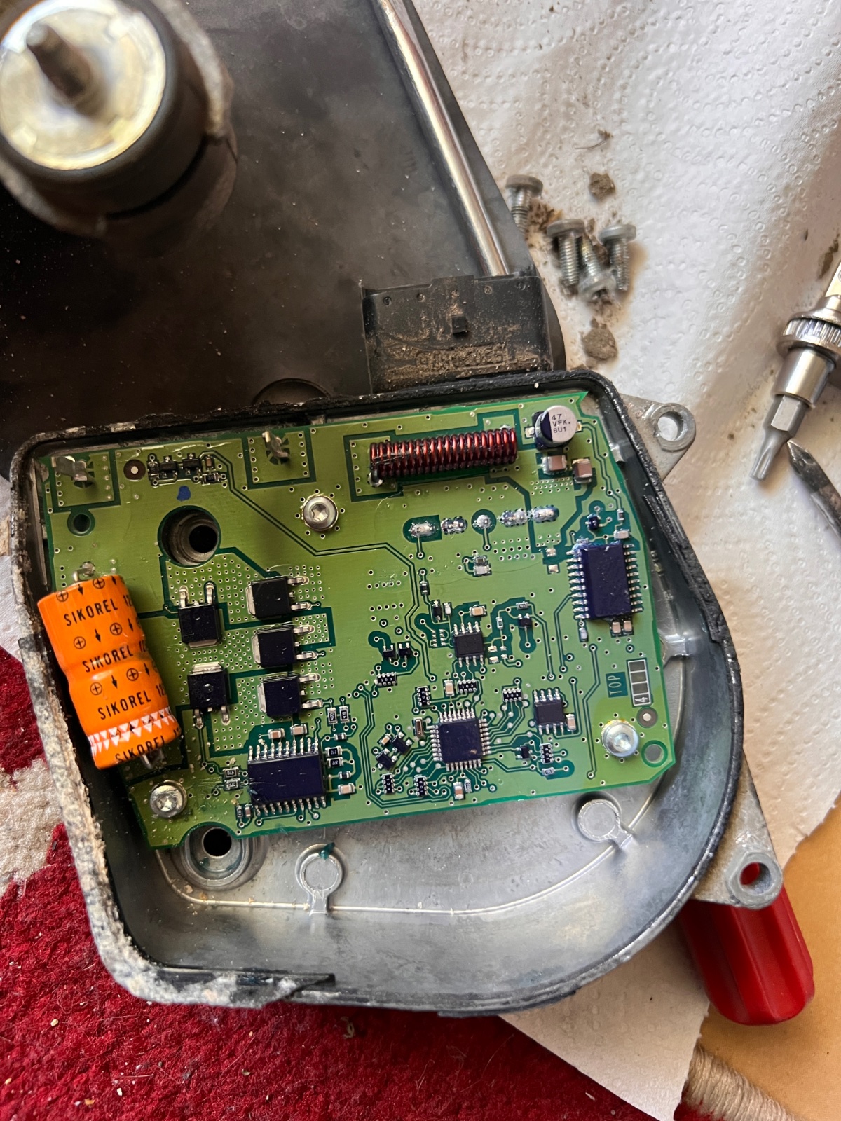

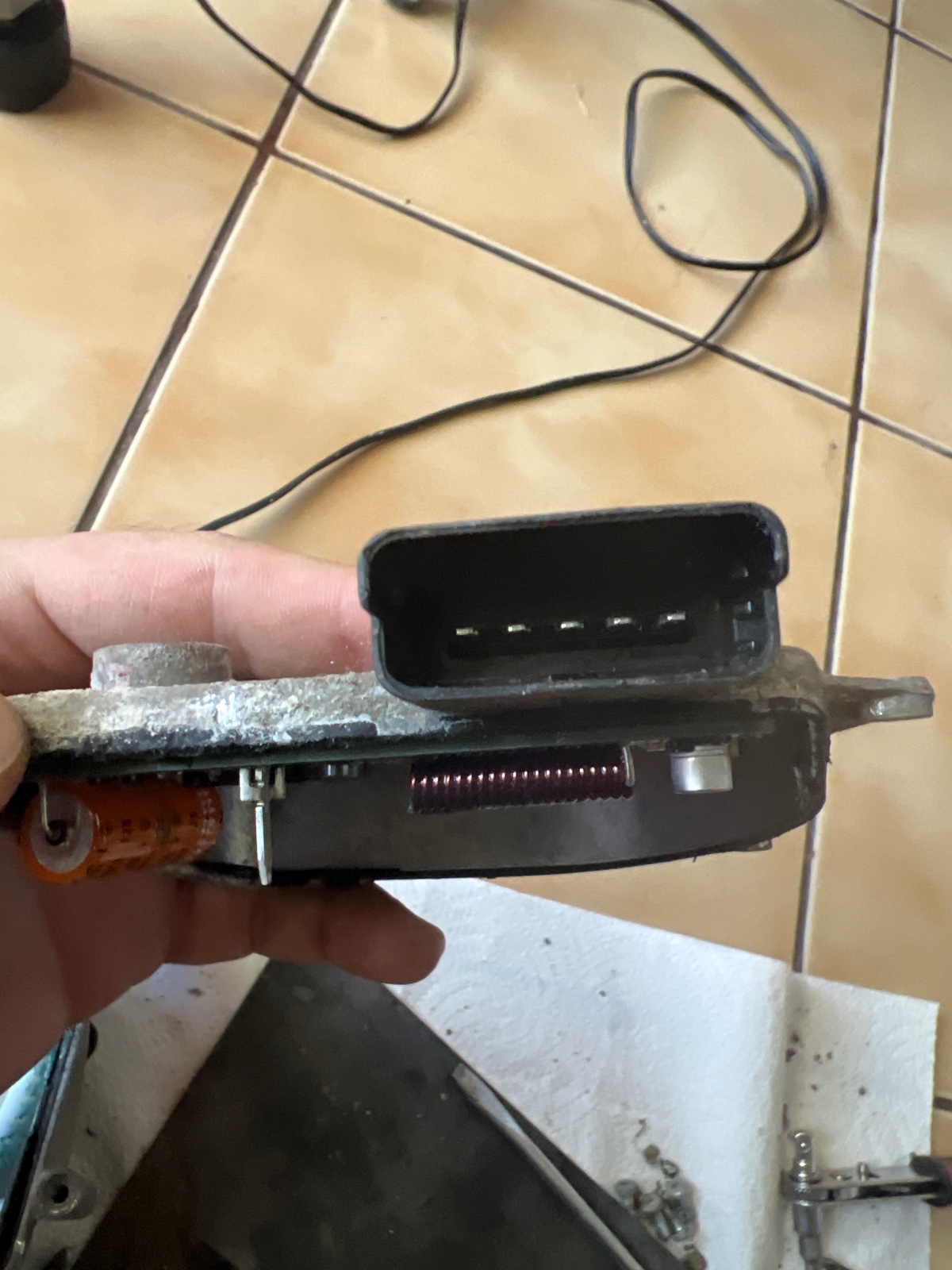

Hello, everybody. My driver's wiper engine doesn t work.
I gave some current from a small 12 v battey directly to the motir (as in video) and it moves. What else could fall?
Which are the positive (supply) and the negative (ground) from the plug (picture)?
