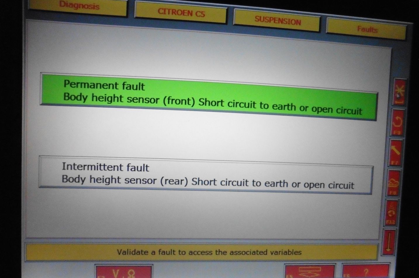

The front height sensor shows as having a short to earth, tests on a valve I think it was dropped the front and also started the pump, which was reassuring to hear.
I have just glued the cover back on the used sensor I serviced, once I have the front jacked and blocked up I shall fit it.
If it does not work a new one will be obtained.
From looking through the menu, I should also be able to reset the height with the Lexia.

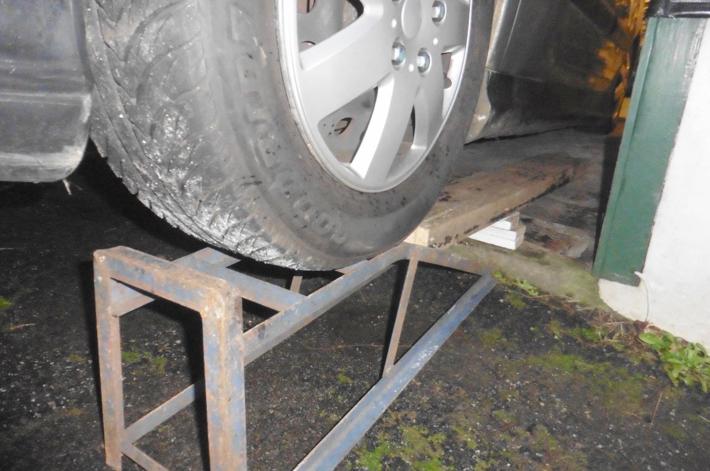

Added : - because of the fault I cannot put the car on high and it is too low to drive up on ramps.
Two pieces of wood four to five foot long and a chain saw and we have the patented Spiff ramp extensions, worked a treat : )
Gods Bless Spiff

Oooh now that's interesting that it has a permanent fault on the front but the front appears to be behaving correctly?
Obviously that needs to be investigated, but for the rear, given you have changed the sensor recently, I would try clearing the fault and seeing if it re-appears? I suggest you need to bell out the wiring to the sensors though, as well as just checking the sensors themselves.

I had not replaced the rear sensor permanently, just tried one to see if it was the trouble, it was not, the pump remained silent.
Today I replaced the front sensor with one I has serviced, Alanna re-connected the battery, I turned on the ignision and the pump ran.
The front which had dropped right down, when running a test on one of the valves I think with the Lexia, rose up.
After another 15 seconds the rear that was also right down, having been depressurised when I replaced the seals in the ram and the gaiter, started to rise. : )
A moment of joy.
We took it down off the ramps and did a couple of up and downs and all appears to be well.
The intermittent fault with the pump not running, which had turned permanent since I worked on the rear ram, appears to be cured.
The front sensor has been causing the problem with the pump, it would run sometimes when I opened the doors, but if I tried to raise or lower the car it would stop running and the Series Suspension Fault would appear.
The pump would then not run for the rest of the day at least.
The same would often happen as I pulled out of the garage or after a mile or so, the pump would then sometimes run again if parked over night.
The pressure in the system allowed us to use the car for some weeks, that was until my birthday 22 12 when the rear ram failed.
The fault cleared as soon as I replaced the front sensor, it must stop the cars computer from signalling the pump to run.
I shall take the faulty sensor apart to see if it is the contact of the three pins to the circuit board that is causing it to fail, at first intermittently and then permanently.
I have a head light bulb to replace tomorrow, but after that I will have a look at the old sensor : )
There is no sign of leaking fluid from the repaired ram, but we shall see how it goes.
