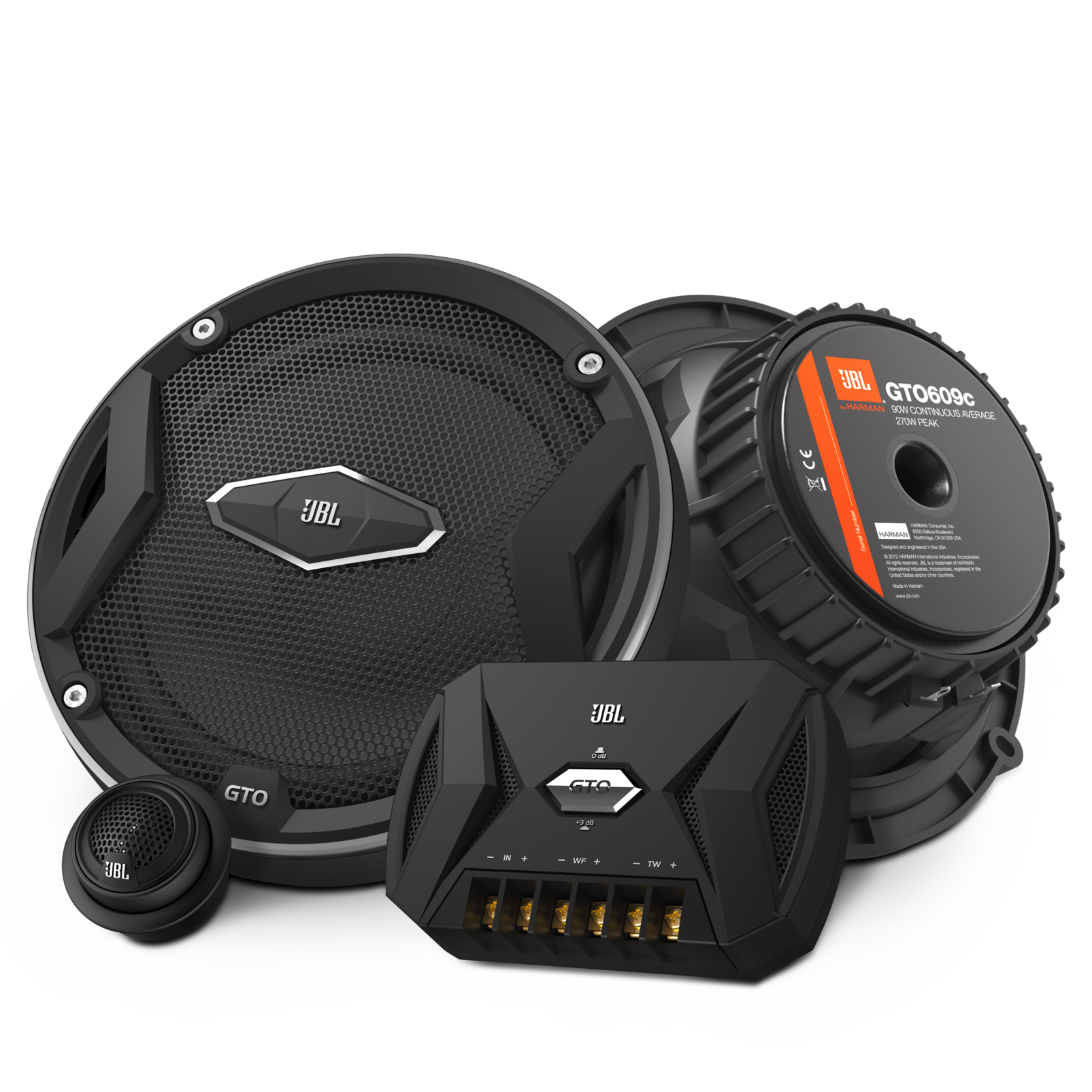

Well, I've spent a while looking and I am none the wiser, it seems that price is the most important variable in quality.
Unless someone can tell me why this would be a bad idea I'm probably going to buy two sets of these: JBL GTO-609C
http://uk.jbl.com/car-audio-systems/GTO ... ck#start=1
elma wrote: 02 Aug 2017, 23:07 Speakers should be higher rated than the amp to prevent distortion and damege. With 80w amp I'd suggest 100 to 125w speakers.
Installing the amp in a confined space I'd also suggest cutting some air holes and installing a little fan like a pc fan unless the amp already has one internally.
The website claims a max RMS of 200w... os even if they were exaggerating two fold it would be plenty :^o
Only gripe is the 3 ohm impedance, would limit me in future if I wanted to run them in parallel as the amp has a 2 ohm minimum.... and 6 ohms in series would limit power.

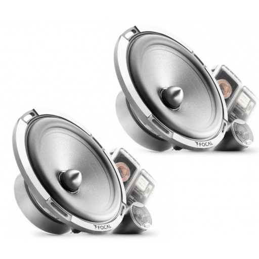

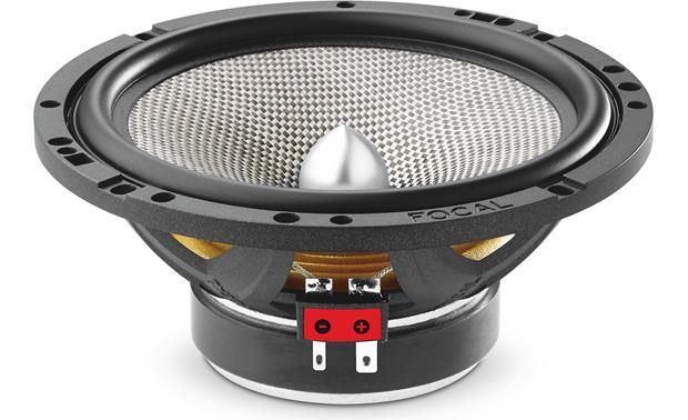

I think I will go for these: Focal access 165AS,
http://www.caraudiodirect.co.uk/speaker ... nt-speaker
They seem to do well in this review and seem about half of the price.
http://carspeakerspro.com/reviews/top-r ... -speakers/

Thanks :) I must confess that in the end I went with the slightly better Focal PS165's .... I couldn't resist :lol:

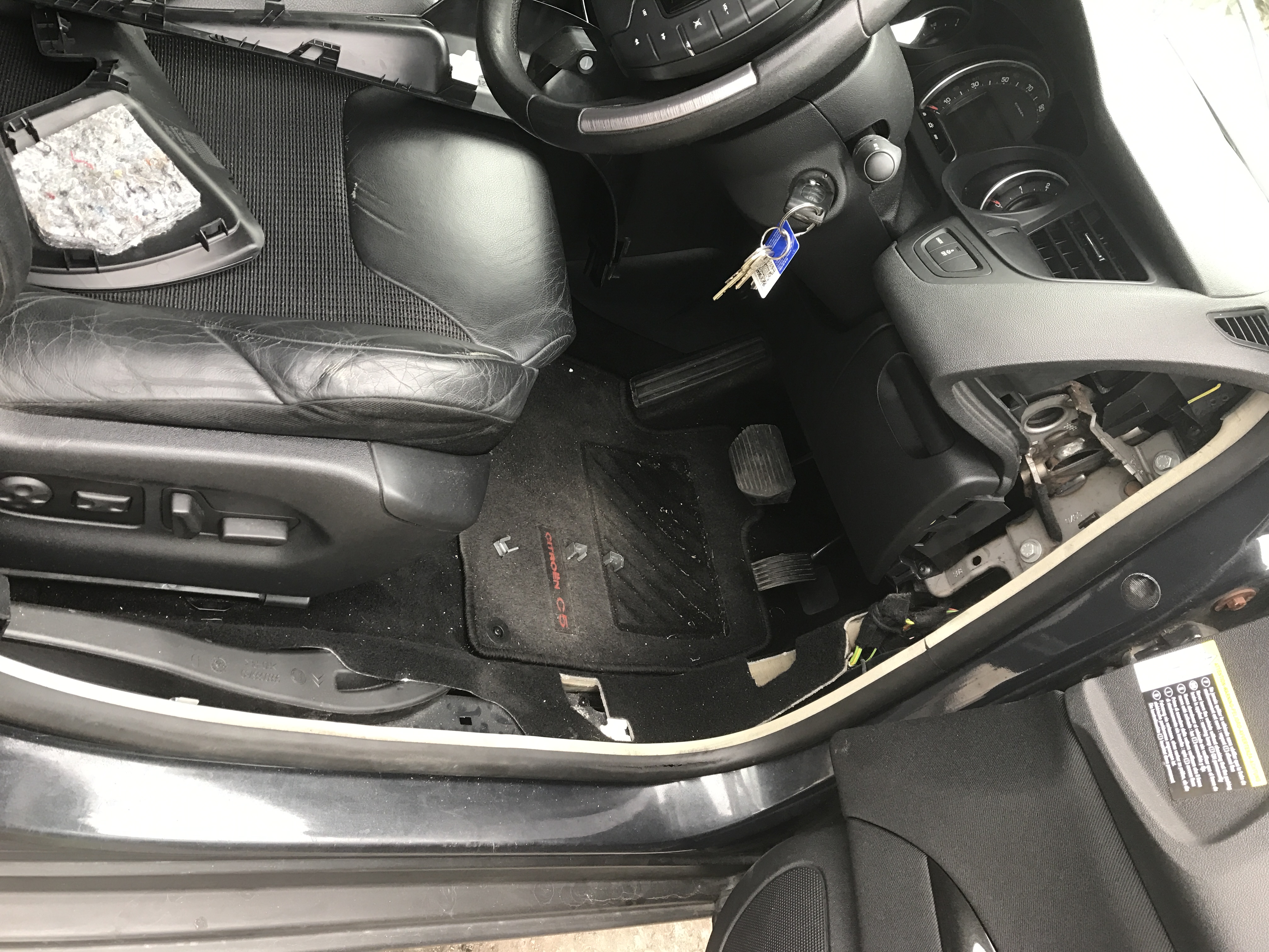

Well lads.... it's been a long day, I started around 1:30 so it's my own fault but I've only just finished....
So, heres how it went.
First off, wrestled the trim off, luckily only managed to bust one clip so I'll take that as a victory :lol:
Notice the cable trays all ready and waiting for my cable.... It's as if the car is trying to help me....

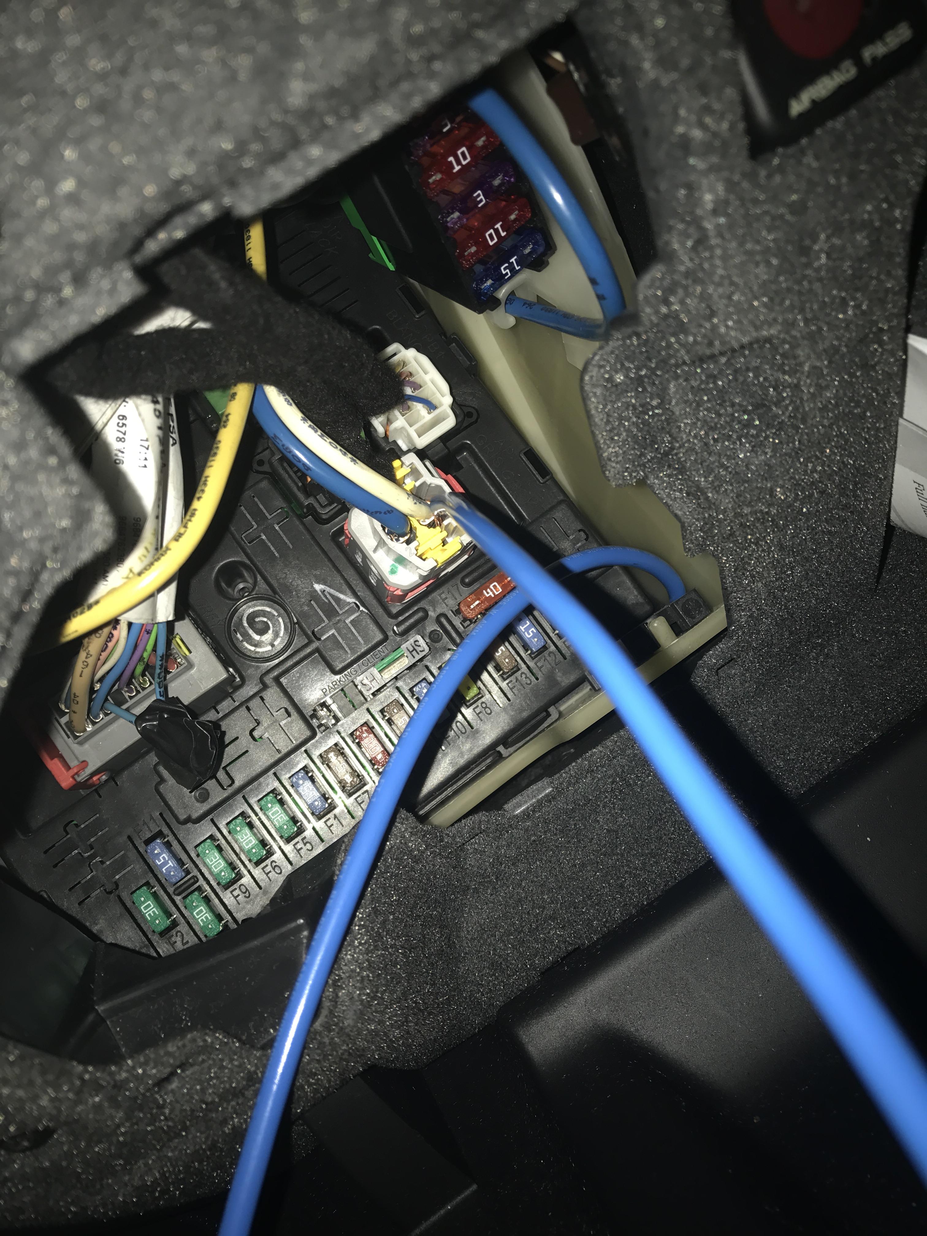

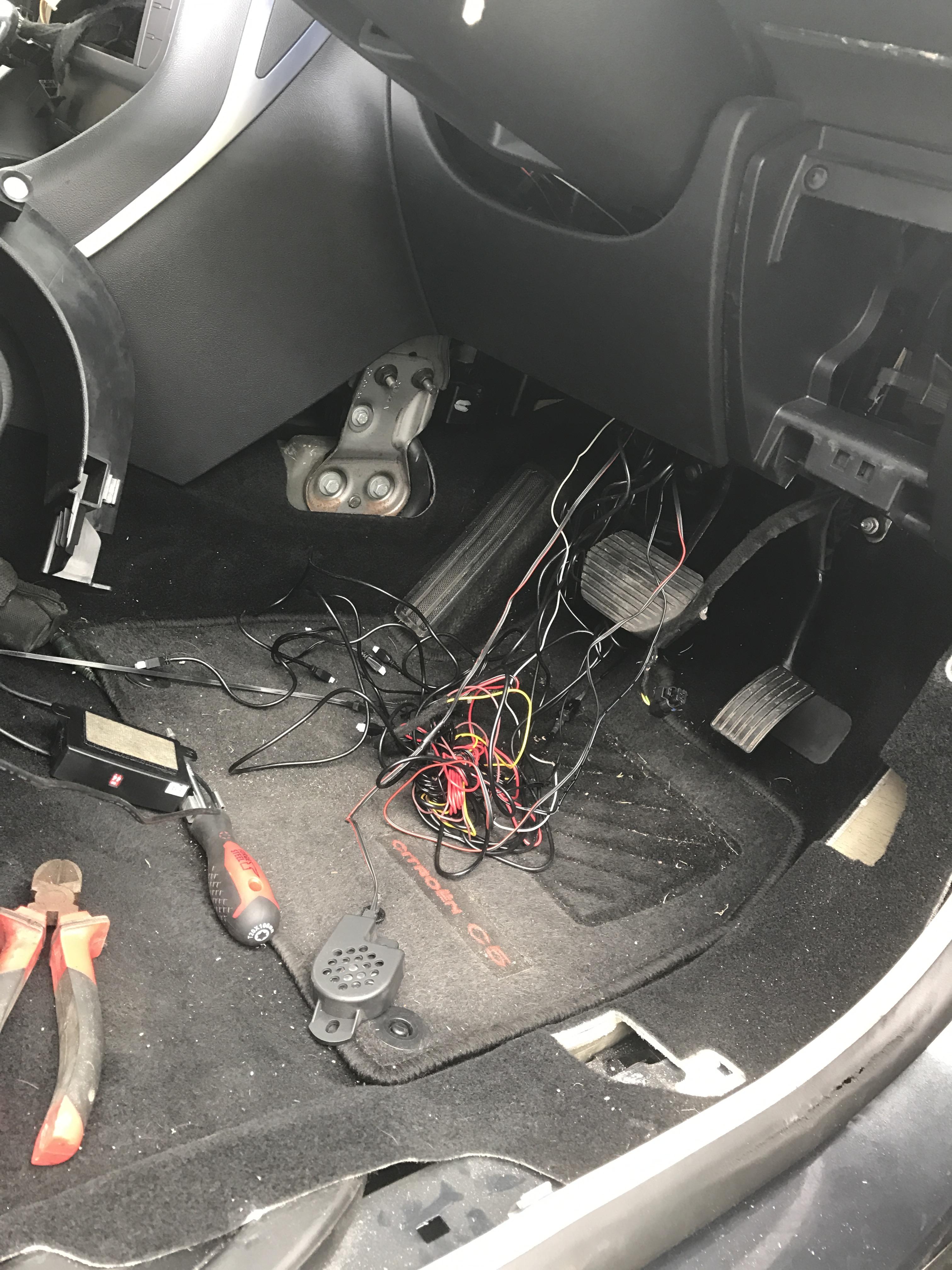

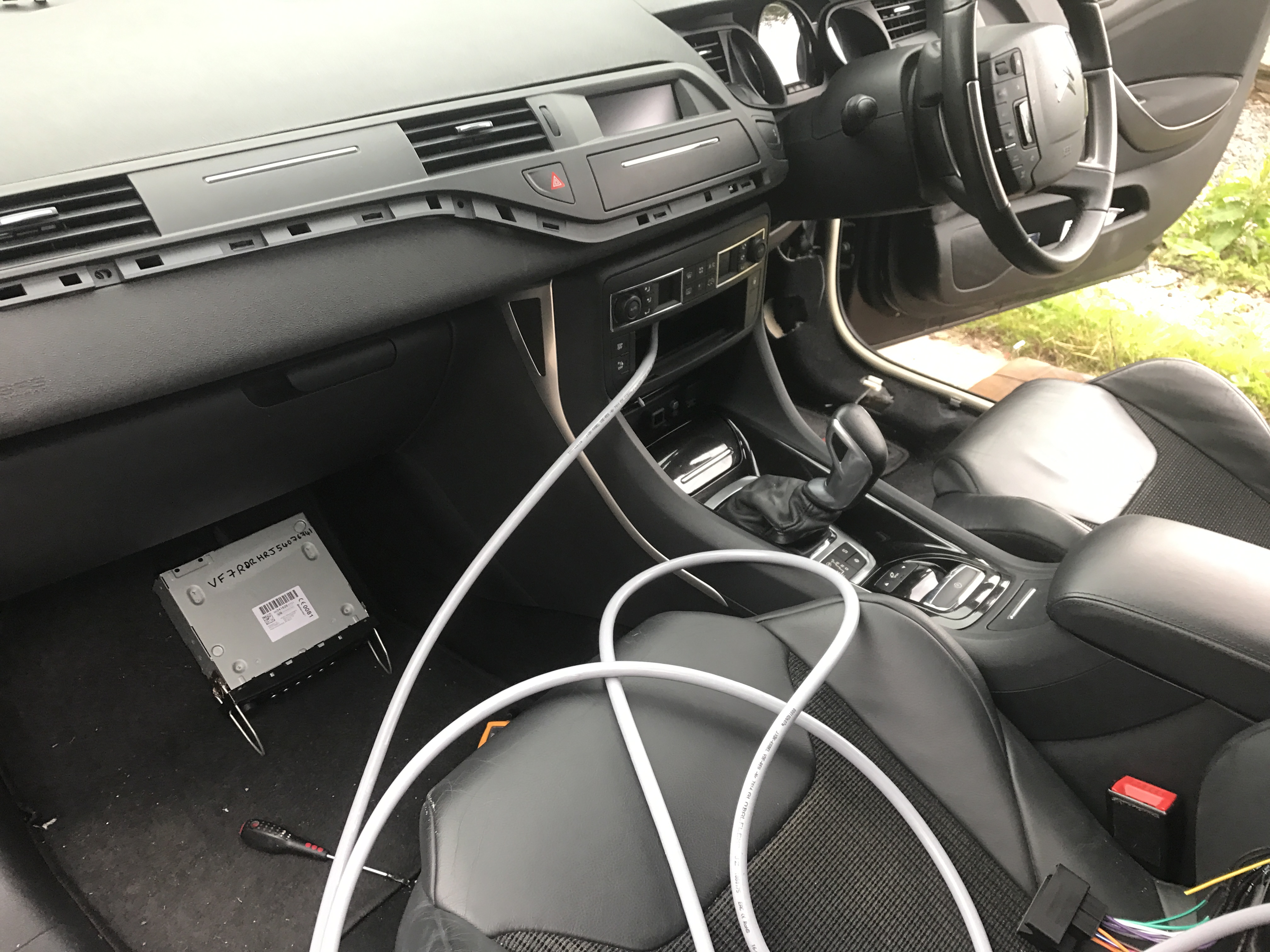

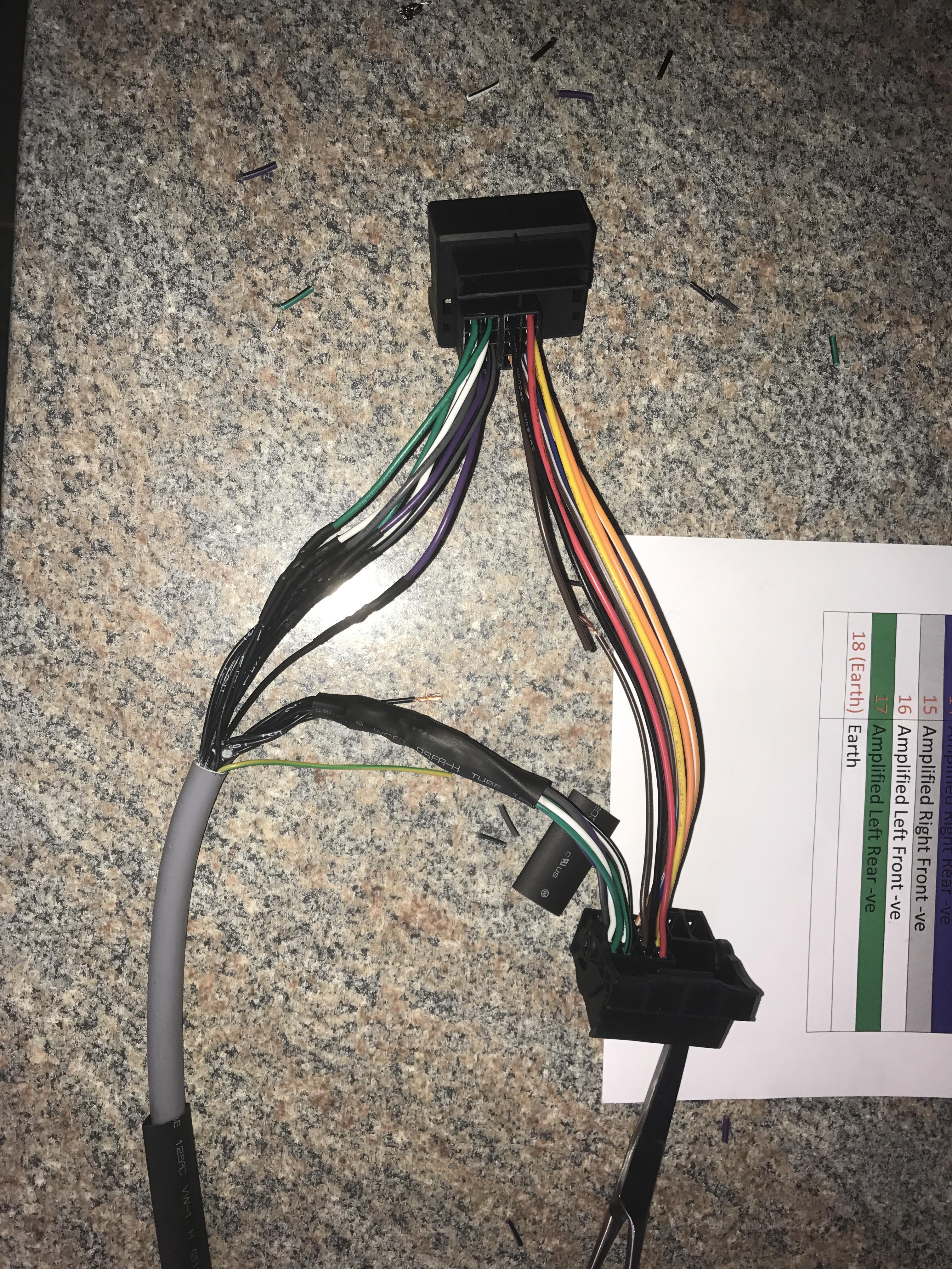

Then on to creating the main cable harness. I soldered the 8 speaker wires from the head unit and also the 8 return amplified cables in line with the quadlock extension I had.

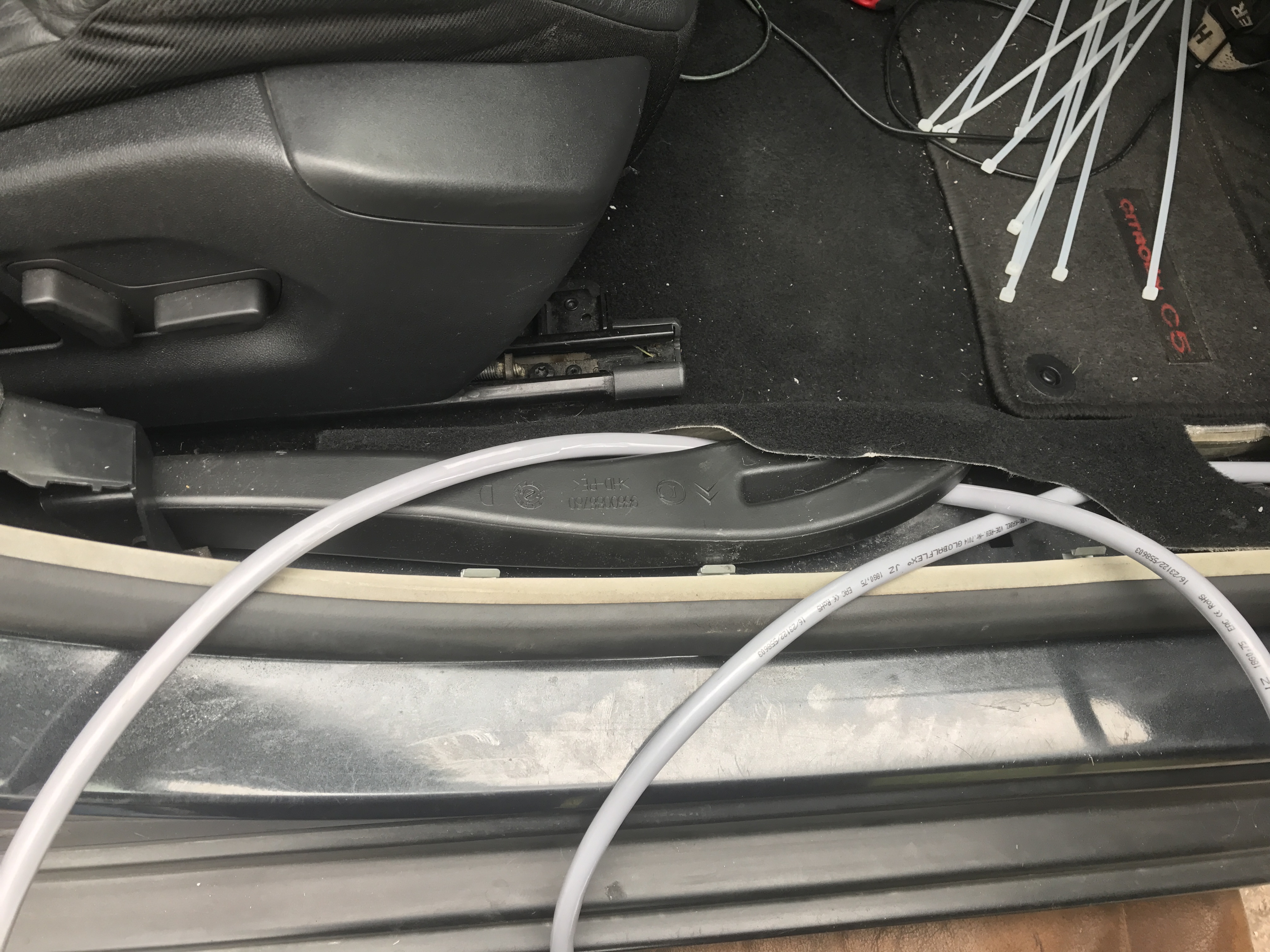

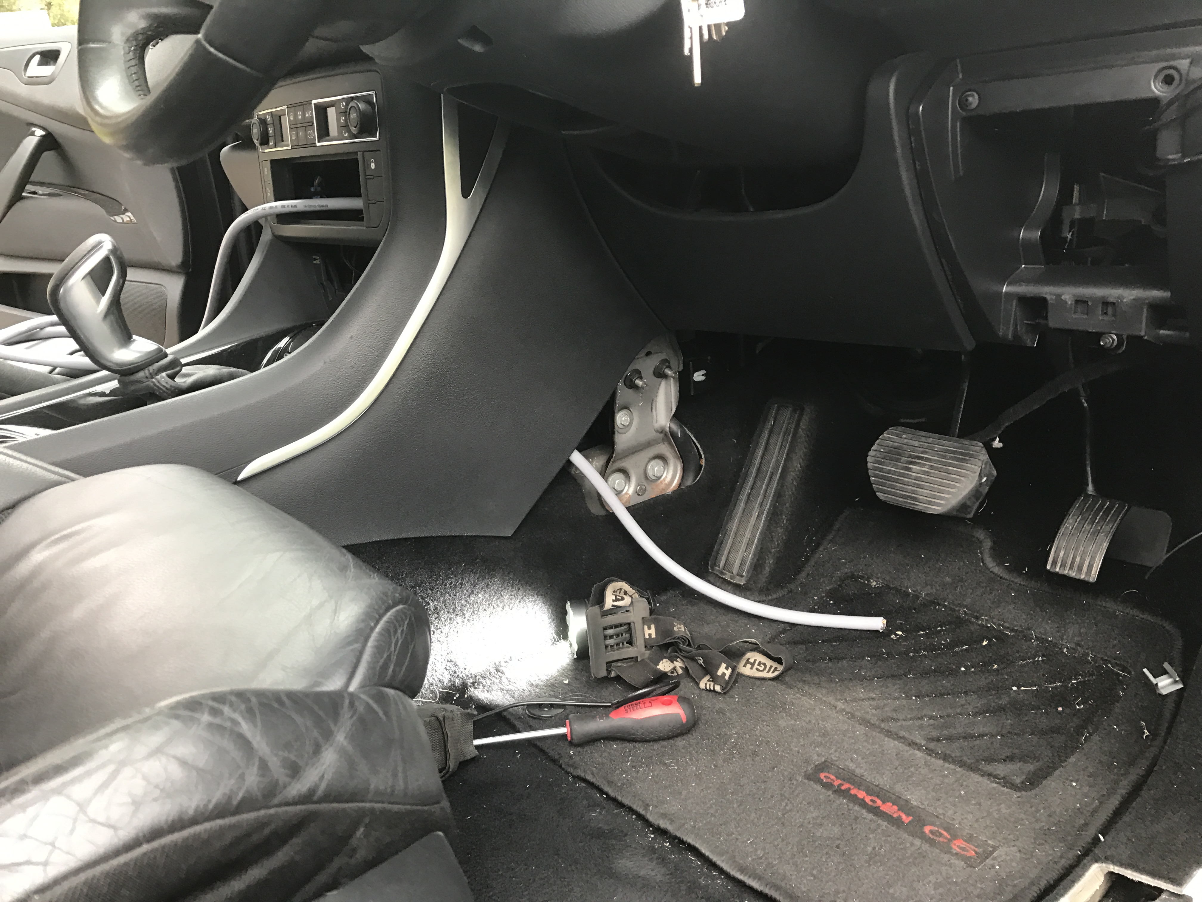

On to the feeding of the cable: I tried many ways of getting from the radio cavity to the area behind the steering column but it was almost impossible.... In the end I managed to squeeze it down the side of the console following another loom cable.
I reeled it through and then began routing the cable through the sil cable tray to the boot area.
Perfect fit! :P

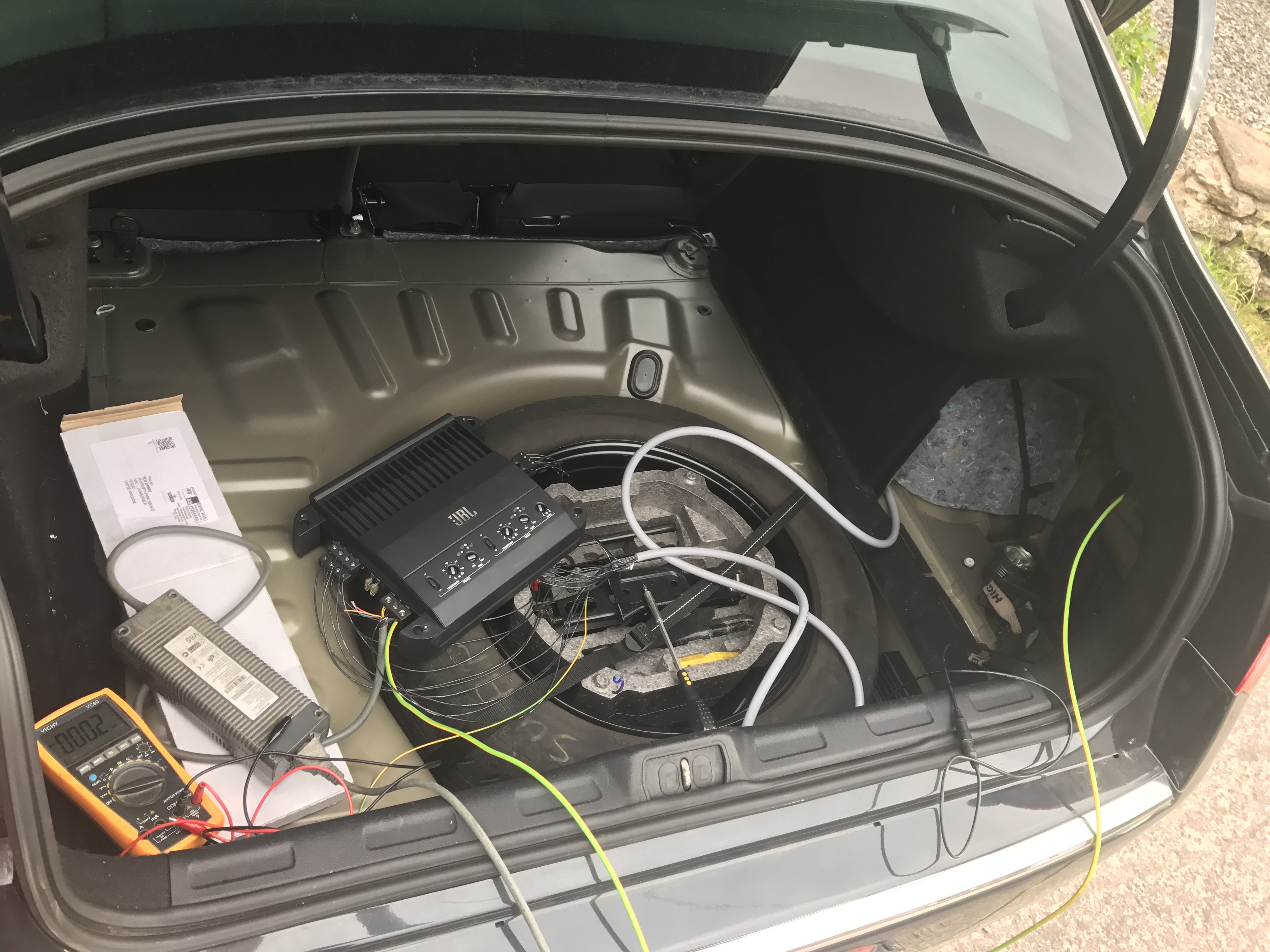

Quick test with an old Xbox 360 power supply and everything seems to work... sound significantly better, even with the stock speakers.

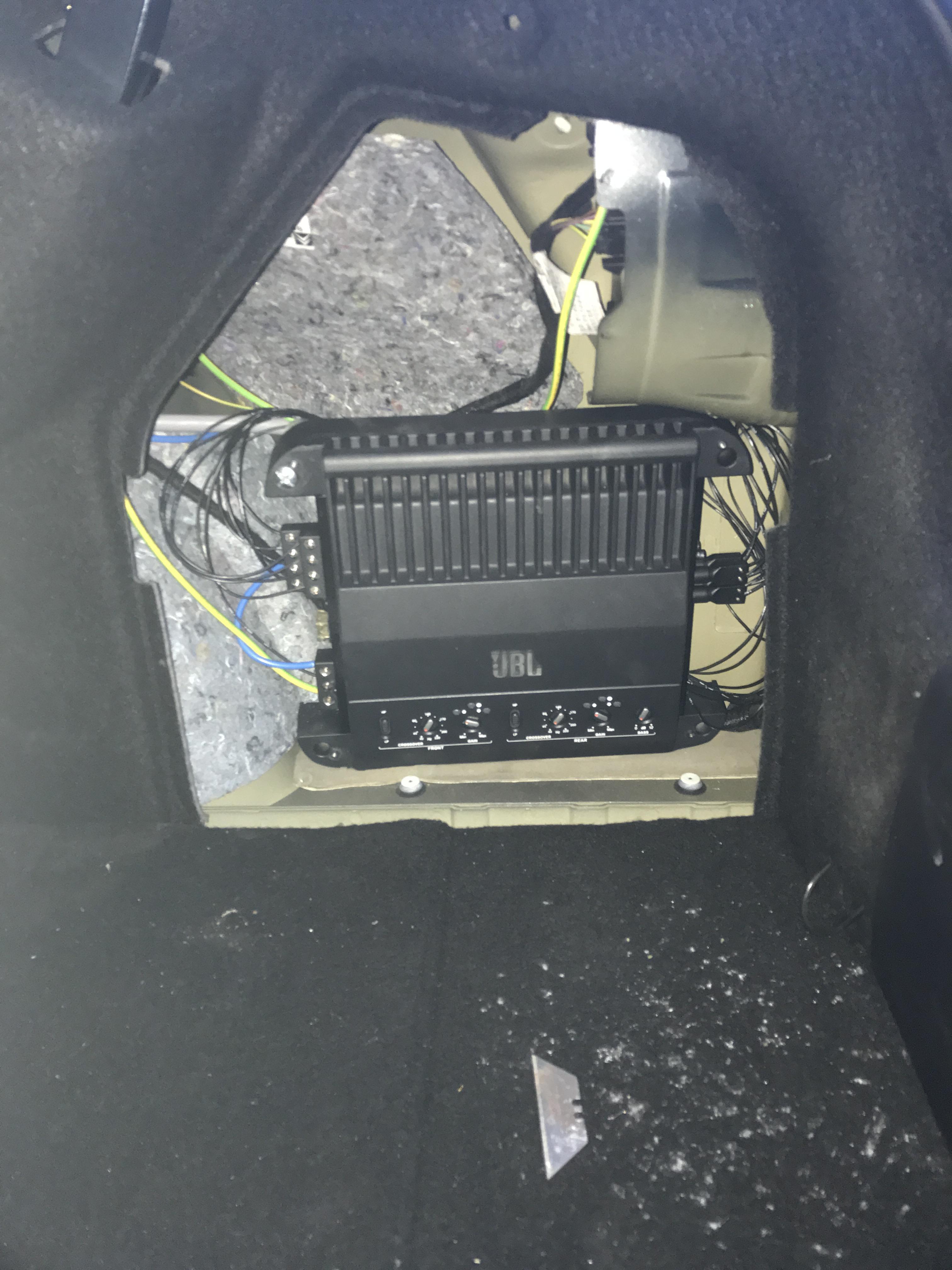

On to the mounting of the amplifier... not many pictures here.. it was getting dark and I was getting tired :(
I made a bracket that attached to a piece of stud already in the cavity. I also used foam to support the Amp... I know ideally it needs more support but that’s all it was getting....
So after stuffing the head unit back in ( took a while to wiggle the wires to make room for the quadlock extension) I terminated all of the wires again.
