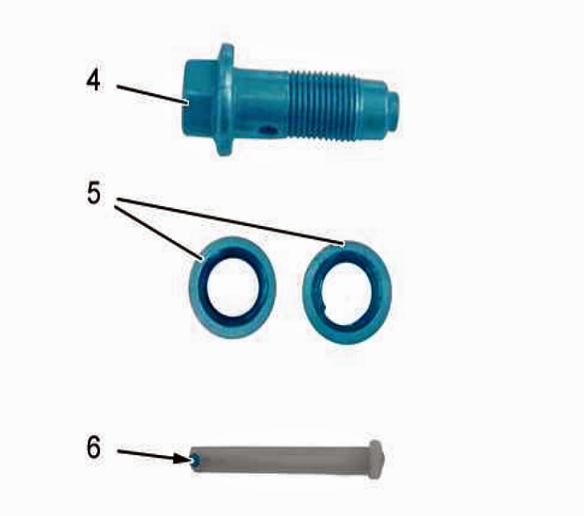

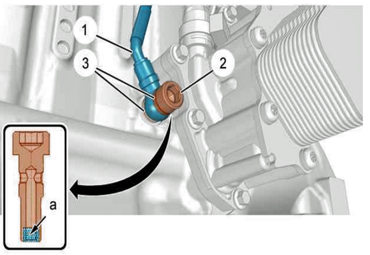

Re: 1.6 Hdi / DV4 / DV6 turbo feed modification.
Engines concerned:
Modification
Replacement of the lower banjo bolt on the turbocharger lubricating pipe with a banjo bolt that has a removable, larger-capacity, strainer filter.
Previous Assembly
"a" Integral strainer filter.
(1) Turbocharger lubricating pipe.
(2) Banjo bolt with integral strainer filter.
(3) Seals.
New Assembly
(4) Banjo bolt.
(5) Seals.
(6) Removable strainer filter.
Repair
Previous assembly
If removing the turbocharger, replace the old banjo bolt (2) with the new banjo bolt (4) fitted with the removable strainer filter (6).
Refit:
If removing the turbocharger, check the condition of the strainer filter (6).
If the removable strainer filter (6) is clogged, replace the assembly of bolt (4) and removable strainer filter (6).
Refit:
- DV4 engines all types
- DV6 engines all types
Modification
Previous Assembly
(3) Seals.
New Assembly
(4) Banjo bolt.
(5) Seals.
Repair
Previous assembly
Refit:
- The banjo bolt (4) fitted with the strainer filter (6)
- The seals (5) (new)
Refit:

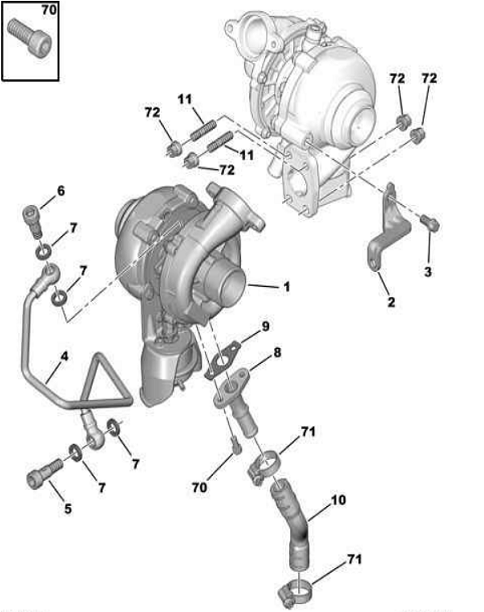

It's the lower banjo bolt that has the modified design, so I can't say if you can access it or not on your vehicle. It is shown as Part 5 on the diagram below:

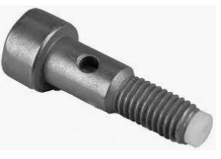

There's no date on the modification info - but the part was replaced from the date I mentioned in my last post.
Basically the reason some people remove the filter is because on higher mileage cars, especially where the servicing has not been kept up, or where the oil has not been changed at shorter intervals than recommended, there can be debris and oil contamination in the oil that can block the small filter in the banjo bolt, causing oil starvation to the turbo.
So it is probably a matter for each owner to decide.
I know that Garret recommend removing the filter for this reason on higher mileage cars. They have a video on it here: 6:28 is the time index where they show this:
Here's a picture of the modified bolt - you can see the plastic filter in the end:
