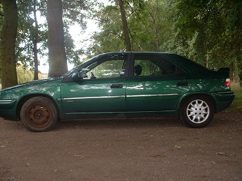

Side view showing the latest adjusted height front and rear. Visually much better but the ride is still a little harsh :?
The ugly spare (rust/steel) wheel was on for a few days but I will have to swap tyres over as the wheel doesn't have the 'spigots' required to sit flush on the hub (makes an awful noise) had the car just over a year now and only just found that out :roll: Xantias a life experience ....
An illusive rumbling / rattling sound is still hiding somewhere around the drivers/passengers footwell area, which if anyone remembers was being investigated when SWMBO burst the front suspension pipe earlier on in this thread/blog (probably the hardest thing to describe to anyone reading but I will try :lol: )
The sound varies in volume between a bearable but annoying, metallic loose hydraulic pipe in the engine bay to a louder 'driveshaft is about to explode' noise #-o
If it was on full steering lock I would be inclined to think it's driveshaft related but the noise is there even when coasting out of gear / clutch fully dipped / steering straight ahead, which I think eliminates engine mounts / driveshaft and intermediate bearing / gearbox / clutch.
I'm leaning towards roll bar/suspension arm bushes but wouldn't expect to hear the metallic noise from those :?:

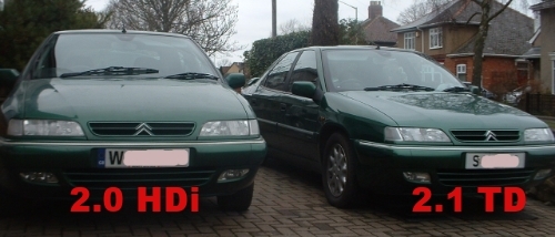

Plan was to make one good car out of the two but unfortunately the shopping trolleys were more like baseball bats :^o I know it's all about opinions
So new plan will be to probably run the 2.1 until MOT/insurance is due (July) and then swap some bits over and flog the 2.1
The newer car is a HDi which looks solid underneath and rides well BUT is pretty rough mainly nearside bodywork
If anyone wants a decent low mileage (98K) 2.1 TD engine/box then maybe we could do a deal :?:

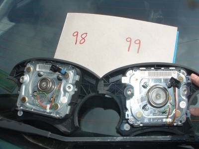

Steering Wheel and subsequently airbag swapped
For reference a 98 drivers airbag will go into a 99/00 steering wheel but not the other way around #-o
NOTE 4 horns on rear of airbag (2 indicated) although it only seemed to be the lower horns that prevented flush fitting - airbag clip on connector is similar and fitted OK
