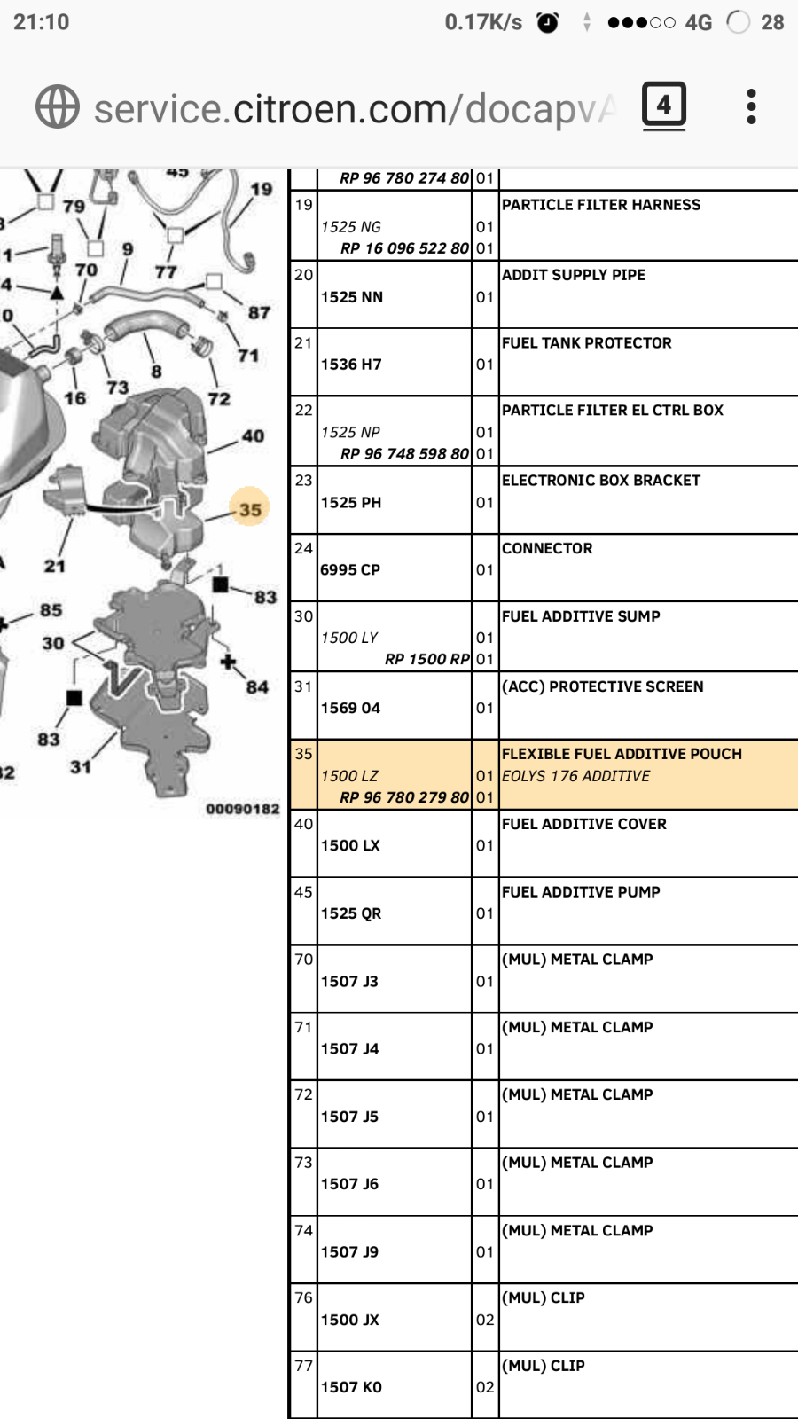

1500 LZ is a part number for old pouch. As far as I know it's out of stock, it was about £150 at Citroen.
New part number is 9678027980. It's over £350. According to citroen service instruction you are supposed to use proper part number as replacement.

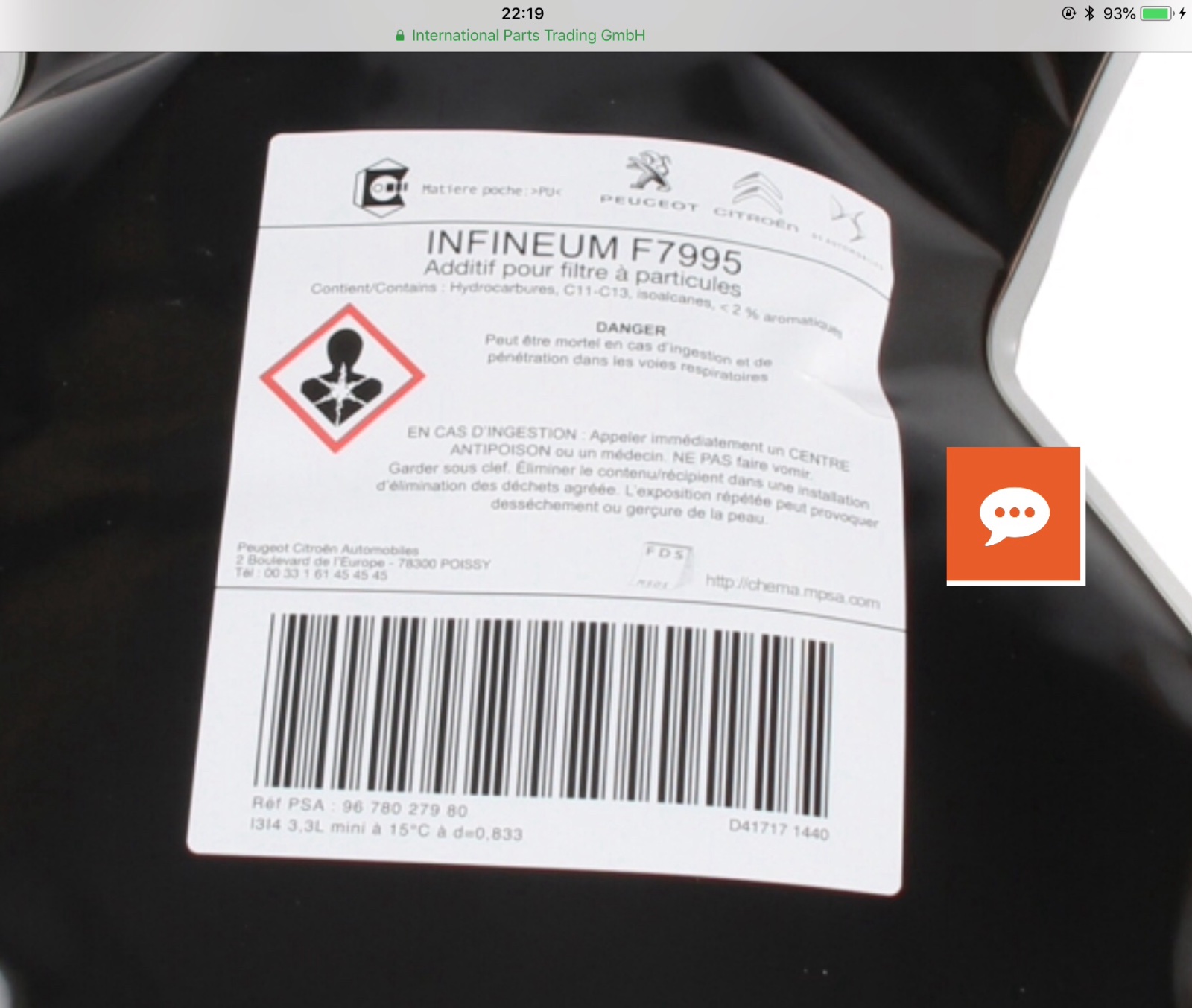

RichardW wrote: 21 May 2018, 20:23 I think the later pouch is more expensive by virtue of the additive rather than the volume - data suggests that it will use >3l over 75k, so a 3.3l pouch seems about right (not sure where you saw the volume, Marc?).
9678027980 Is the reference the OP linked to Richard, and if you look closely on the package, bottom left of the photo below, you can just see the 3.3l. You have to be an eagle eyed Eddie to see it otherwise :-D
