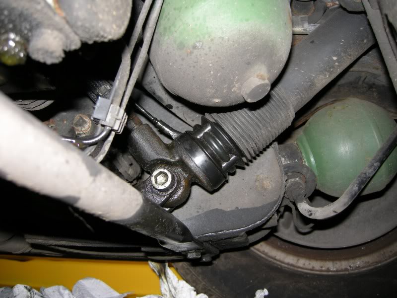

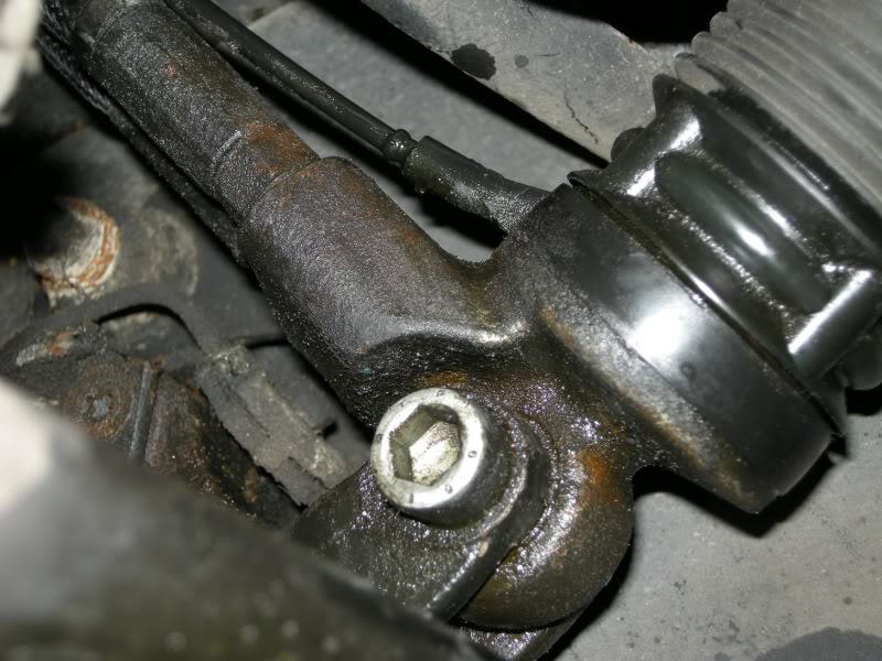

Here's the pictures of the ram on my Activa:
The 4 post ramp doesn't half make jobs like this a doddle
If you lift the plastic cover on the bottom of the ram it is bone dry so I'm guessing that it's the return thats leaking.
The flare on my return pipe sticks up a bit like you can see in the pictures, it isn't right into the rubber part of the ram. I'm wondering about putting some sort of compound round it to try and seal against it.
