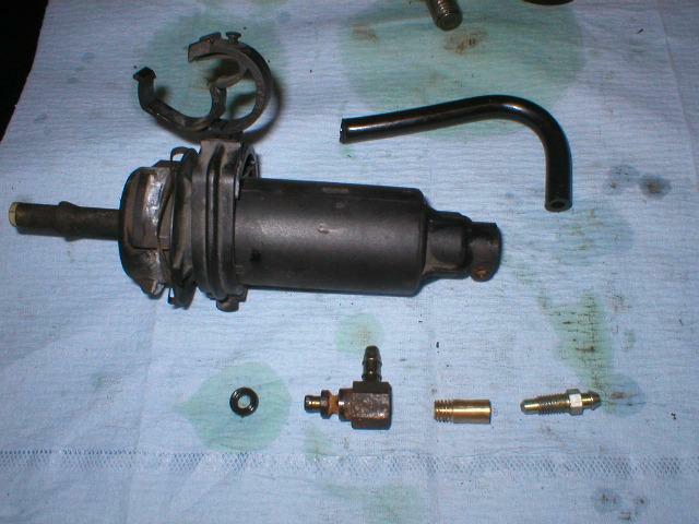

I've just engineered a bleed nipple in the right-angle feed to the slave cylinder like this:
Basically it's an M6 bleed nipple in an M8 to M6 brass reducer. Tap an M8 thread into the back of the elbow and assemble.
Any small engineering shop should be able to make this up.
You can cut the elbow off the end of the pipe and after trimming and heating the pipe end, rejoin it back onto the barbs of the elbow.
Pictures:
This was just a very rough and quick demonstration of an idea. Given time, a neater job could be made.
Hope that helps with another idea...

I made a very telling discovery this evening. I removed the slave cylinder from my project Activa to measure how deep the clutch fork is from the face of the slave cylinder boss. It's 2 inches.
Putting the slave cylinder back in I made a big, bad discovery and very nearly wrecked my own slave cylinder. Good job the Activa in question is a project :twisted:
Basically, it's very easy to get the pushrod misaligned so that it ends up not sitting centrally in the cup on the end of the clutch arm when you replace the slave cylinder. It can easily fall off to one side and then, when you operate the clutch, the pushrod will simply travel further down the side of the arm by the cup and move out at an angle. This will push the front of the cylinder out and it ends up looking like this one of Dave's..
(Dave, I hope you don't mind me borrowing your picture?)
The clutch pedal will end up on the floor if this happens...
The front of mine had not pushed right out and I could pop it back in using a deep 24mm socket as a mandrel. It ended up at an angle.
The task of replacing the slave and getting the pushrod to sit centrally in the arm cup is a difficult job. The pushrod is held in a plastic tripod when new and this breaks on first application of the clutch. This tripod is essential to guide the pushrod to sit in the proper place in the middle of the cup. You can see the remains of it on a used slave cylinder.
I did manage to get mine popped back in and thankfully I still have a clutch although a bit of fluid did spill... It may still not be 100% good. It was a hell of a job and it was more by luck than judgment. Tomorrowe I'll see if there is a better, more reliable method.
It does seem though that even if the front of the salve cylinder does accidentally come out, the use of a 24mm socket as a mandrel does seem to more or less successfully push it back home.
That, I bet, is what happened originally to yours i3 and what initially caused all the grief. I would further wager that in all your subsequent attempts, you do not have the pushrod properly sitting in the cup but rather off to one side of it. Until you can guarantee the pushrod is sitting centrally in the cup, you'll never be able to bleed it.
