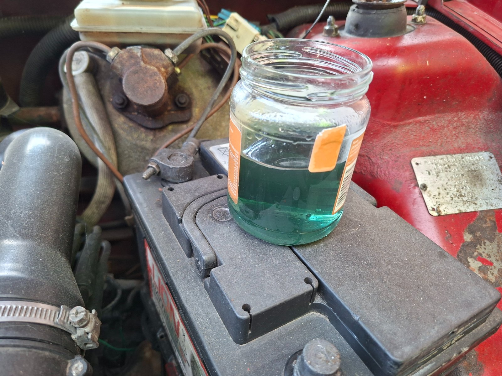

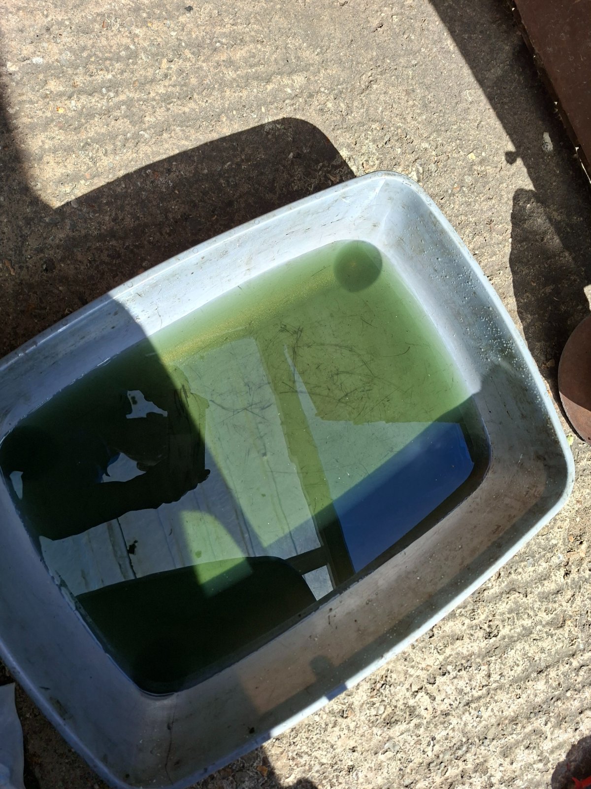

I drained the coolant. Looks very clean :)
A compatibility test with the new, just in case the old stuff was OAT or otherwise not ethyene-glycol. Happily, it seems not. Checked as it's the first time I've change coolant on this car...

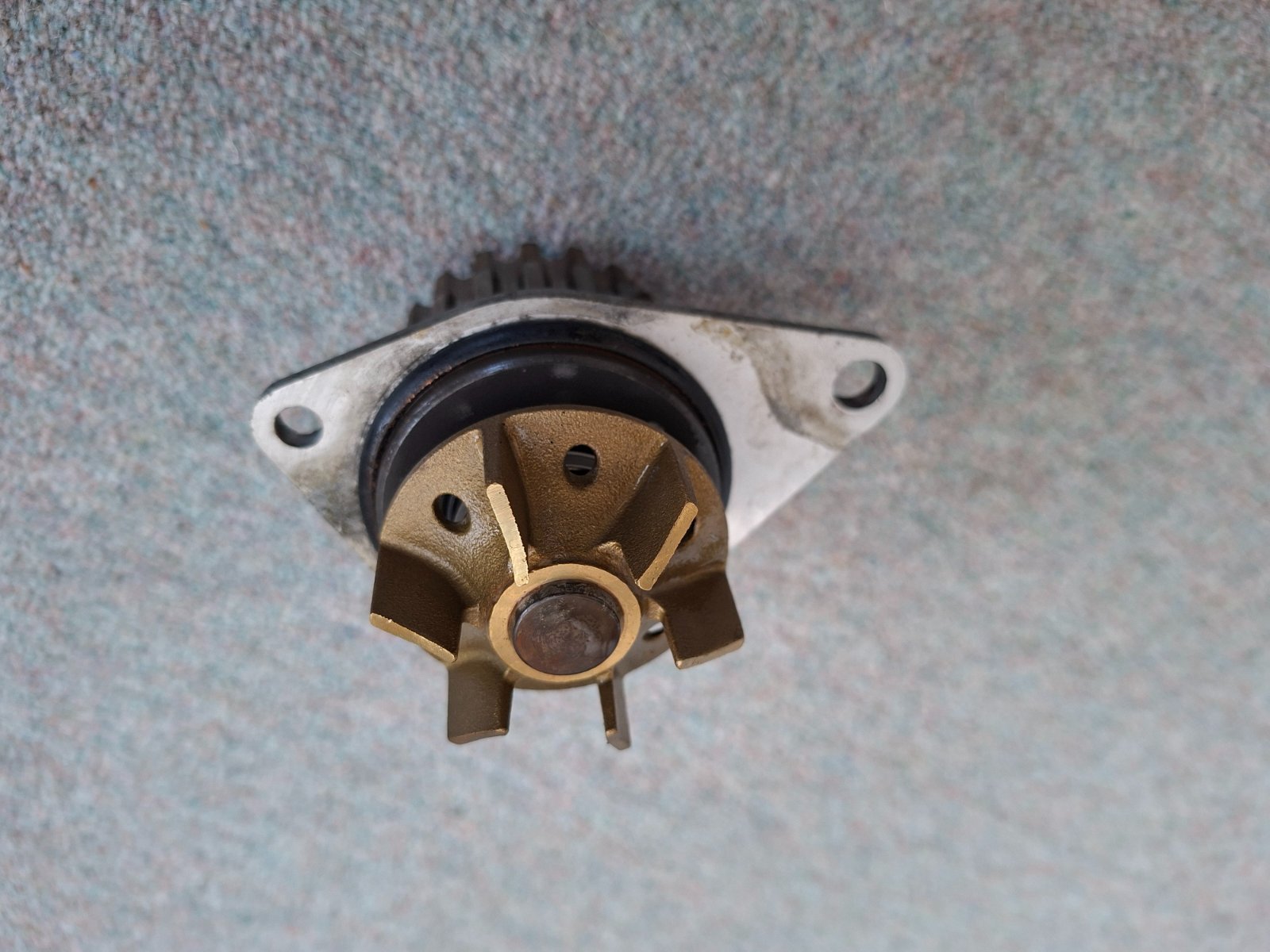

The water pump looks very clean :)

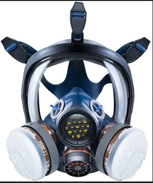

That mask is probably better quality than mine but I use one like this, from Draper I think, because I like to protect my spectacles from drips, splashes and splutters when under the car.
My safe spraying mask
https://www.ebay.co.uk/itm/316677287787
Posts: 21082
x 8091
I was close, it is not Draper but Drager, the current version looks like this:
The current product
The current product
https://www.amazon.co.uk/Dr%C3%A4ger-Re ... 1_8?sr=8-8
and is obviously expensive. Mine was issued to me by BT when I was seconded to the asbestos clearance team for Watford ATE !! :-D

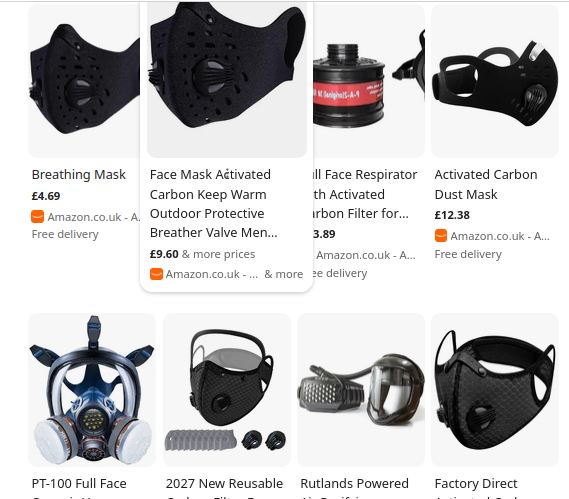

If you can I would recommend a mask that incorporates an activated charcoal filter as it is a vapour giving you trouble. I have found them to be very useful, following Covid. I had a stack of them here but can't find them and having difficulty with replacements.
These are the N95 paper/fabric masks, not the WW1 gas mask type, a bit much for going shopping in.
Like this:-
A search for "activated charcoal breathing mask" reveals a variety of them.

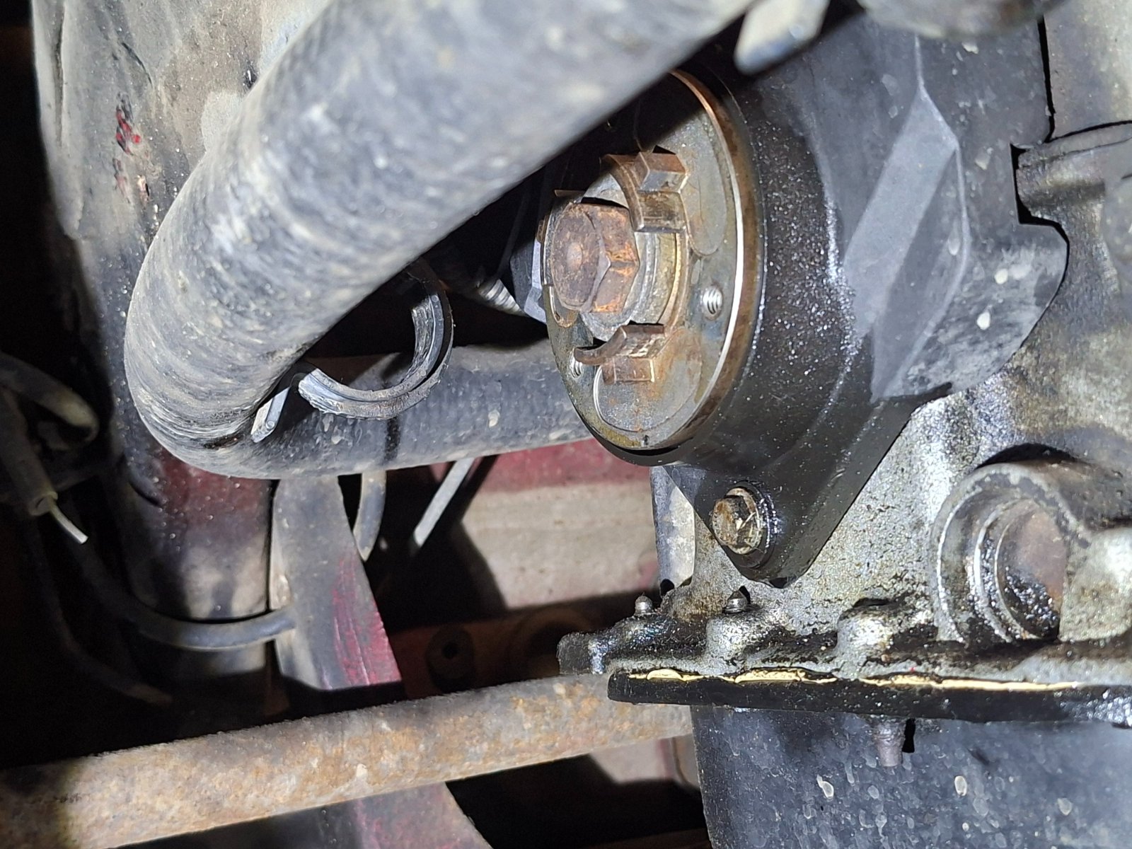

The new oil seal arrived so I cracked on with Strawberry despite the record temperatures prevailing; it's quite shady under my carport so ideal really. That carport has been, without doubt, one of my best automotive investments ever :D

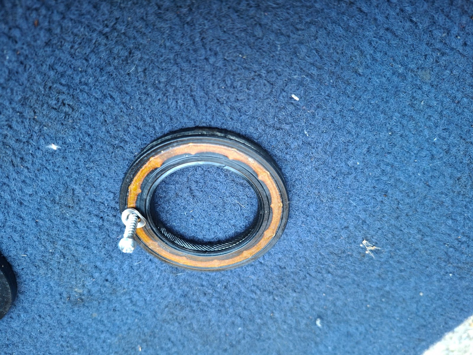

The old seal came out in the traditional way:

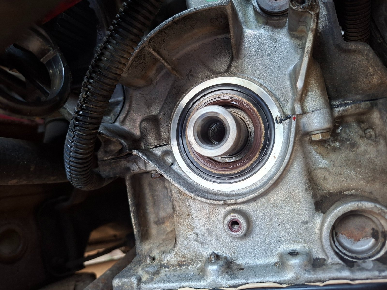

In with the new:

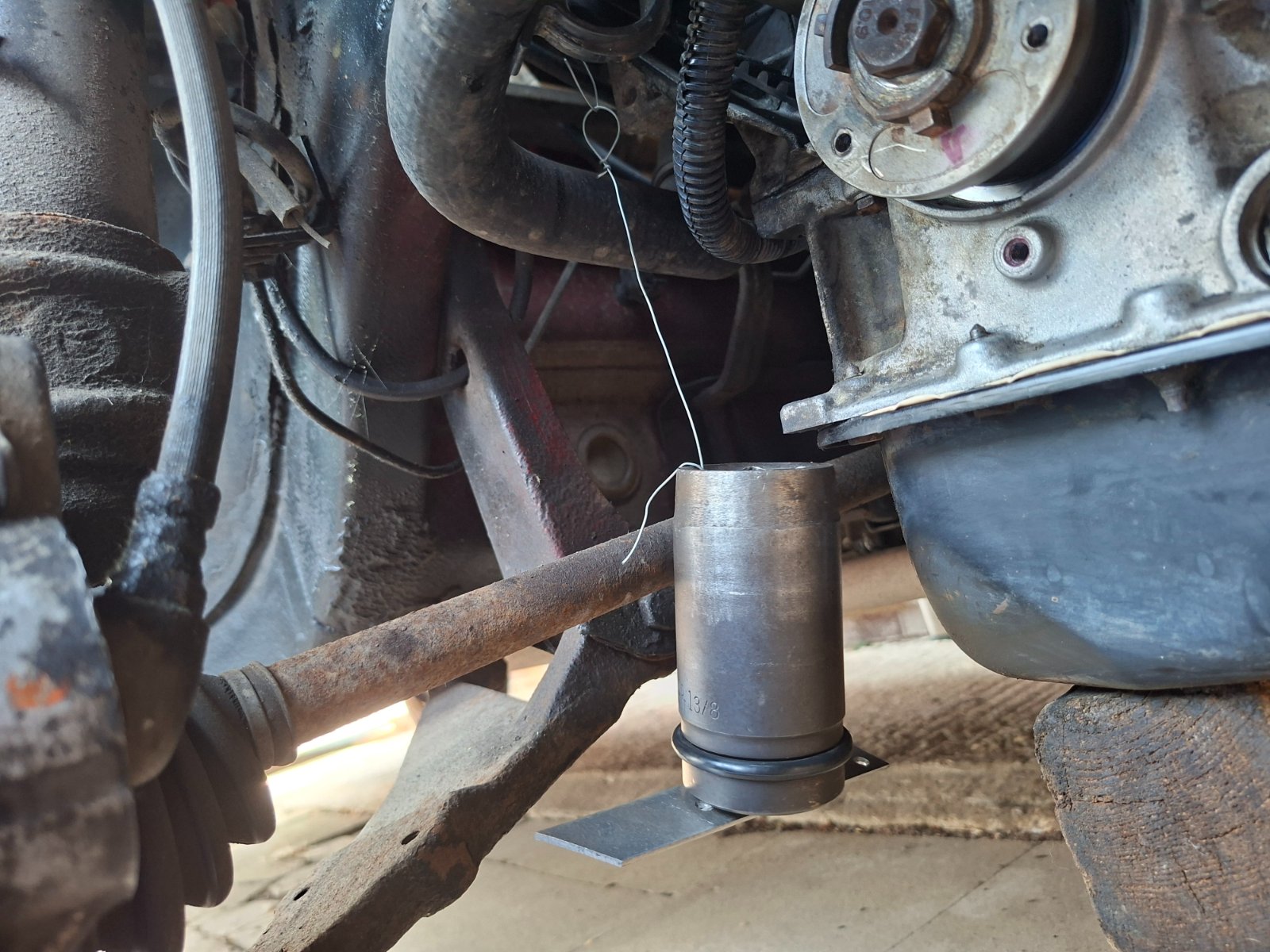

Setting the cambelt tension is a weighty job on these engines...
I make up the 1.5Kg weight on a pair of kitchen scales by adding a series of smaller sockets to the big one :)
In my experience, this is the only way to reliably and accurately set the tension.

One small issue is a few tiny specks of what looks like copper floating on top of the coolant in the expansion tank; the old coolant came out completely clean so I'm at al loss... Looking at the impellor of the new Gates water pump, it looks about the same colour so it just may be dust from it? Else that, I've somehow disturbed some old K-Seal in the system. Opening the bleeders certainly revealed some red coloured stains on the threads in areas where no coolant normally circulates and moreso on a spigot when I lifted the small bleed-back pipe on top of the thermostat housing to bleed the head.
There's been no coolant loss overnight so hopefully, just something to keep my eye on...

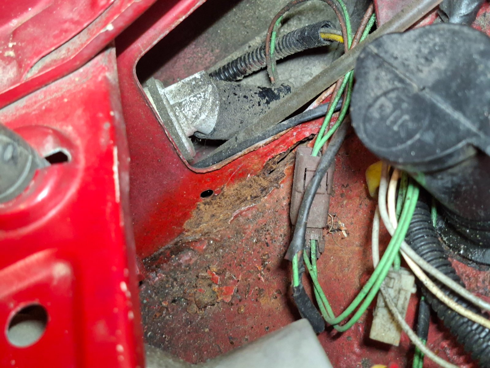

Something a little more concerning is a bit of rust on the offside inner wing; the car has had problems here in the past on the bit above the washer bottle - a known bad place for AX rust.
I don't think it's serious but definitely needs to be rectified. That's way above my abilities so I'll be looking for some skilled assistance.

CitroJim wrote: 14 Aug 2026, 05:39
Looks like that need the attention of the sparkly stick! Might be one where you can strip out the stuff around it, then get someone to come and weld it up on the drive. The hole will always be much bigger than it first appears once poked :lol:

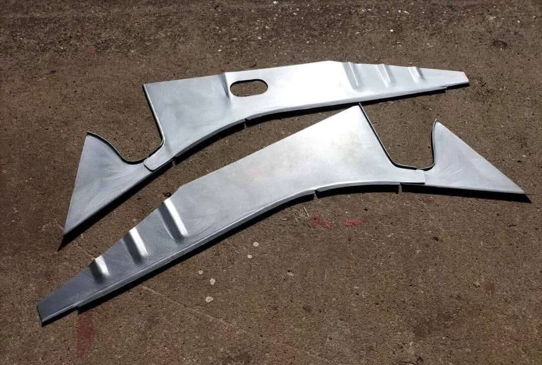

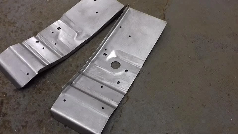

These may come in handy: :)
The top panels
The top panels
https://www.ebay.co.uk/itm/287223894073
The vertical panels
The vertical panels
https://www.ebay.co.uk/itm/287392534165
