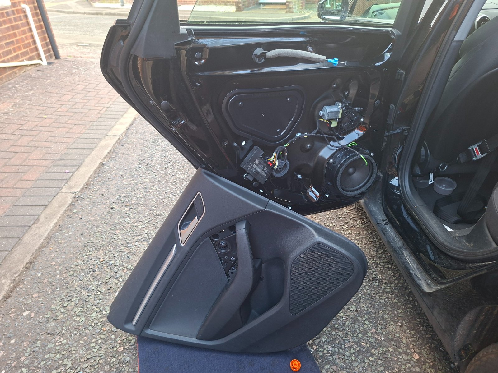

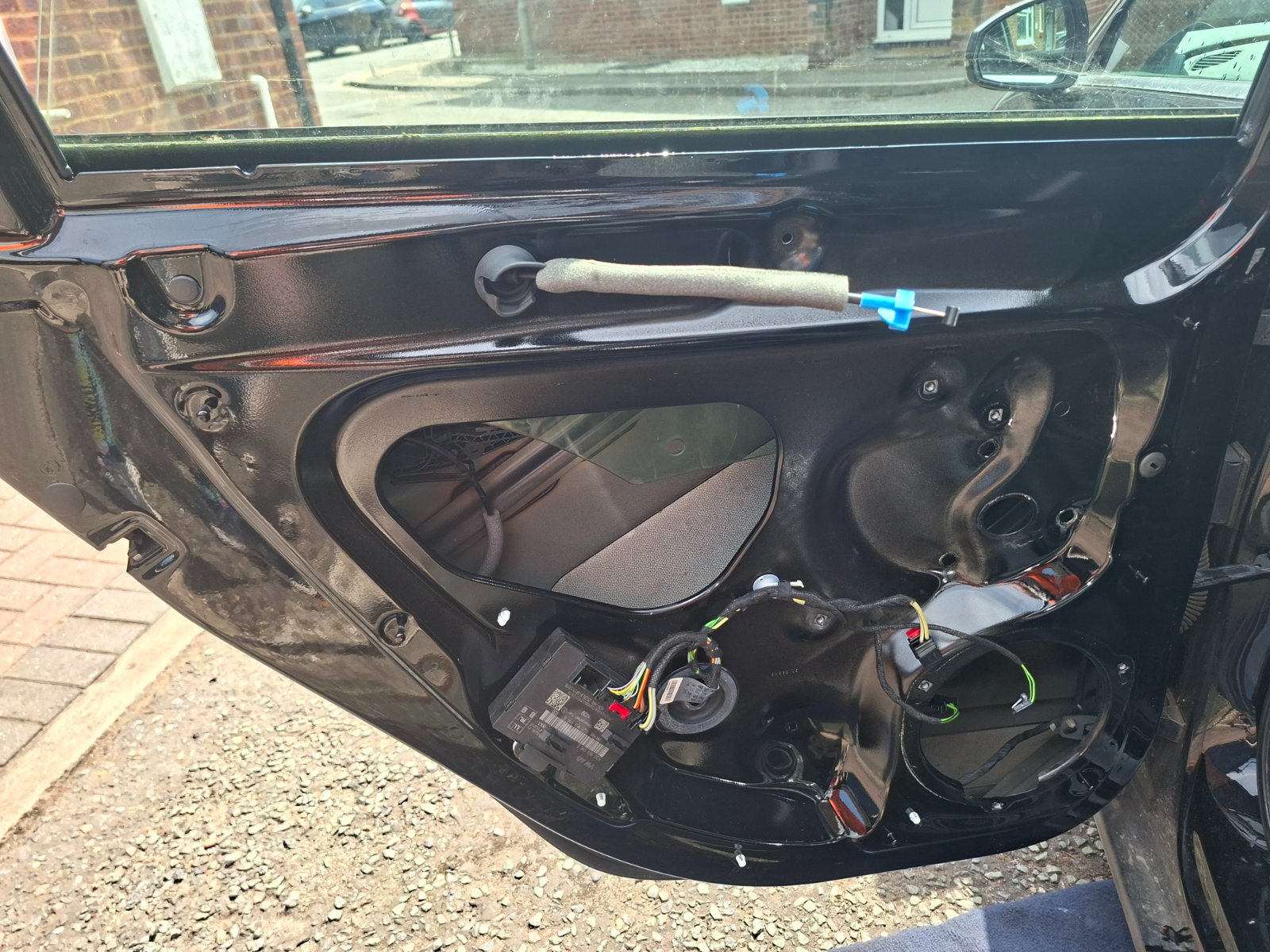

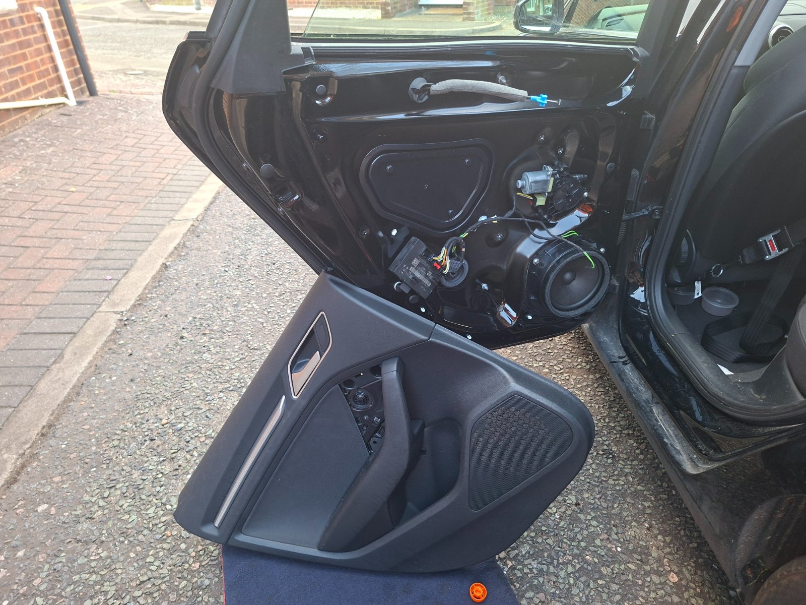

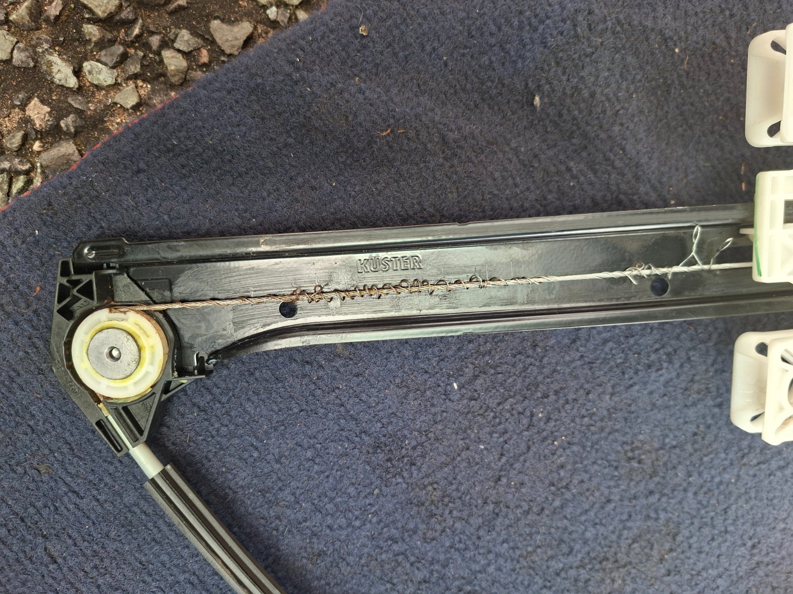

I got the spanners, amongst other tools, out on a car yesterday - remarkably, not a Citroen and not French
Autumn, my granddaughter, can now reach the rear window switch from her car seat. She's had a bit of fun with it since her discovery. That was, until the the window glass stuck half-way up and would move no further - up or down...
The car is an Audi A3 of 2016 vintage.
So, off with the door card. That was the easy bit!!!

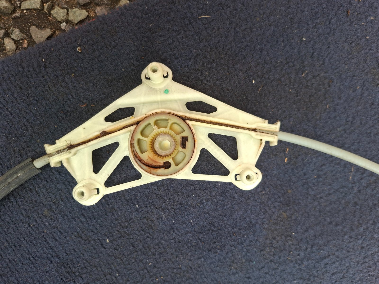

Having removed the drive motor, it was immediately obvious the problem was corrosion in the regulator drive cables so not Autumn's fault at all!

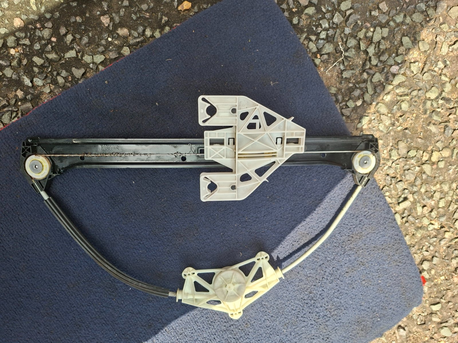

So, it was a case of removing the regulator/drive assembly. Audi never intended for the regulator to be removed with an intact window glass in place. The 'ease' or otherwise of extracting the regulator is very much dependant on where the window is stuck. Mid-way is about the best. I was lucky.
A lot of faffing about eventually saw the job done but not before the angle grinder came out to chop off one of the regulator mounting bolts and a bit of ingenuity (and in-door gynaecology) to release the clips that secure the window glass to regulator assembly

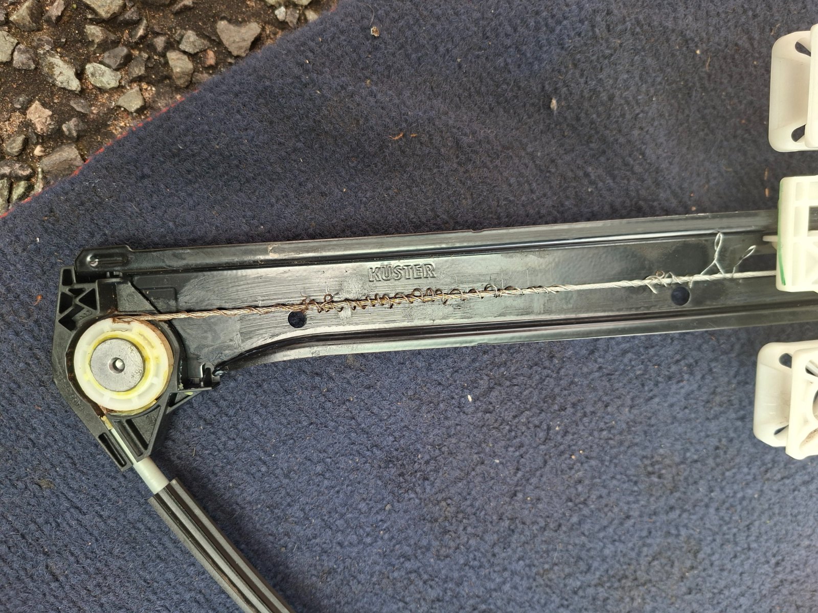

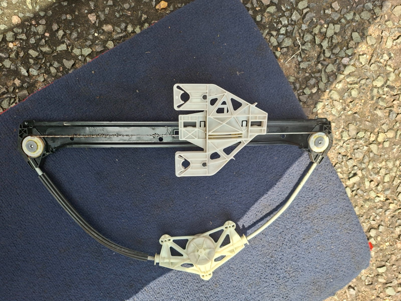

Here's the regulator showing it's badly frayed and water-damaged cables:
And the door internals just before temporarily securing the glass in the up position with a cable-tie or two.
This seems a common issue on the A3. Spares are readily available and cheap. A new assembly is les than £40 and will be a lot easier to fit than it was to remove the dead one!
The new one should arrive today.
I'm expecting to have to do the job on the opposite door at some point...

- Posts: 5364
- Joined: 25 Apr 2022, 09:03
- x 2367
Ha, that reminds me of similar job (and similar failure mode: frayed cable jamming up the mechanism) on my first car, a mark 2 Golf 5 door. One if the rear window regulators.
I don't recall great expense for the part - but was a frequent scrap yard visitor at that point (as the one near me had 5 Golfs and a Jetta, plus a Scirocco to scavenge from at one point) but I do remember how flipping horrible access was!

- Posts: 28764
- x 5679
Spray some WD40 in there and have Autumn exercise it, will probably be beneficial and grind the corrosion away.CitroJim wrote: 28 May 2026, 05:29 I'm expecting to have to do the job on the opposite door at some point...
Zelandeth
- Posts: 5328
- Joined: 16 Nov 2014, 23:36
- x 1607
Could be worse - a bunch of VWs have a metal panel riveted on the inside of the door that you need to drill out to get to anything. Ideally without putting a drill straight through the wiring loom which is helpfully right behind one of the rivets. Cheers VW, so helpful.
I've never got along with cable operated windows - they've almost invariably ended up with me very nearly smashing the window in frustration when I've had to work on them. Probably because they're about the only ones I've ever really had to do much battle with.
