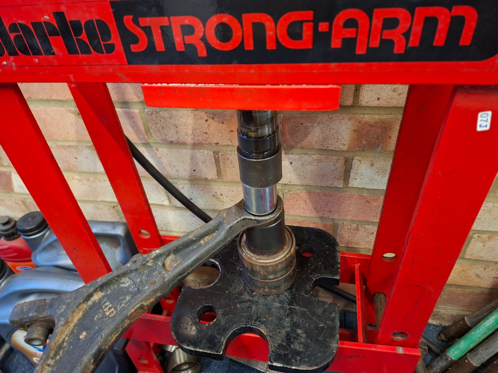

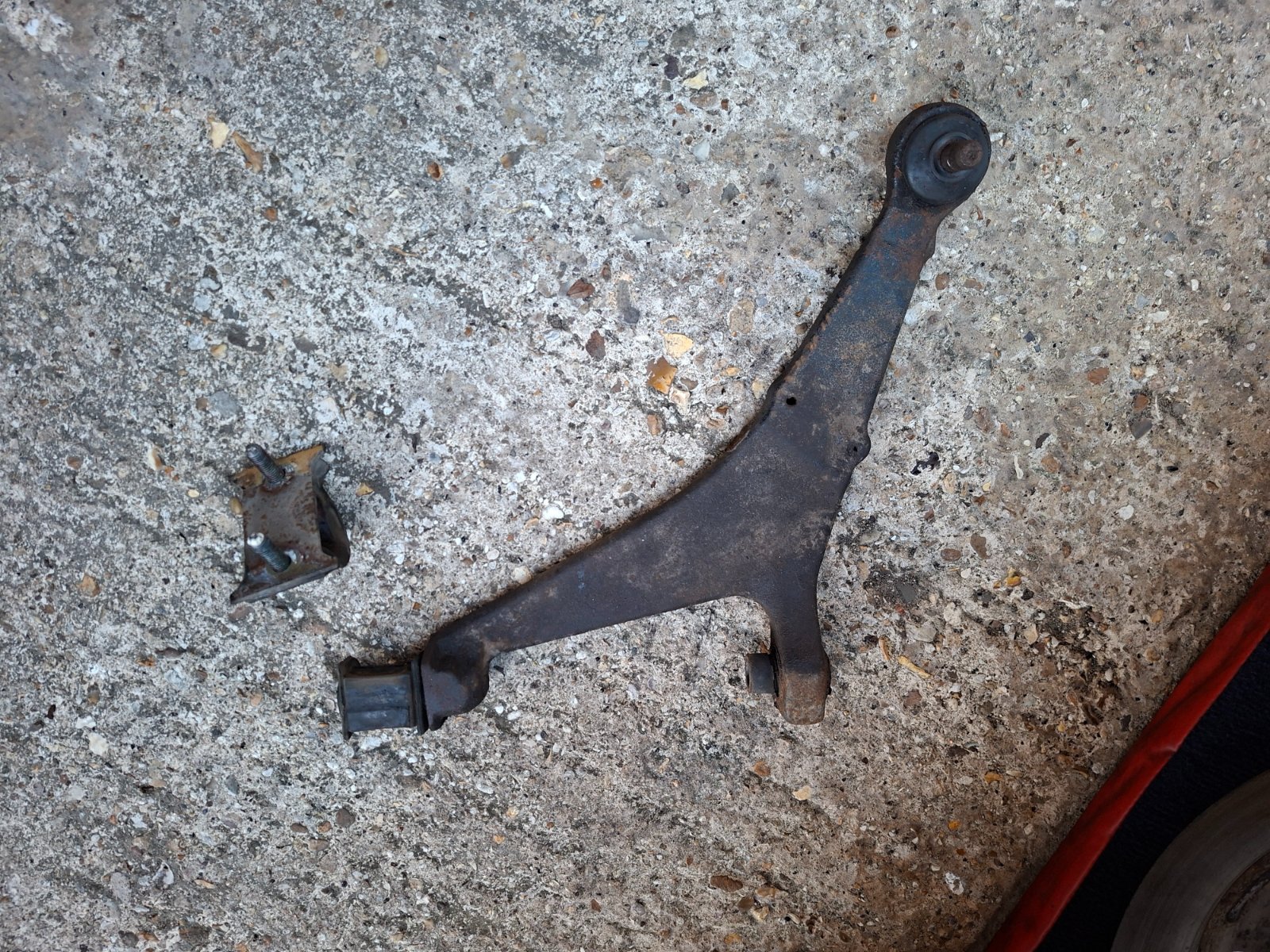

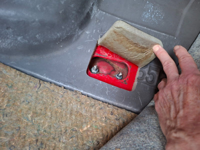

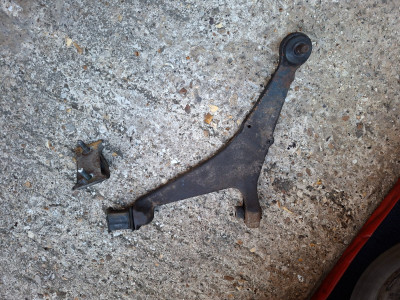

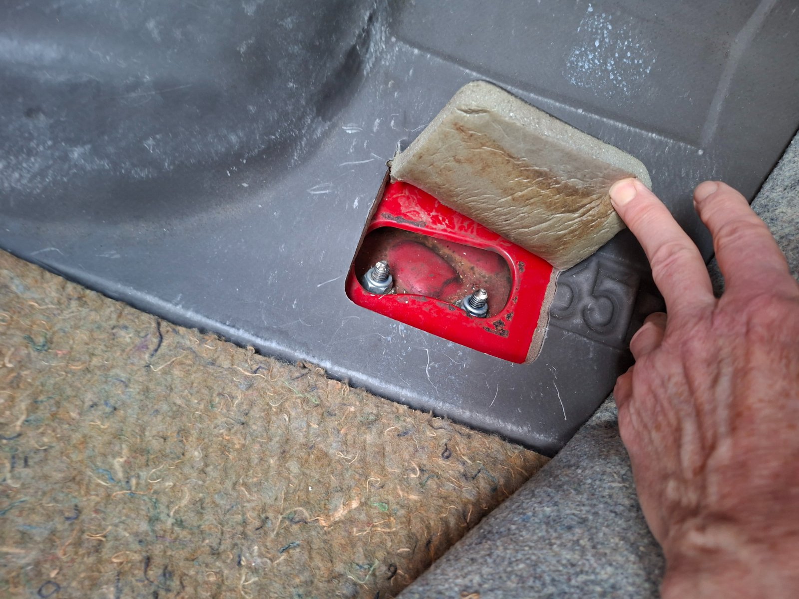

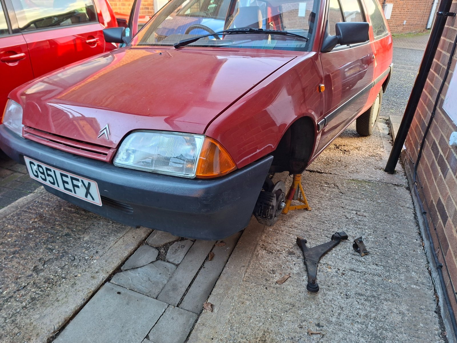

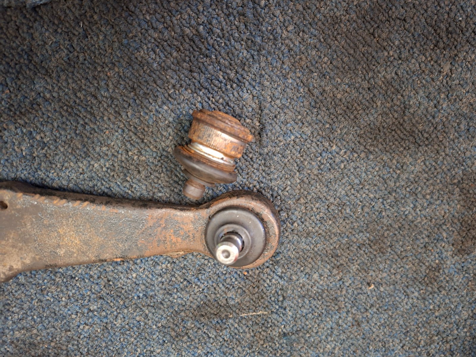

Yesterday was a very good day. After a cracker of a very chatty and social club run and given it was such lovely weather, I got stuck into Strawberry's MoT advisory.. I was a bit late to the party as I spent longer than planned apres-run in the café drinking tea and being all social
Replacing her nearside swivel joint.
All very straightforward. First job was to remove the lower parcel shelf, some trim and then lift the carpet to get at the suspension arm rear mount nuts:
I was delighted to note she's bone-dry under her carpets

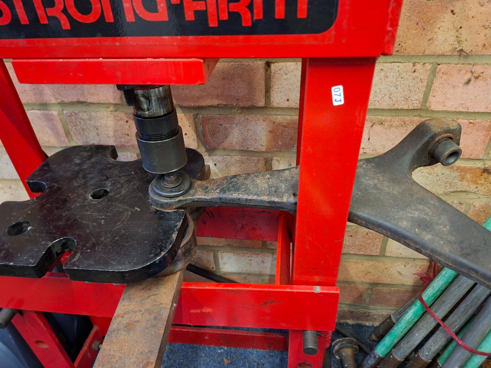

And with the front mount through-bolt out and after disconnecting at the hub, out she comes:

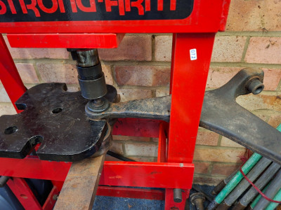

Old joint pressed out:

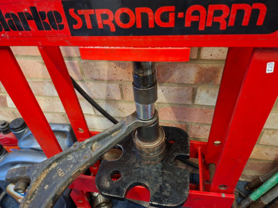

And in goes the new:
It took 5 tons to press out the old and 6 to press in the new...
The amount of wear/play in the old joint was very small - shows the car had a thorough MoT
Reassembly was a reversal of disassembly as the BoL might say. I got the whole job done just before dusk closed in.

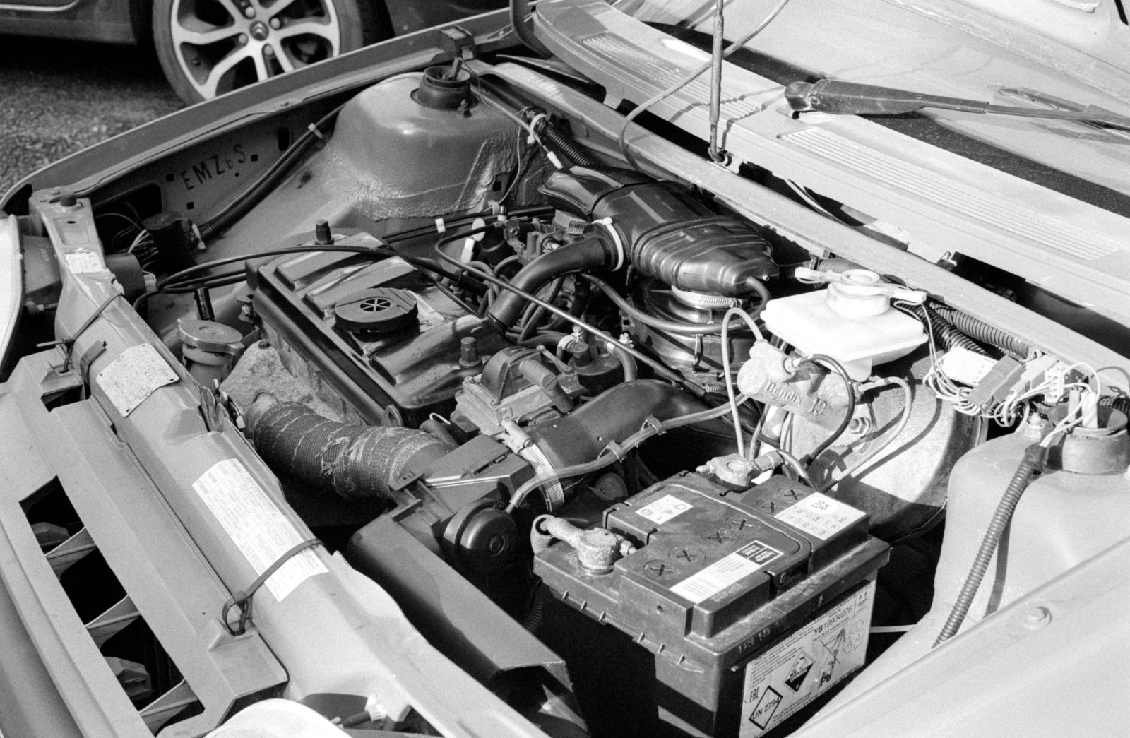

I've just finished writing my A to Z column for the March edition of the Citroen Car Club Citroenian magazine
In order to do so, I needed to re-do some photos and to do so I had to wake up Bluebell and ease her our of her garage...
Couldn't resist a couple of pictures in the winter sunshine whist she was out

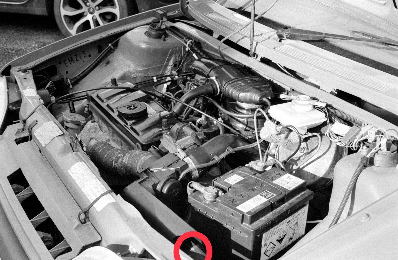

And a photo of Bluebell's very clean engine bay. In looking at this photo during processing I noted a small problem...
It's not the first time it's happened and a cable tie will fix it
I'm looking forward to getting Bluebell back on the road - she only needs for me to send an amount of money to DVLA for VED and I will as soon as all risk of salty roads has passed.

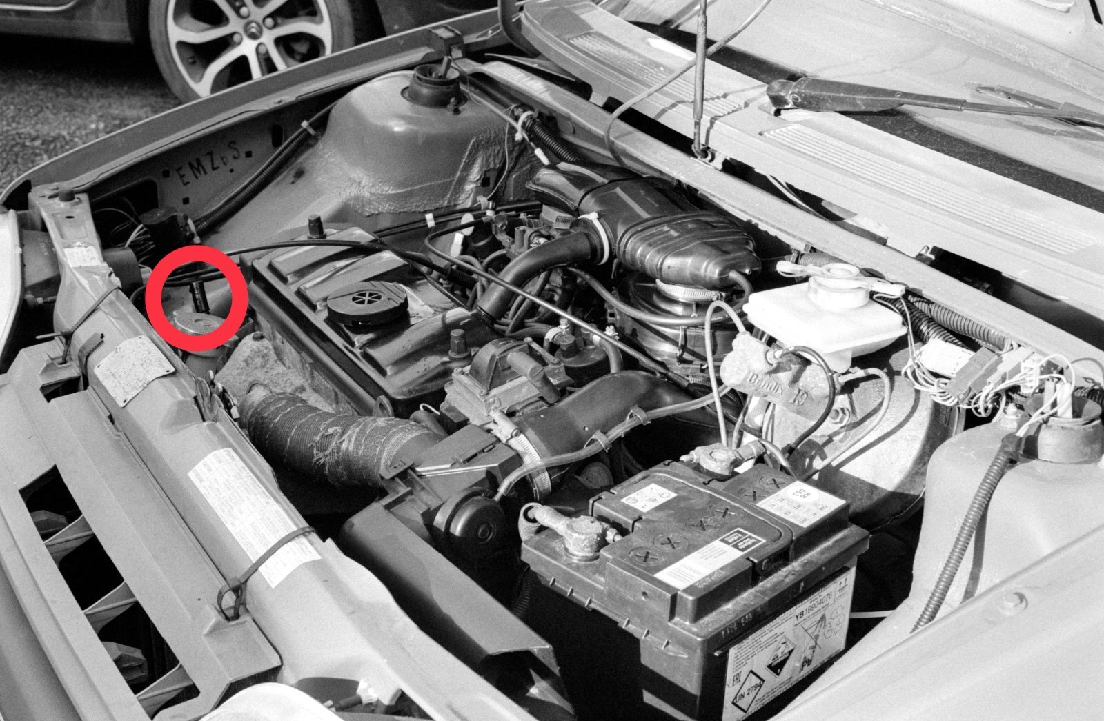

Nope, neither of those thoughts... The 'loose pipe' is in fact the dipstick top and the headlamps are well secured in the proper way
Windscreen washer pipes always look a bit 'free-range' in the AX Matt
Look more closely at the airbox - or the end of it nearest the camera

Where is the dipstick thenCitroJim wrote: 23 Jan 2026, 04:53 Nope, neither of those thoughts... The 'loose pipe' is in fact the dipstick top and the headlamps are well secured ......
Mick said ....
- Spoiler: show
I can't see much to be concerned about Jim mine is missing the intake temperature control so maybe the vacumn control hose needs a connector clipCitroJim wrote: 23 Jan 2026, 04:53
Look more closely at the airbox - or the end of it nearest the camera![]()
Gary
Gary
- Posts: 11851
- Joined: 28 Mar 2013, 21:05
- x 2006
Nope, the dipstick is the dipstick who fixed the dipstick in a dipstick sort of way to retain the original dipstick in an attempt to prevent the present dipstick loosing the dipstick down the dipstick hole. That said, calling it a dipstick hole rather than a dipstick tube is a bit of a dipstick thing to say, thus betrays me as the dipstick who made the dipstick fix to this dipstick which should absolve the present dipstick owner of abusing his dipstick.
