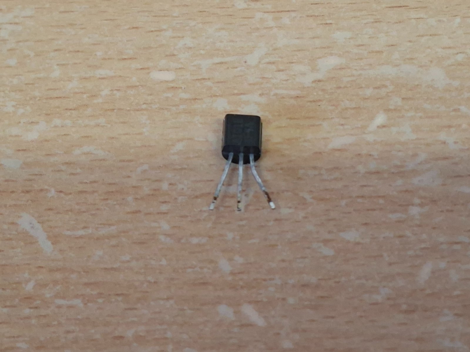

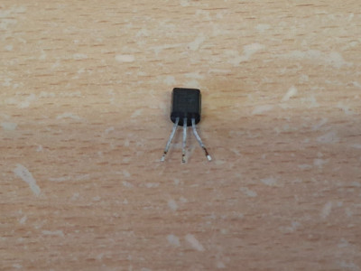

Due to modifications to plans today on account of the perfectly normal foibles of toddlers and babies, the latter of whom celebrates her one month birthday today, I've had a little bit of time to play with an amplifier :)
And Bobins, I'm pleased to say you can now unbate your breath :D
The culprit has been found:
A little transistor right at the front end of the amplifier, just after the volume control. It has a collector-emitter leak and this is enough to upset the biassing of all subsequent stages and causing the output pair to be turned hard-on...
It's always fun chasing down a fault in a multi-stage DC-coupled amplifier. Often it's a bit like a dog chasing its own tail, especially in such as bizarre circuit as this amp. has :twisted:
Spares are on order from a reputable source. Such items I never buy from eBay or similar sites as fakery abounds :evil:
I've bought enough to fully rebuild one channel, just in case ;)

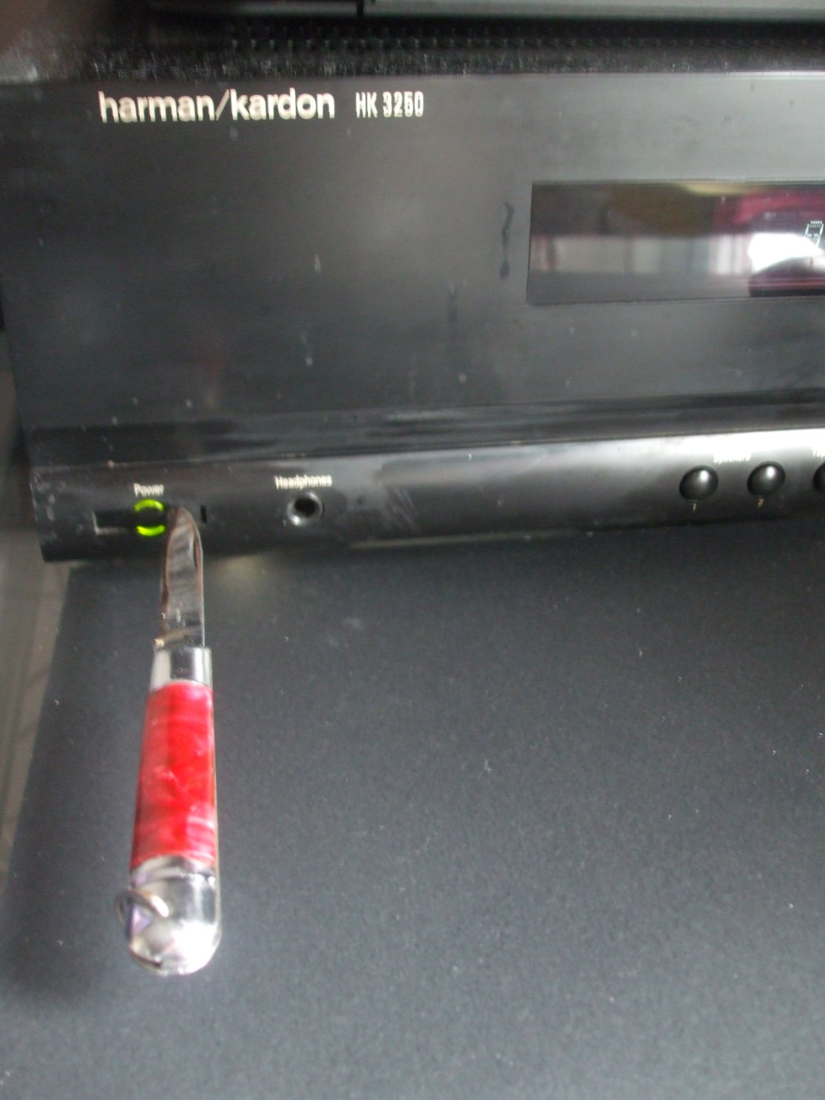

I have just repaired my amp too. The on/off switch refuses to latch any more.
After three days of intermittently prodding it I bit the bullet and fixed it.
