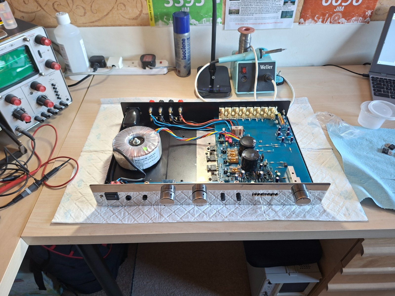

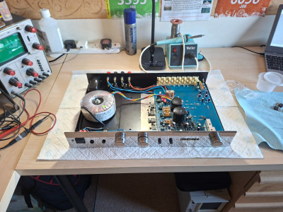

Now the grandfather clock is now all good and much else that had been patiently waiting for me to recover a bit has now been dealt with, I could finally turn my attention to your amp. Bobins :)
Nothing obviously out of order found so far. The resistors that are cooking are in the headphone socket circuit. Why, I've not yet determined. Could be a large DC offset on the speaker lines. Did it by any chance kill a set of speakers when it last blew up Bobins?
I'll be dummy-loading it when I first fire it up after more checks.
The amp. has a great reputation and go for eye-watering amounts on eBay :shock: But, my goodness, the build quality is worse than a 90s British Leyland :twisted: The PCB is very fragile and the whole shebang is not well designed or put together at all. Not surprising the company went bust and the original designer - who's well-known on some audio forums - denies all knowledge!
And, I'm having to do a lot of reverse engineering as there's no circuit diagrams to be found anywhere...
A good challenge. It may be a while but it'll play again :)

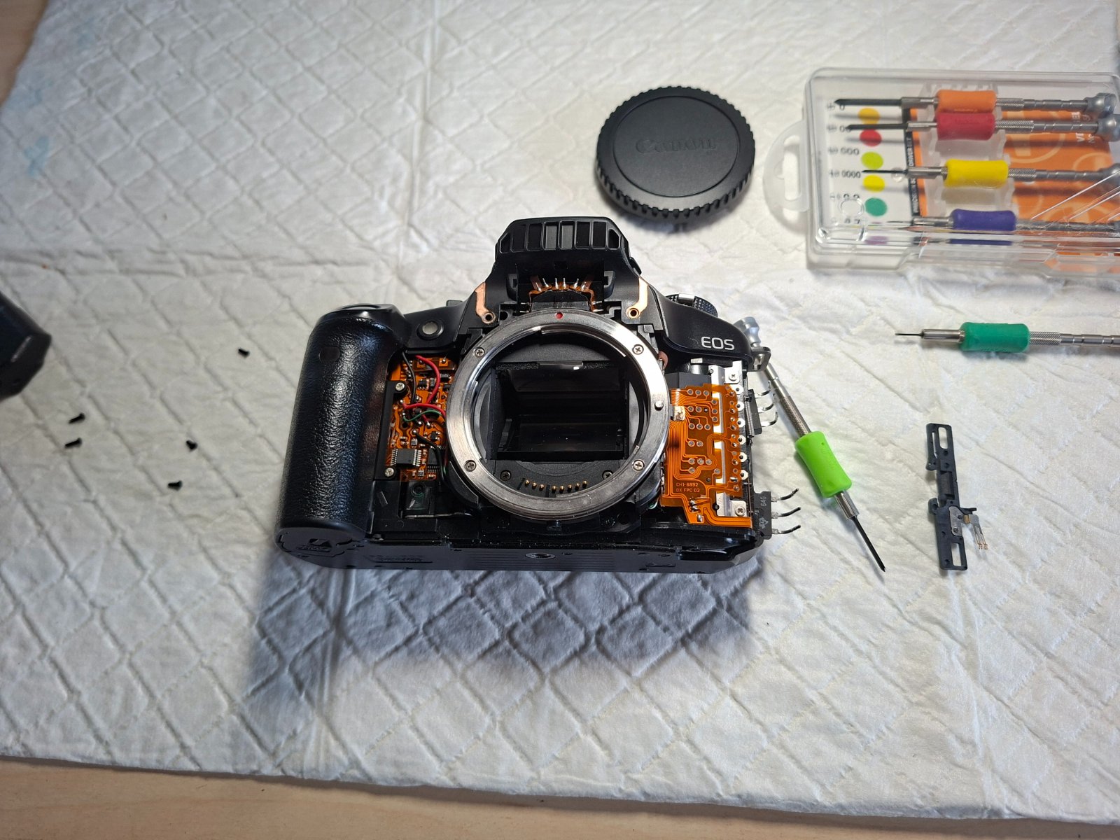

Just before the amp. occupied the bench, I replaced a broken film door latch on one of my Canon cameras... Quite a lot of disassembly needed although straightforward.
What amazed me was just how quickly the spare part arrived from China. I ordered it on eBay only a few days ago. Stuff from China seems to arrive quicker and with much less aggro than from mainland Europe. Postage was free too. Bizarre....
The part is not genuine and doubtless is just 3D printed but it does the job and cost less then a tenner. Result :D

I knew the amp. had issues, Jim, but I didn't know it was that bad inside :shock: 8-[ :-D
It never blew the speakers it was attached to (late 90s B&W P6), but I do remember it cutting one or both channels - sometimes a bit of percussive maintenance on the case would bring them back, sometimes flicking the mute (?) button on and off would work. Eventually nothing would work. I went over the circuit board with a magnifying glass looking for obvious dry joints or broken legs but couldn't find anything. Not a problem if it proves unfixable or just too much of a PITA as I'm several amplifiers down the line since that one ! :lol:
Thanks for taking it on though :)

I've done some more work on it Bobins, and I find the left channel is OK but the right channel has a DC offset of some 40V on the speaker output. Both output transistors are rammed hard on! The fuses would have popped to protect the speakers... No wonder that resistor was unhappy!

Not being electrically minded, and in words of one syllable or less so I can understand, what would cause those transistors to be on ? :-D

Back in my youth I did contract repairs of amplifiers for a local hi fi shop, once a week they would drop off half a dozen dead amps and the following week they would pick them up. Blown output transistors were common, often for no apparent reason. Some came back several times, I usually suspected mismatched speaker impedance, or parasitic supersonic oscillation of the amplifier. My general feeling was that audio amplifiers of that era had pretty marginal design and were just waiting for an excuse to blow the output transistors.

xantia_v6 wrote: 06 Nov 2025, 07:16My general feeling was that audio amplifiers of that era had pretty marginal design and were just waiting for an excuse to blow the output transistors.
Yep, that sums it up very nicely Mike :twisted: and with everything DC-coupled it's ripe for an avalanche.
This amp., and I'm sorry about saying this Bobbins, falls into the category of 'fur coat and no knickers' :roll: Looking at the underside of the circuit board it would appear they employed Stevie Wonder to do the soldering and he misplaced the decent stuff and used plumbers solder and flux instead.
I'm going to look out for parasitic oscillations as it's a well-known killer of many amps. A dead giveaway is very hot output transistors with no input...
As I say, it will work again :)

The back of the board may look like an explosion in a smelting factory, but the sound that came out of the speakers more than made up for that in my view :-D
