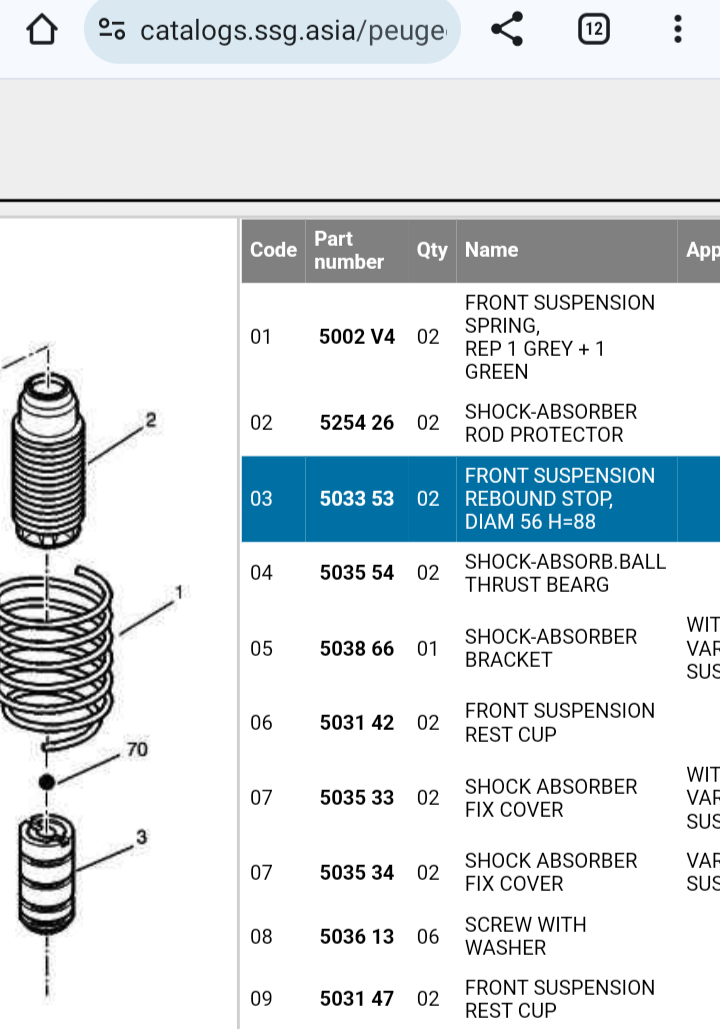

Screenshot of part number for future reference

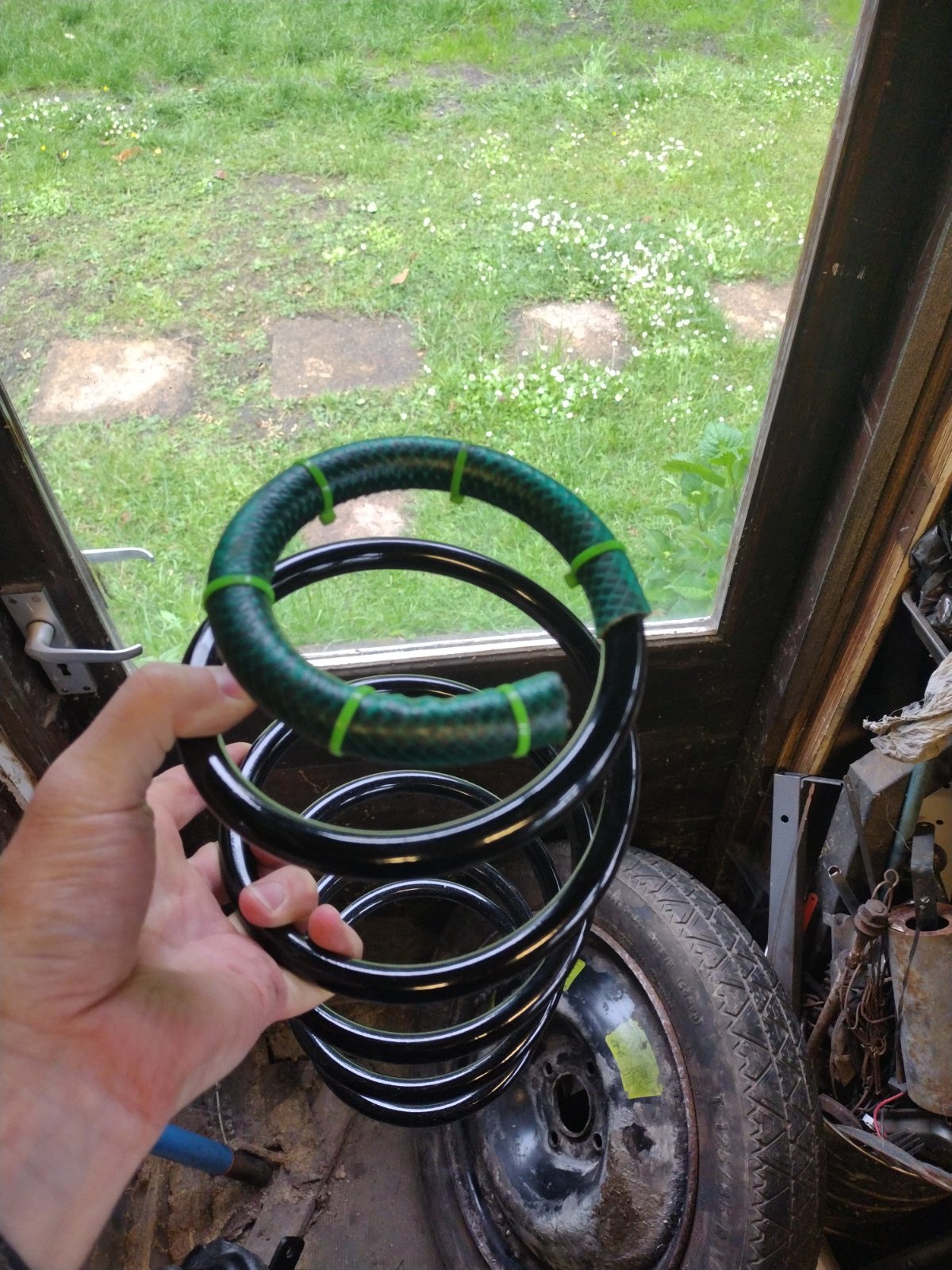

I was trying to find a picture or part number for a thin slice of rubber that fits on the bottom of the front coil spring where it sits against the dampers spring cup. However it doesn't seem to exist on the diagram on Parts Asia??

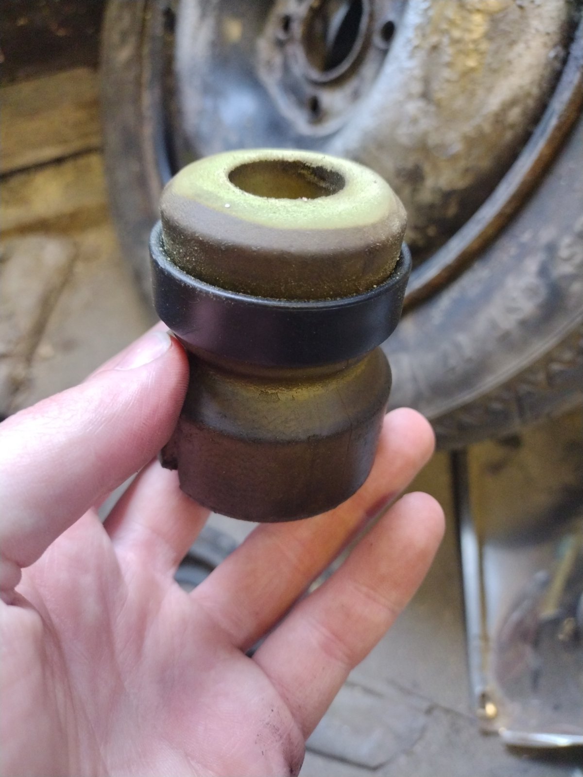

One of mine was reusable and the other must have been rubbish as strangely I appear to have thrown it away. Here is my substitute arrangement from the Hozelok automotive accessories range :rofl2:
Spoiler: show
Non-OEM
Non-OEM
Posts: 55178
x 8440
Translating to air filters :lol:
406 ones last a bit better than Xantia bump-stops. Most Xantia ones have now all but entirely disappeared into dust...

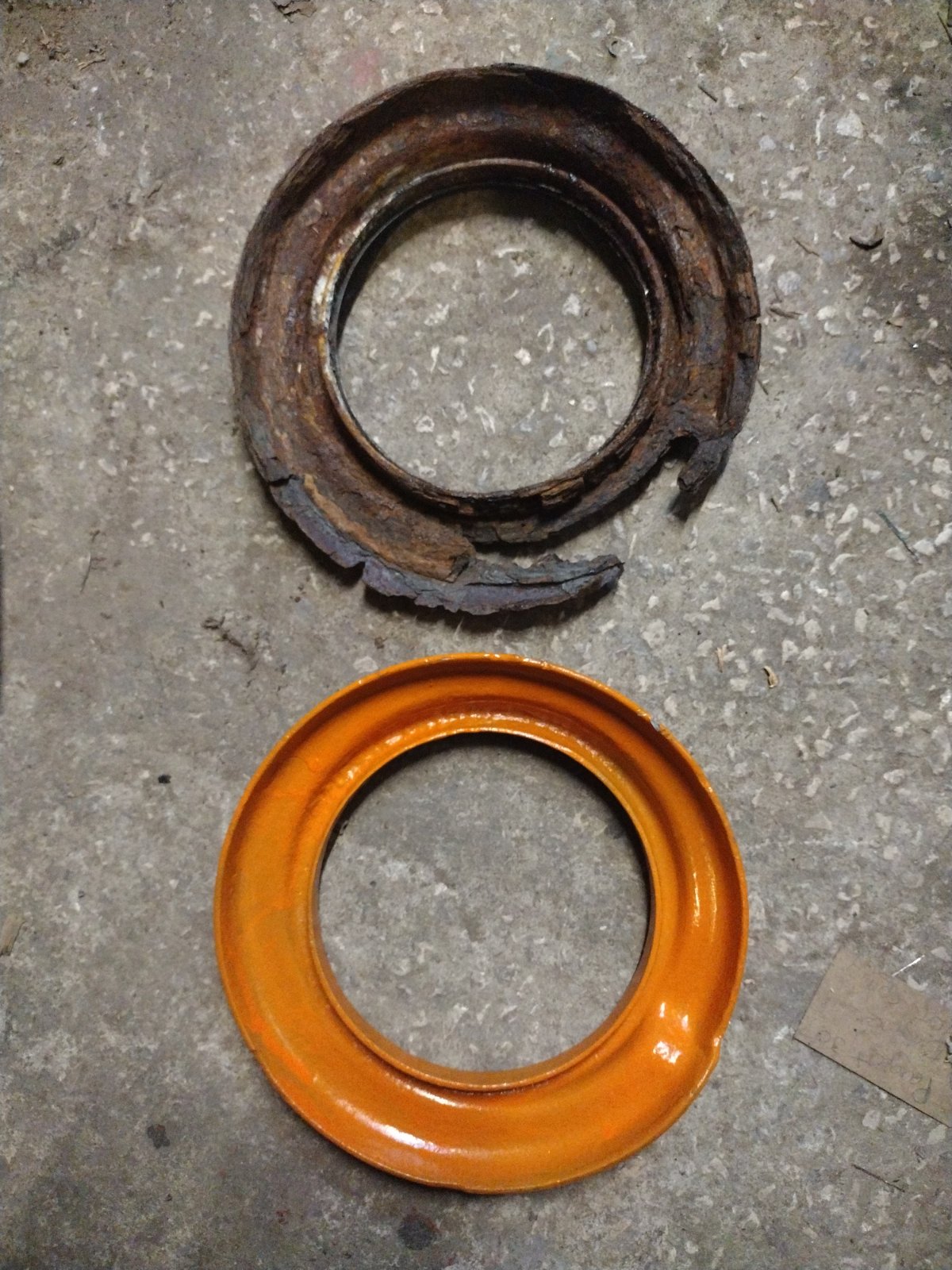

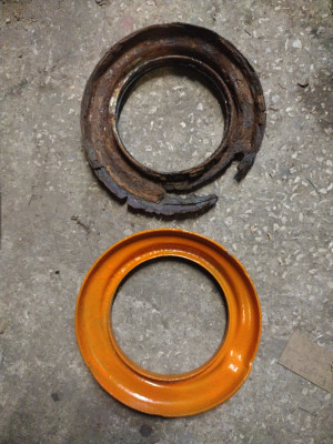

The 607 ones that have come with my struts / upper strut tops look in good nic, but also a fair chunk longer than the 406 ones so I decided to leave those as an experiment for another day.
That reminds me here's a picture of the repainted (but you could guess that!) 607 upper strut top spring cup vs the 406 item which started this saga:
One is brown, the other is orange
Posts: 55178
x 8440
They look smart in orange Matt!

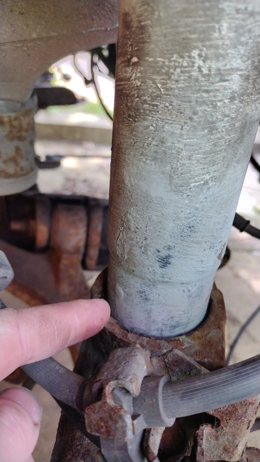

Oh yes, I forgot about this picture, answers on a postcard: what is really annoying about this nearly installed strut?
You can't see it, but the flange for the anti roll bar drop link is in roughly the correct position at this point (off the top of the view)
Two steps forward but at least one back! (Sorted later)
Posts: 55178
x 8440
Ahh, maybe the locating pip on the strut body is not in line with the slot in the hub carrier? Done it on Xantias a few times...

CitroJim wrote: 14 May 2024, 09:19 Ahh, maybe the locating pip on the strut body is not in line with the slot in the hub carrier? Done it on Xantias a few times...
Even worse than that!
Spoiler: show
left hand strut on the right hand side of the car! ](*,)

MattBLancs wrote: 14 May 2024, 17:08
Spoiler: show
Plonker!! :-D
Posts: 55178
x 8440
Oh dear Matt!

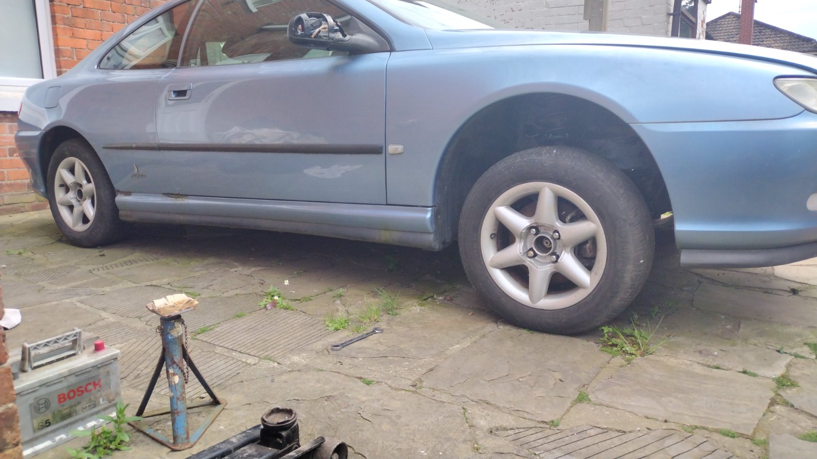

You might just be able to tell this Coupe has the diesel springs and no engine or gearbox...
Spoiler: show
SUV version anyone?
SUV version anyone?
:-D
Posts: 55178
x 8440
Hi-rider 😎😂
