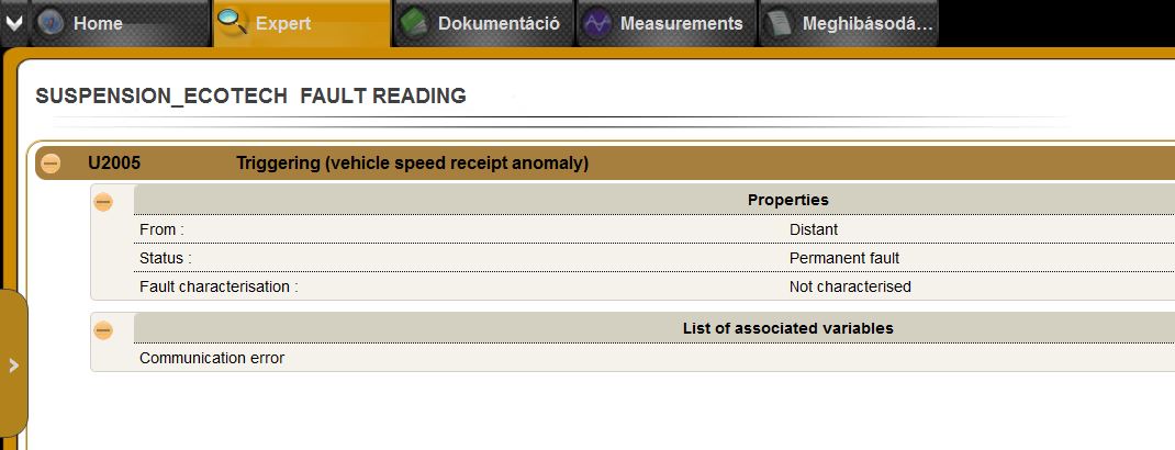

I have a fault. Does anybody know what does it mean? Is this cause any problem? I feel nothing special.
- x 6946
Re: Merged Lexia & Diagbox threads
No that's not a problem, it's normal and to do with the speed signal from the ESP system triggered by the diagnostic when interrogating the ECU. It's a known ghost fault.

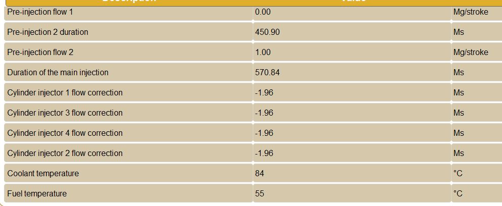

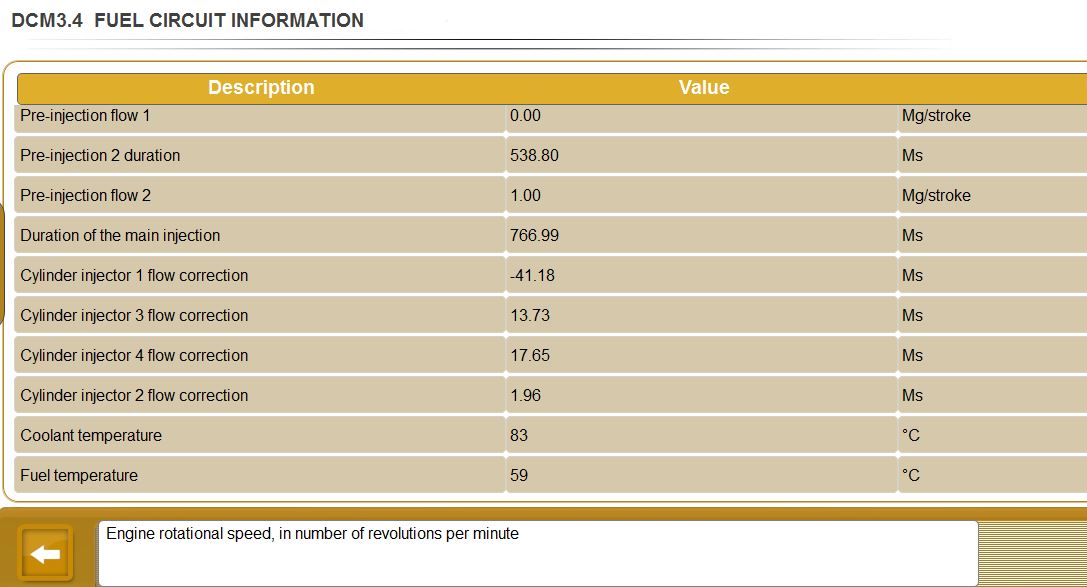

I have checked the live data as well and I got the first result on engine idle. And the second result on increased rpm. What those it mean? Do I have problem with 1. and 2. injector?
