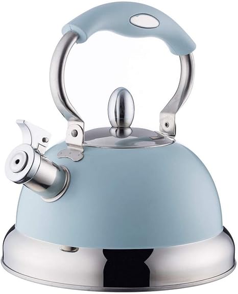

I have located and ordered a 3 litre stainless steel hob kettle with whistle and another 1 litre flask. The new plan will be boil the 3 litres first thing on the gas, make two mugs of tea and pour the remaining water into the two flasks to see us through the day.

Ours looks like its quite sexy too
