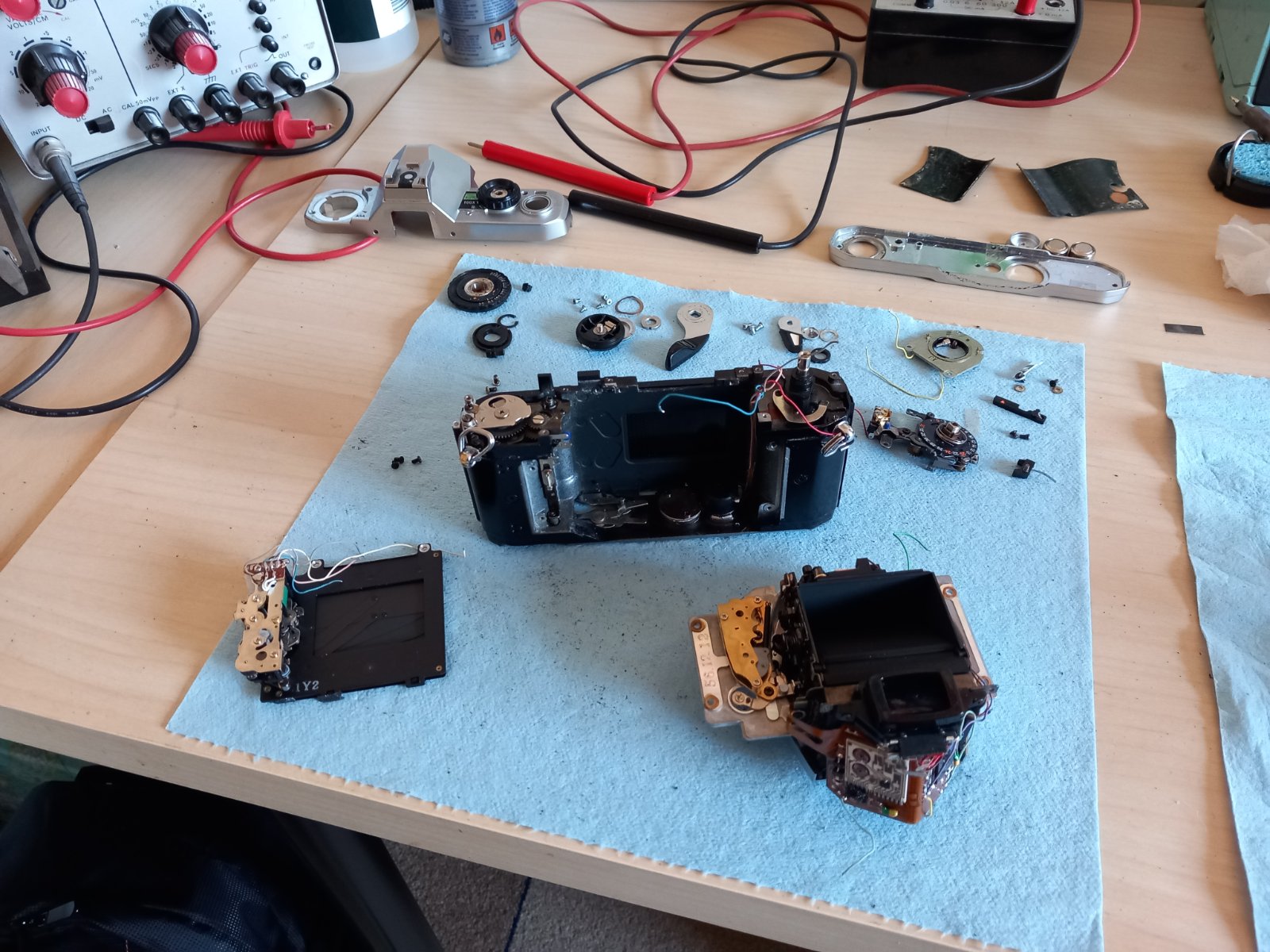

I was able to do a bit more work on the Pentax camera today... It's is truly all in bits and I've proved the shutter jam problem is all as a result of disintegrating foam... I'm going to have to make up some new bits..
Will it ever all go back together? I took heaps of photos during disassembly so one hopes!

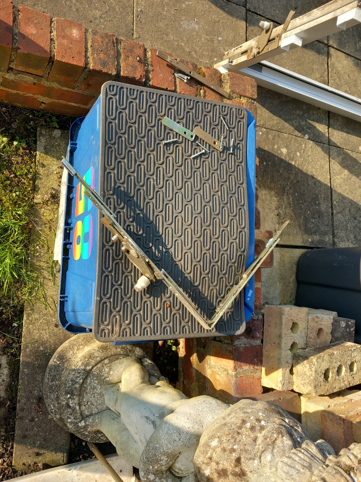

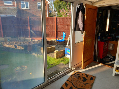

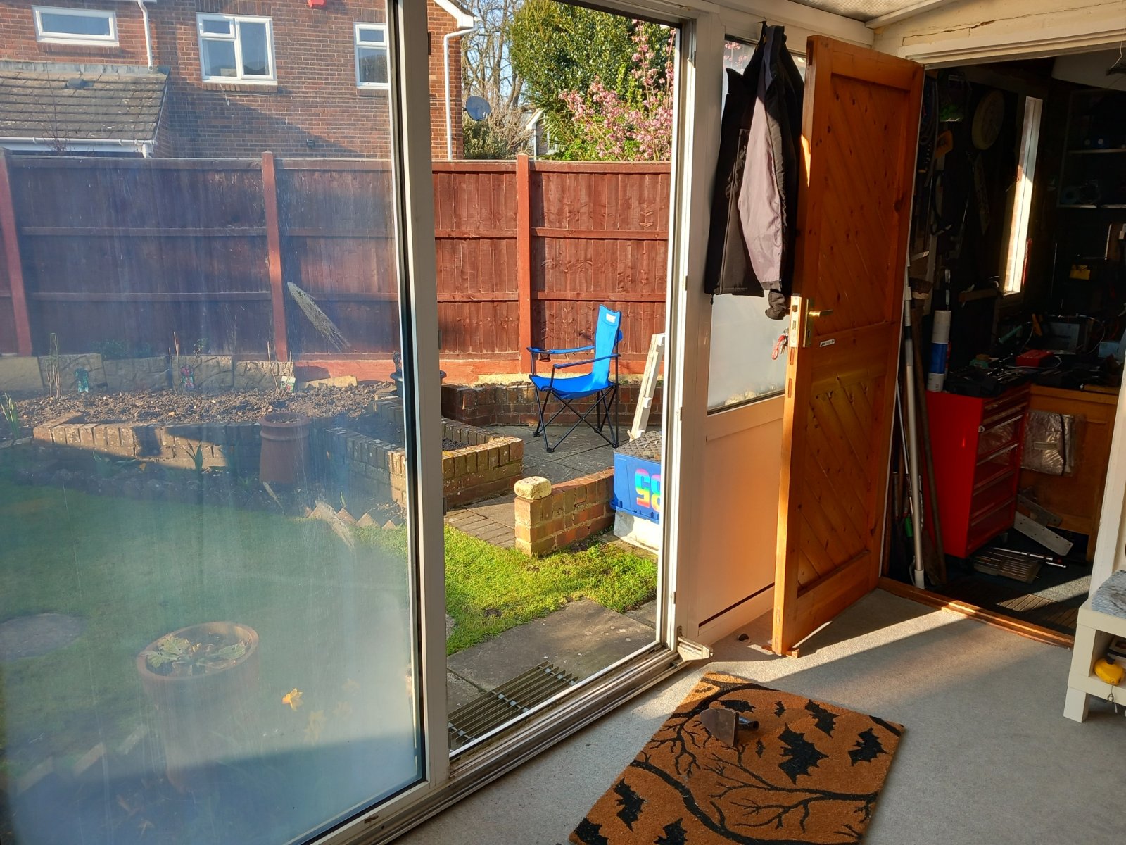

This afternoon, repairs commenced on my broken conservatory door. It's being done by the owner of the C4 Space Cadet I did some work on a couple of weeks back...
We soon found the problem - two broken diecast toothed racks on the mechanism that transmits drive around the locks and slide mechanism.
Happily, despite the door being around 30 years old, spares remain available. New bits on order
At cost, the bits needed has left no real change from £100. Cheaper than a new door complete or even a new conservatory...
It'll be good to have a working door - it's only been broken for 15 years...
Next job is to re-roof the conservatory and replace some 'blown' glazing...

Better than for our front door which has a couple of knackered bits and is non repairable after seven years because nobody makes the parts.
Supposedly ten year warranty, but given the company that installed it went belly up five years ago that's not exactly worth anything!
Suffice to say we're just ignoring it being a bit wonky.

You may be right there but I used to work for a company making windows and doors, they largely just assembled them from readily available parts. All the locks, handles, hinges etc. were bought in.
- Posts: 55135
- x 8415
I gave it enough time I thinkMattBLancs wrote: 24 Mar 2025, 19:11 "Leave it and it might fix itself" given a good opportunity to kick in, sadly not this time!![]()
It's not a very kickable sort of door Matt. It's a 'Plug' or 'Tilt and Slide' door.
These past fifteen years I've been having to open it using an improvised hammer - actually an old flat-iron
I feel your pain ZelZelandeth wrote: 24 Mar 2025, 19:22 Better than for our front door which has a couple of knackered bits and is non repairable after seven years because nobody makes the parts.
When mine first broke, parts appeared to be unavailable for mine coupled with nobody even being prepared to even look at it. Attitude was: 'You need a new conservatory mate. Give me 25K and I'll do you a lovely one...'
Bit like saying you need a new car because your central locking has failed...
I checked again last year it was the same except it was more like 50K for a new one... Amazingly, after being unavailable for so long, parts are once again available...
Even if they're not, now I've seen the mechanism in bits I could make it functional again with a bit of re-engineering...

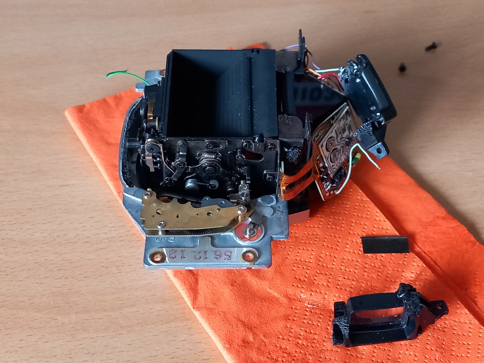

Then, a bit more work on the camera... I found the root cause of the jamming shutter problem - sticky pivots and slides in the mirror box mechanism.
A good wash with IPA - the solvent, not the beer - has freed everything off quite nicely and the mechanism now operates smoothly and reliably.
I found the viewfinder eye-piece is broken. It came out in two bits when I removed it to clean the pentaprism and focussing screen surfaces. It can be seen in the above photo...
It also accounts for the loose bit of metal I found floating around the focussing screen area. It holds the eyepiece lens snug...
I'll be able to repair it - superglue should do an adequate job.

The spares to fix my conservatory door have arrived
Excellent service from the suppliers - a specialist double glazing spares supply company...
The door will be reassembled and refitted tomorrow...

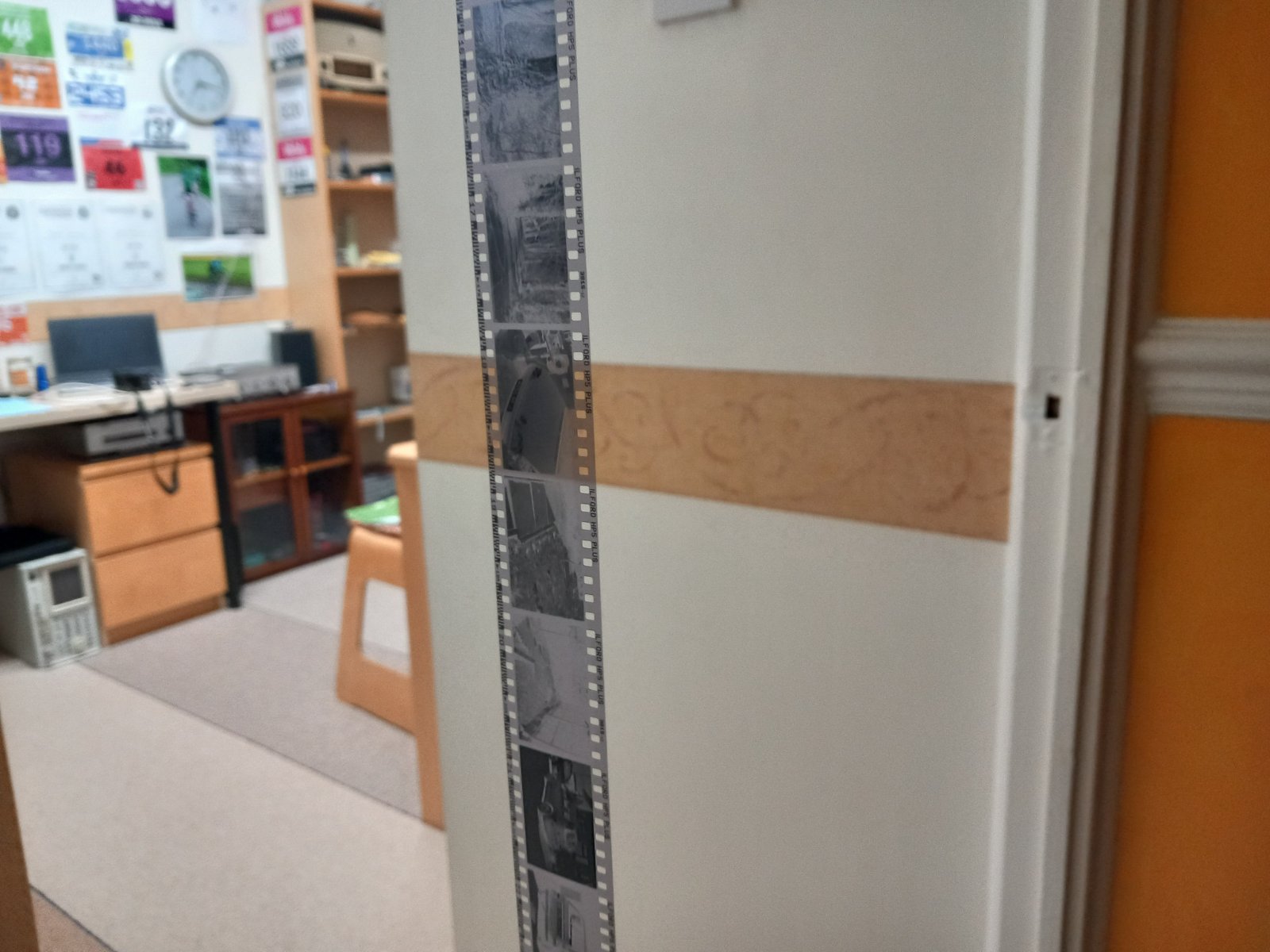

Later this afternoon, I plucked up the courage to develop my first film since the late 1970s...
I was very nervous, especially when loading the film into the developing tank spiral by feel alone...
It's looking good
This is the film hanging up to dry and although in this picture the negs look defocussed, it's all an illusion. Under a magnifying glass they're very sharp.
