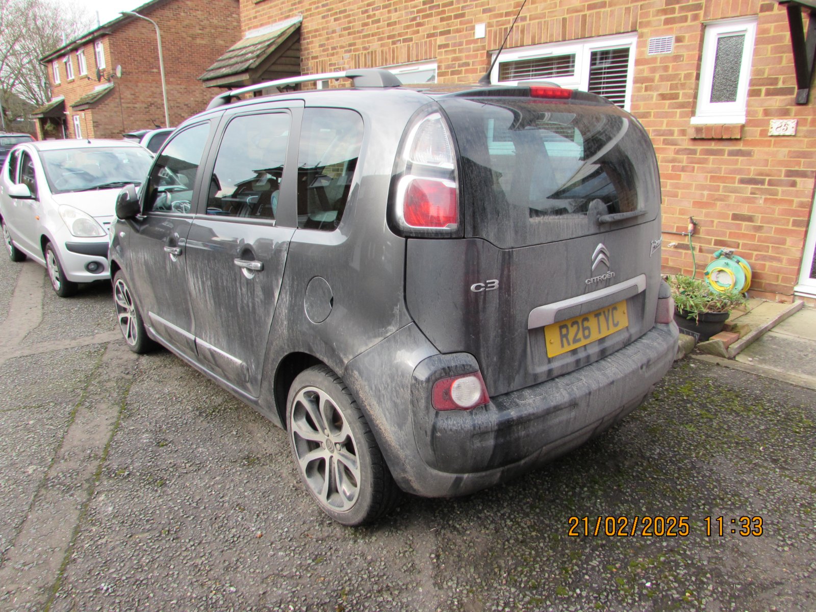

First job was to deal with a filthy Picasso
That was as a result of the trip to Somerset and back. I had to as it was lowering the tone of our close!
Also, I want her nice and clean for her MoT shortly...

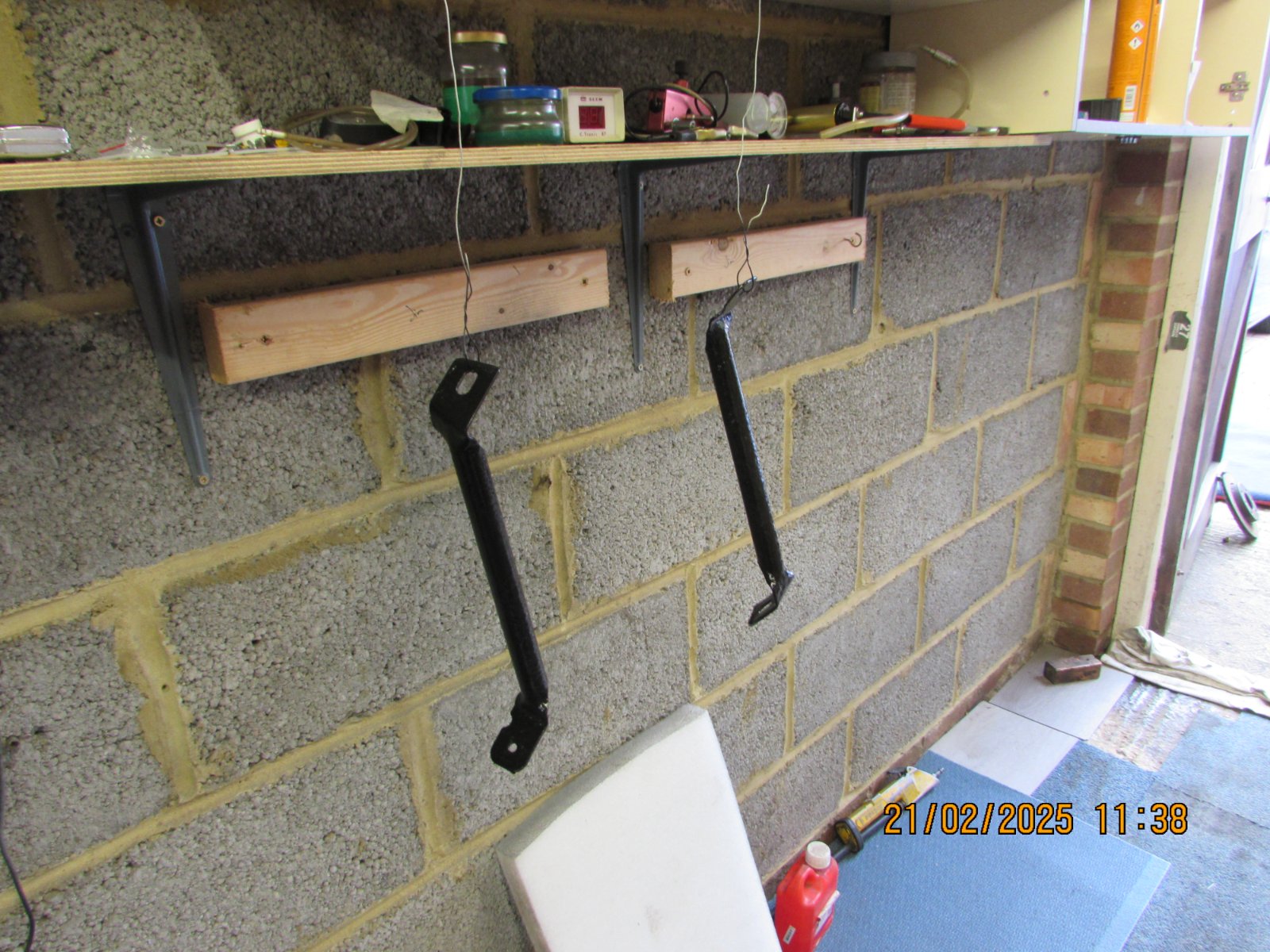

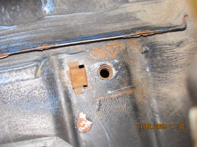

Then I spray painted Bluebell's bumper struts... Several coats of primer and top-coat...

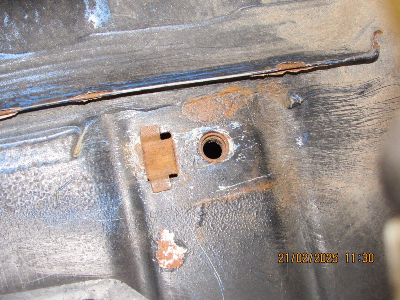

Whilst they were drying I got handy with the wire brush and a can of B-H underbody wax and did some rust-proofing ahead of refitting the washer reservoir and bumper.
All is looking lovely now around the bumper strut mounts

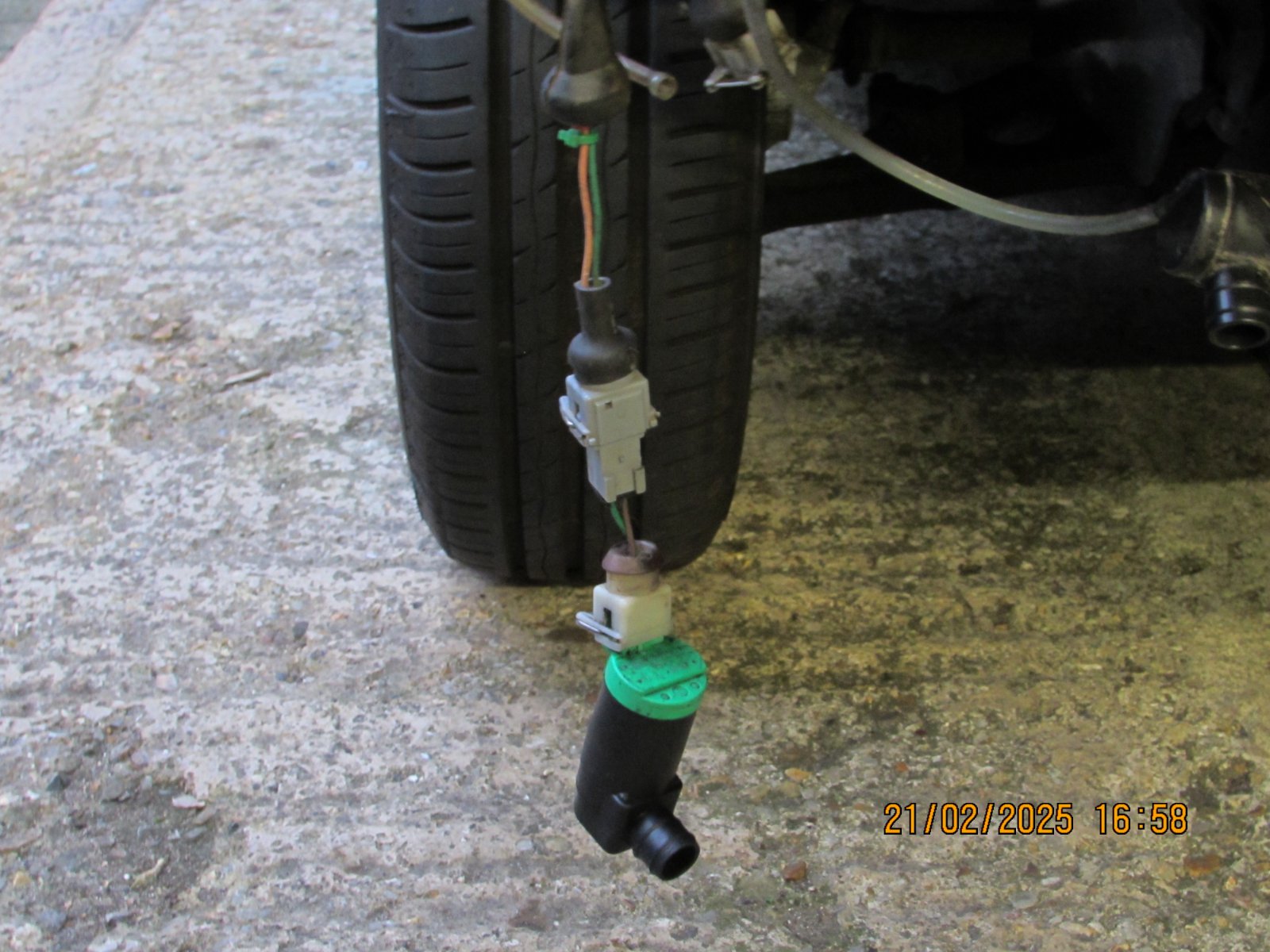

Last evening, following the acquisition of some connectors from a scrapped Xantia wiring harness, I did a bit of work to do a better repair on the old, damaged washer pump so that the pump is not 'hard-wired' and a replacement pump can be easily substituted if need be.
This is how it looks...
The white plug on top of the pump is just acting as a case to retain a load of silicone grease; the wires being soldered directly to the remains of the damaged connector spades on the pump.
Silicone grease will be smeared on the crip ferrules above the middle plug and socket to keep moisture out...

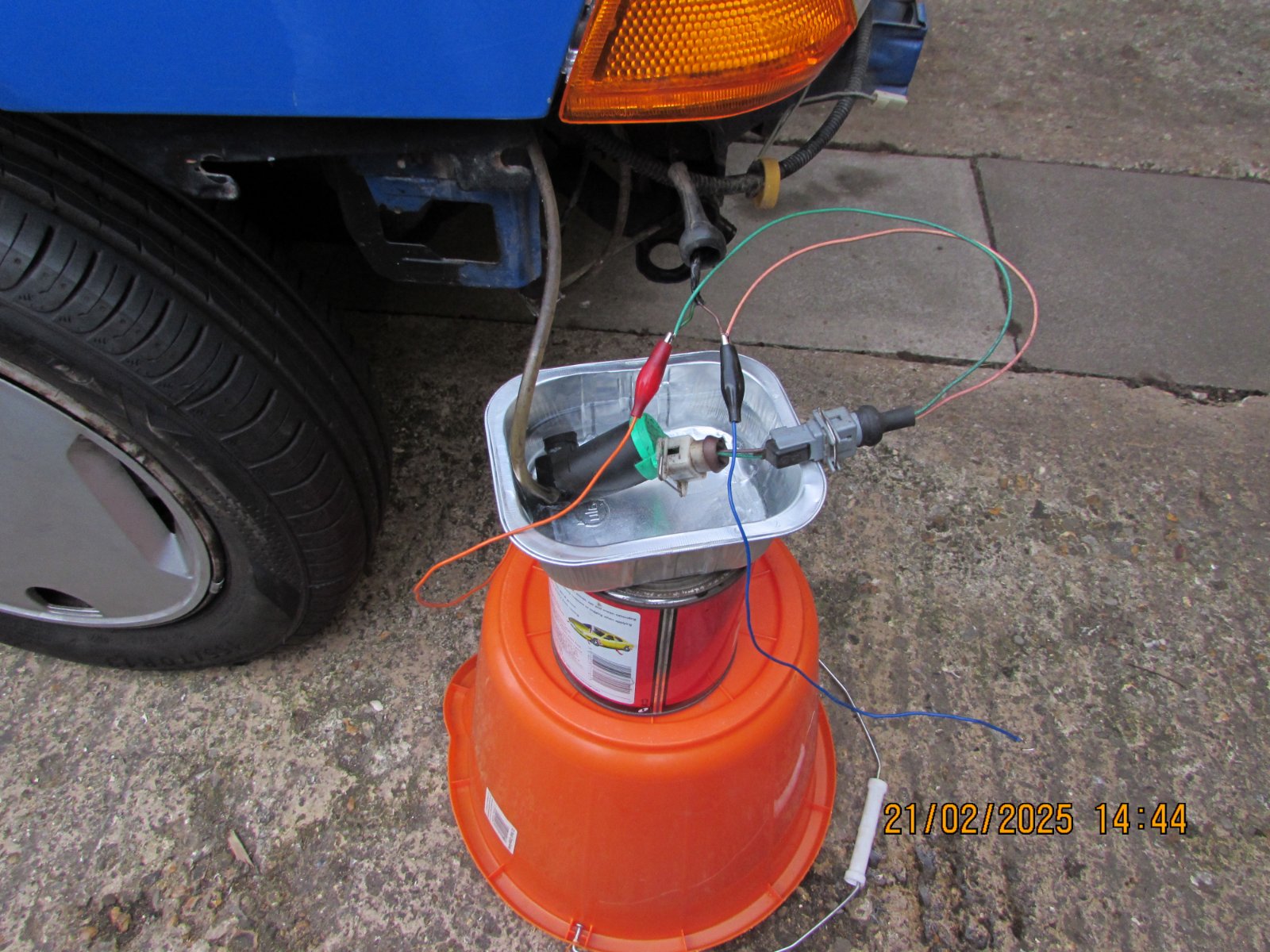

I tested it all ahead of final assembly...

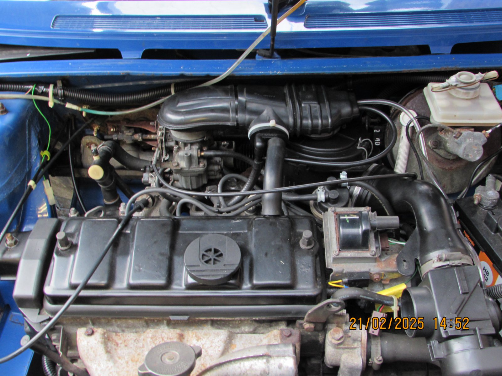

All the bits in the engine bay that needed to be removed to get at the starter motor have been reinstalled.
And after priming the fuel system she fired straight up
It was noticeable the starter motor is somewhat more eager after its overhaul...
