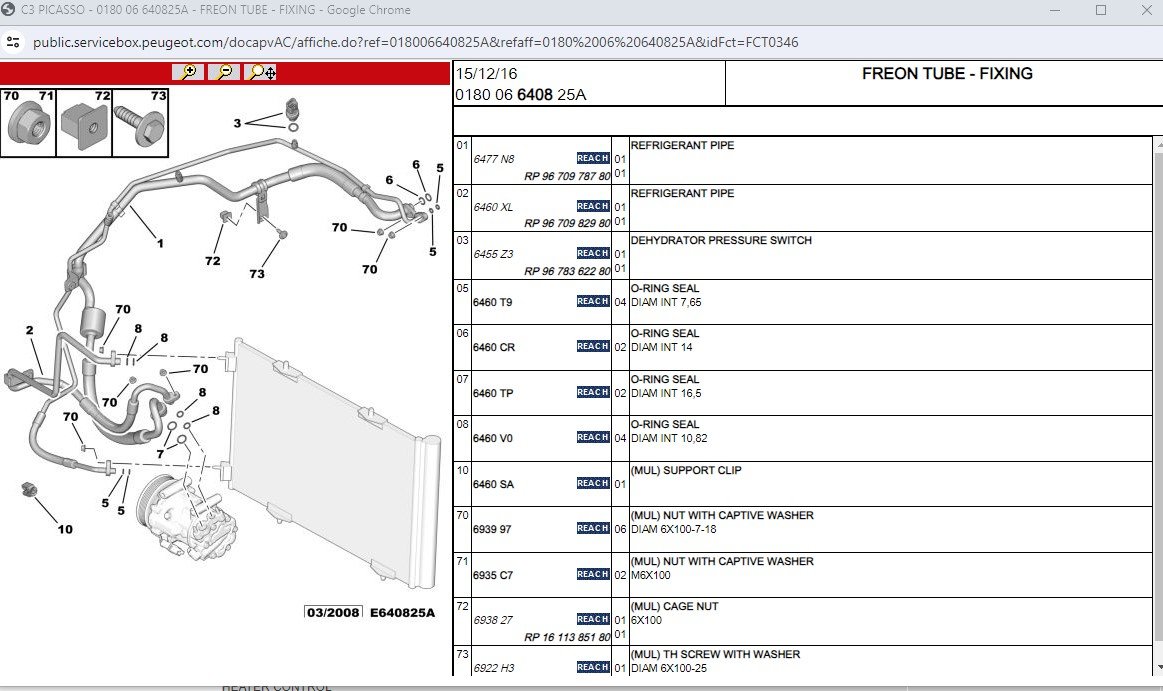

Air con.
Marc if you would be so kind im needing a diagram of the ac pipe route where it plugs on to from the condenser to car bulk head . Mine was tested before my ownership ,mwas empty due to leaks.

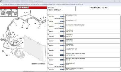

Re: Citroen c3 picasso
Unread post by RichardW »
The pipe bundle is £253.22...
Huskyxantia

So there's 2 matrix in side one cold the other hot water type ?

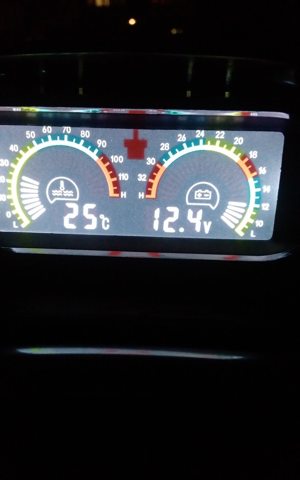

So everything has been put back the other project i did has been done which was this https://www.ebay.co.uk/itm/164364453907 ... edia=EMAIL =D> =D> it works a treat. The clutch pedal feels so much firmer the bite point is lower smoother & no notchey 1st gear too. I fitted the electronic gadget because i like to see what temperature my coolant system get to and is. Wired to an ignition live and a good clean earth.

Huskyxantia wrote: 12 Jan 2024, 17:12 So there's 2 matrix in side one cold the other hot water type ?
Yes, the matrix with water in for heating, and the evaporator with (boiling) refrigerant in for cooling.

I like those gauges! Not expensive either...
Huskyxantia wrote: 12 Jan 2024, 17:15The clutch pedal feels so much firmer the bite point is lower smoother & no notchey 1st gear too.
Excellent news :D

I've gone and purchased another set for my 308cc . They look much better in real life than the photo i took.

RichardW wrote: 12 Jan 2024, 20:25
So as my system was no good can i remove the evaporator ?
The air con has been emptied properly by the dealerships garage into a machine , they said it was virtually empty. I got a rattle from where the matrix things live , if its not connected to the pipes it will have free play ? Wondered what this was rattling . Makes sense now since I've been near the pedals to do the master cylinder too.
