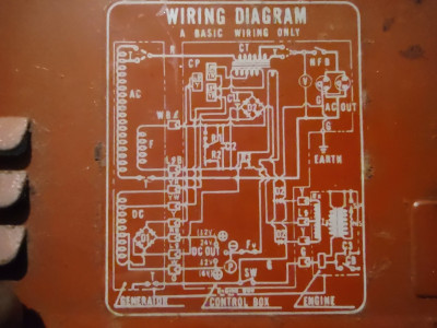

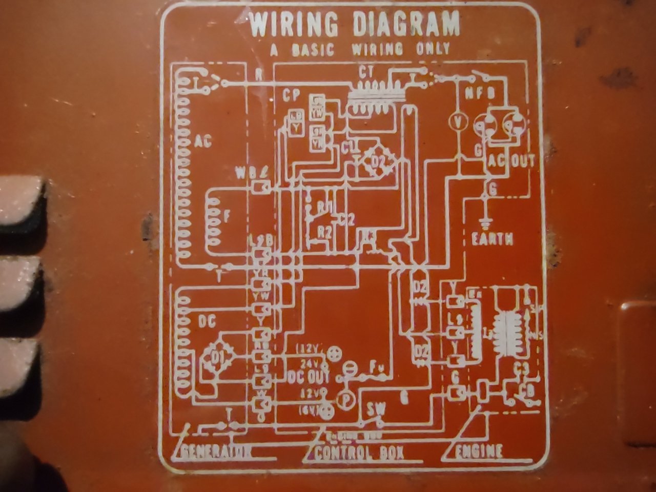

I think I've hit a snag which will probably mean I'll sideline the genny, and instead use the frame it sits in as a base for a pressure washer or something else instead.
There's a couple of wires coming from a dedicated coil in the engine which seem to be part of making the genny actual generate. The coil in the engine would normally be a lighting or charging coil, but in this (archaic) install the wires go via a couple of diodes and over to the bridge rectifier in the genny control box. Without whipping the flywheels off my various spare engines I don't know (and doubt anyway) if any of them have lighting / charging coils fitted, and although I could source a coil to put in, it's far easier to make use of the chassis frame something else :-D
BTW, there was a date stamp on one of the crapacitors of 1970.
Here's the wiring diagram from the genny. The wires in question are the two Y - yellow and one L? (light green) coming from 'Engine' in the bottom right hand corner.

That'll be the field exciter supply Robin.. AC from the engine mag. and rectified/regulated by the bridge and associated circuitry to provide the necessary field excitation. Yes, without that, a bit of a show-stopper...
You could work around but not easily... I could give you some thoughts on how you might... You'd need to cobble up a separate supply for it from a little auxiliary alternator driven from the replacement engine...
A bit like a diesel-electric railway locomotive has. An engine, a main generator and an auxiliary generator to provide field excitation to the main generator...

Ta for that, Jim, but it's not worth the effort as it was more of a fun project. I spent a little time coaxing a spare 5hp Biggs engine into life this morning which I was going to use, so I now need to find another use of that :lol:
Yep, used to see the little 'genny' units stuck on the ends of the big gennies in Maginot fort gensets :)
