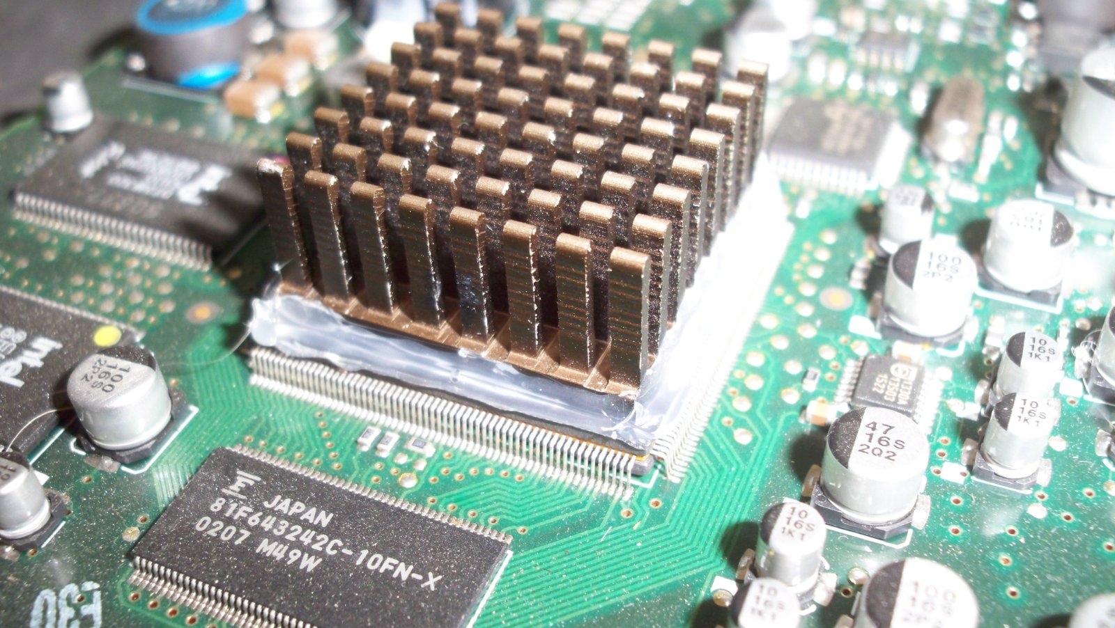

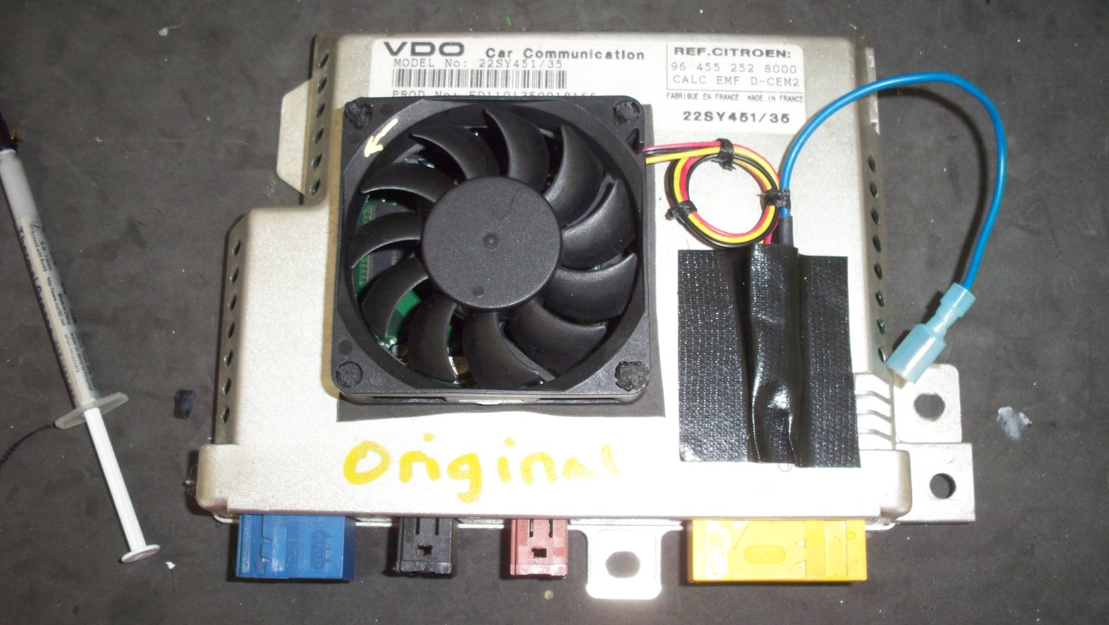

Before, or in addition to, replacing/repairing the 22SY451 see my current thread on the the void behind the dashboard being heated by hot air leaking from the driver's centre fascia duct due to the soft foam seal perishing. Check behind the instrument panel, low left, for the 10mm gap left by the failed seal. Its like a third hot air duct. In December my MFD went blank during a 4 hour motorway journey in freezing temperatures with hot air on continuously. I reached behind the instrument console (I keep it loose) to check the cooling fan was running, and was amazed how hot it was inside the dashboard. It was then I discovered the hot air leak. Even my additional fan and heat sink on the CPU could not cope with sitting in 40+degC air from the leak. I assume it was an over-heat cut out, because it started working again a few days later. I am experimenting with fitting a Peltier-effect refrigeration chip to the CPU with a digital temp controller. It might seem a faff, but its worth it to extend the life of the ECU.....cos the car ain't the same without it and its MFD screen!
By the way, I also removed some of the housing around the satnav unit to aid its cooling.

We are not talking "heater pipes", but the foam seal at the interface between the upper output of the heater unit and the dashboard which houses the ducts to the fascia and windscreen vents.
The only access to the drivers side centre fascia duct is from behind the instrument panel. Which is a good thing because the instrument panel is easy to remove and gives direct access to just the right part of the seal. Of course, it is also the only access to the 22SY451 itself.
If the passenger end of the seal has failed, air will be leaking into the void behind the glove box. If the sections of the seal between the fascia and screen ducts has perished, there will be leakage between them...no big deal.
To replace the seal in toto requires removal of the dashboard, in effect to lift the dashboard up off the heater unit (which remains in place).
The footwell will not give access - certainly not to the drivers side, and I suspect neither to the passenger side either.
By the way, if you need hot air you can de-select the fascia vents by selecting screen and feet only.
Oh and while I think about it, I rarely carry rear passengers so I blocked the rear passenger feet ducts where the exit behind the seats...it increases the airflow to the front feet vents, a bit. I hope that helps.
