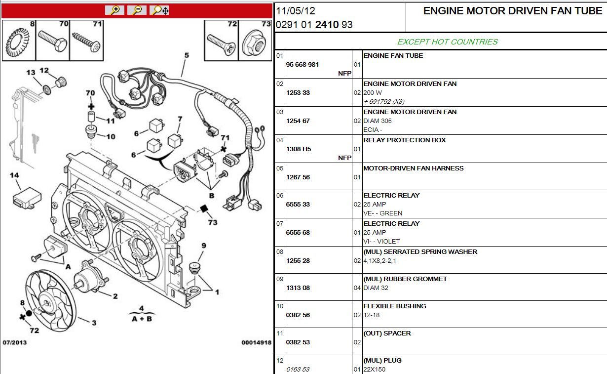

As i do not have access to Service Box anymore could someone have a look and see if they can identify the measurements of the OE fitted frame for the fans.

I think also from memory the 3 relay plugs can be pushed out and the wiring loom unclipped from the frame so i can just do a BOL and refit as reversal of the removal process

Thanks Chris but it does look very similar, just wondering if the diameter on the fans is 305 and the diameter on the housing is 320 hence the difference for clearance ??

Would guess that the 305 is the actual fan diameter. Not much point in specifying the aperture size.

I have measured the fan diameter and can confirm it to be 320 as per the diagram, why it shows as 305 on service box i have no idea.
Difficult to measure the height accurately but give or take a few mm it is close to the 450 and the length is bang on at 688 and so is the spacing between the locating holes so i may just take a punt and order it, looks like a few days dismantling coming up unless they are screw fixings for the blades in which case scrapped knuckles will ensue
