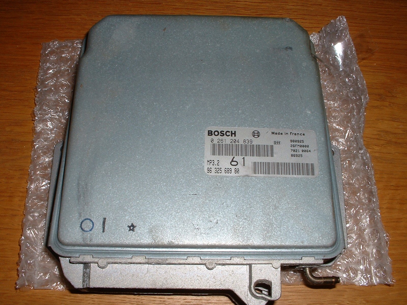

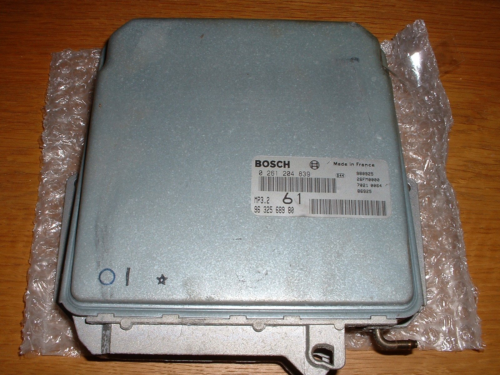

OK I've opted to have the ECU tested with ECU TESTING
ECU
ECU
TESTING £54 inc VAT and courier collection (DHL) +£12.50 RETURN AFTER TESTING = £66.50.
*REPAIR if required £300 inc VAT + £12.50 return after rebuild.
*LIFETIME WARRANTY included which appears to be transferable to new owner/s.
Do the case markings (bottom left) indicate anything :?:
Collection is arranged for today 5 Aug 19 .... [-o<
Gary

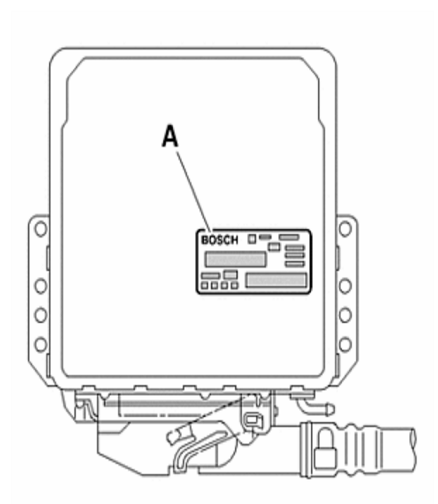

The ECU (Bosch) pin outs are as follows:
"A": Identification of the control unit.
ECU connector: 55-way (37 ways used).
Allocation of channels of connector:

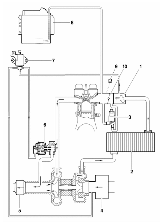

Air Supply Components:
Key:
(1) Inlet manifold (in composite material).
(2) air/air heat exchanger.
(3) Idle speed regulation solenoid.
(4) Air cleaner.
(5) Catalytic converter.
(6) Regulating valve.
(7) Valve for turbo piloting.
(8) ignition injection control unit (pressure sensor integrated).
(9) Throttle butterfly housing heating element.
(10) Throttle butterfly housing.
Special features:
  • The idle regulation is ensured by the idle regulation solenoid valve
  • Reheating of throttle housing by means of an electric resistor
  • The catalytic converter is fitted to the exhaust line
  • The oxygen sensor is located in the exhaust line, between the engine and the catalytic converter
  • The opening of the control valve is controlled by the injection ECU

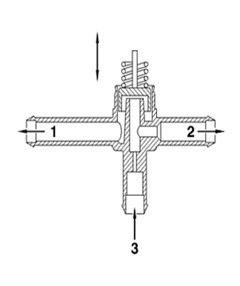

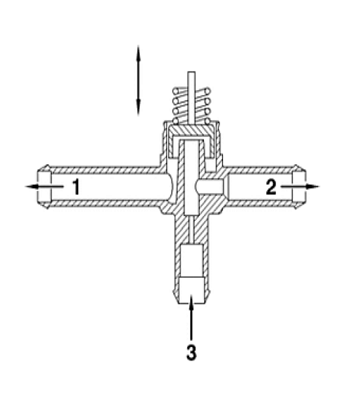

Function
  • The turbocharge pressure is regulated by the injection ECU.
  • When the maximal admitted pressure has been reached (750 mbars), the turbo piloting valve opens the control valve.
Description
(1) Long adaptor (towards the turbocharger suction pipe).
(2) Towards control valve.
(3) Towards throttle housing.

Just that schematic of the system layout is helpful and looks very detailed :wink: I really am working blind :conf:
Well I phoned ECU TESTING just to confirm a few things (they only list HDi ECU's for Xantia's on their website) and the REPAIR price is better than advertised on their website £234 inc VAT + postage back to me .....
What I thought was the main part no. 96 325 689 80 wasn't recognised but on the photo above BOSCH PART No 0 261 204 839 was recognised on their system. I thought that was worth double checking before incurring courier costs. They also confirmed current turnaround time is 1-2 days so finger crossed.
Alasdair I was just wondering if those marks might be from a 'ecu tuning shop' but the unit doesn't look to have been opened.
