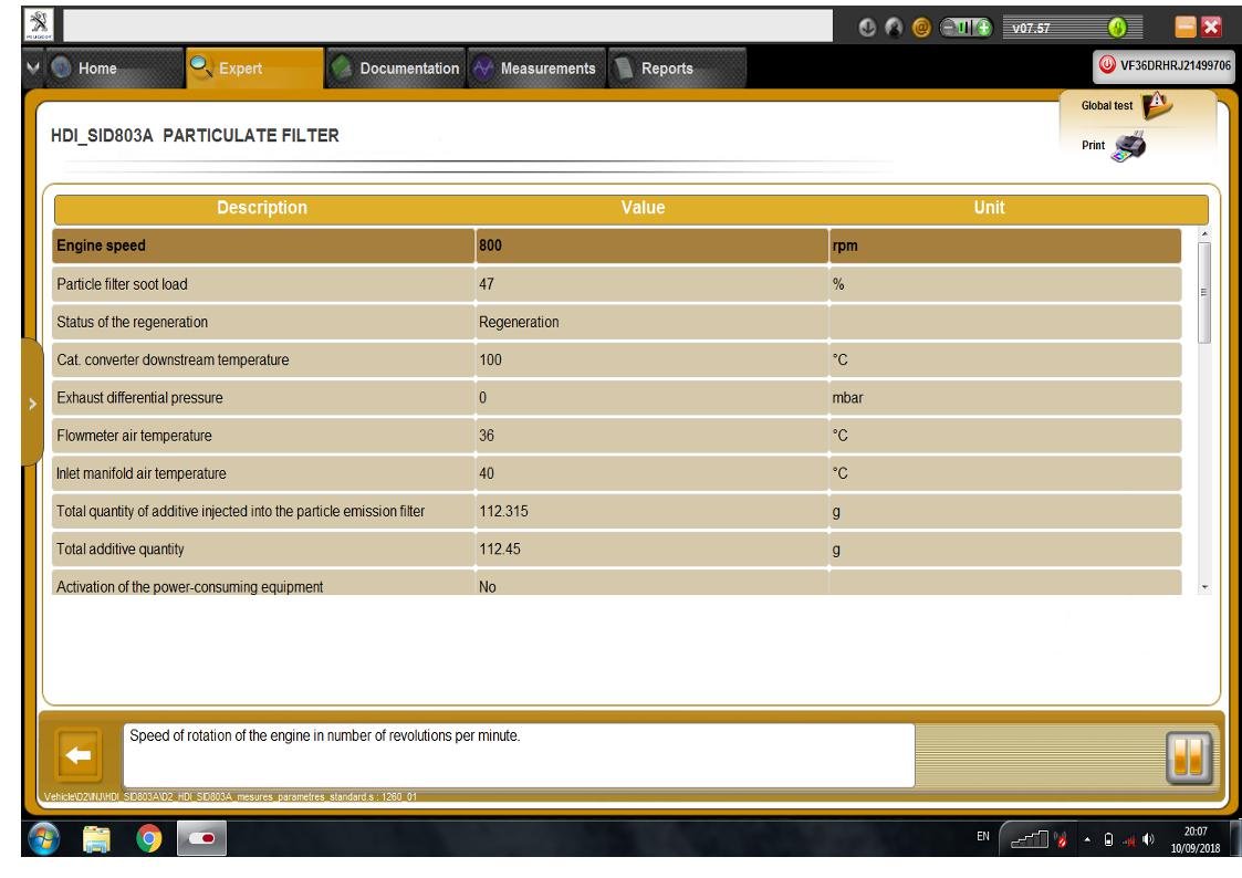

You average distance between last 5 regens is shown as 549km (~340miles).
Showing a soot loading of 43% then driving 200miles you find a regeneration has just occured (2%)
You then drove back 200miles(?) and soot loading shows as 47%
Yes, I still think that is normal.

here's a screenshot, if this is the one you're after Elis...0 mbar? If not tell me where please.

Forgot to mention this stationary with the engine on tickover, but doesn't change when revved.

moizeau wrote: 10 Sep 2018, 19:43 Forgot to mention this stationary with the engine on tickover, but doesn't change when revved.
Yeah, that's not normal and as contradictory as the constant "Regeneration" status.

Right, the differential pressure should certainly change when the throttle blipped as the extra exhaust gas volume will find it more difficult to pass the restriction that the DPF presents; so that is a bit odd.

moizeau wrote: 10 Sep 2018, 21:19 Mike 'Yeah, that's not normal and as contradictory as the constant "Regeneration" status.' please explain.
Next check chaps?
Cheers again
They're contradicting the other reported values, Pete
You should be seeing some pressure differential when the engine is revved, moreso if the reported soot loading is anywhere near accurate.
Regenerations shouldn't persist eternally or occur at idle with 100c exhaust temp or when soot loading is showing below a generous threshold (up to around 60-70% I think) etc.

Are we all sure that this means what it says - regeneration occurs normally on the road anyway, with assisted regeneration only when needed if the car is doing short journeys and not getting up to temp.
I’m wondering if this parameter just indicates that the system is doing its job normally and nothing more, as opposed to it reporting ‘Regeneration not Possible’ for example.
Has anybody checked their settings to compare?

You might have a point there, I have only provided screenshots of the Delphi system. We need to see the status of the Siemens ECU menu for a proper comparison.
That said, there is definitely something up with the differential pressure reading which will need some investigation.

Marc, regen occurs normally on the motorway, it's on A roads with slowing down when it gets the hiccups. The fix is yet to be be proven, possibly this week? Only says 'regen not possible' if the engine is off, as far as I've seen.

As for suggesting other things you might want to investigate... Personally, I'd be concerned why the press. diff. is showing a flat 0mbar when revved.
Are the take-off pipes fully connected and leak free? Is the PressDiff Sensor working properly? etc.

....'Personally, I'd be concerned why the press. diff. is showing a flat 0mbar when revved.
Are the take-off pipes fully connected and leak free? Is the PressDiff Sensor working properly? etc.'
Please can you instruct me Mike on how to check, and where they are? I'm guessing the sensor is screwed in to the exhaust, I've not been under the car yet, apart from when I removed the bumper to change the headlights. What are 'take-off pipes?
