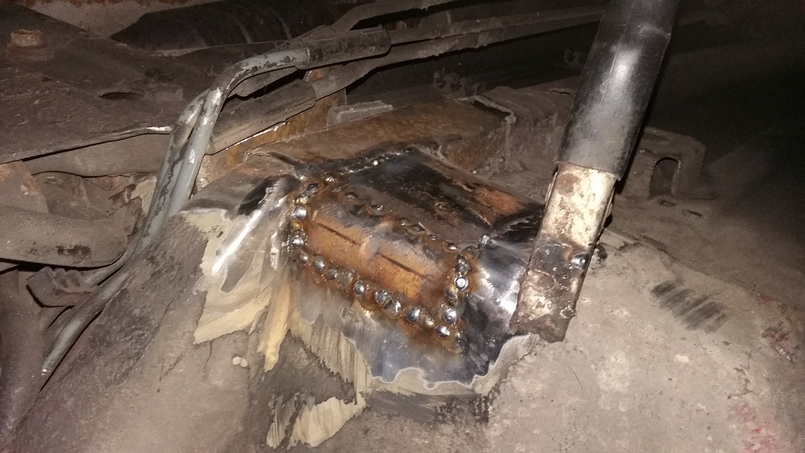

Well, that is the "shaped part spotted into place, time to clean it up and get to the flat bits.

That's looking excellent Alasdair :)
A proper job =D>

I will run a bead of weld once all the other parts are spotted into the correct position. The inside edges and small inside plate by the subframe will test my yoga skills :)

Unread post by demag »
I was wondering what that long thing was on the left. Then I realised it's the earth clamp! :rofl2:
Is that under the pedals, or t'other end? :eh:

nice job, that's the back of that one 'broken' :)
I guess it proved most practical to work from the outside rather than the inside?

Re: ZX Volcane Sold - getting fixed up
Unread post by Stickyfinger »
@ demag:
The bottom of the right side front wheel arch and the short section of the chassis rail/cross member behind it. Also extends on the inside edge of the chassis rail under the fuel lines to just short (thankfully) of the subframe mounting area.
@ Pug:
No penetration through the double skin so the footwell skin is intact.
I am very lucky it is so localised, as I said, another 6-12 month and I would have sold it on as spares/project or scrapped it

Yes I thought that area. Is there any more rot apart from that already outlined Alasdair?
All clear, which is nice and reportedly very unusual for a ZX of this age :)
Some areas of underseal have taken a hammering and are breaking down so I have to do some dirty work on that for preventative reasons and I think a good Dinatrol injection into the box sections and double skin areas would be advantageous for the long term as I am sure there are areas "inside" that need it now.

Thanks for that Sticky, I've not welded a floor as yet and wasn't aware that they're double skinned.
Most modern late 80/90's car onward are I think.
