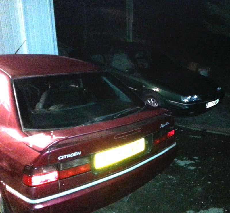

New home away from the city for two sad old Citroen's. Welcome to the slaughter house

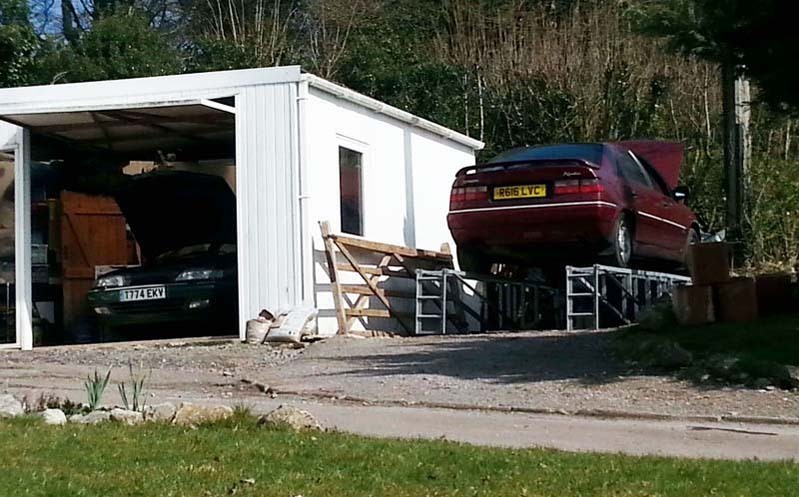

The donor cars are moved about....the Activa up on the new ramps to inspect and the V6 in for the engine out...

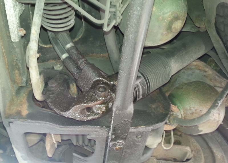

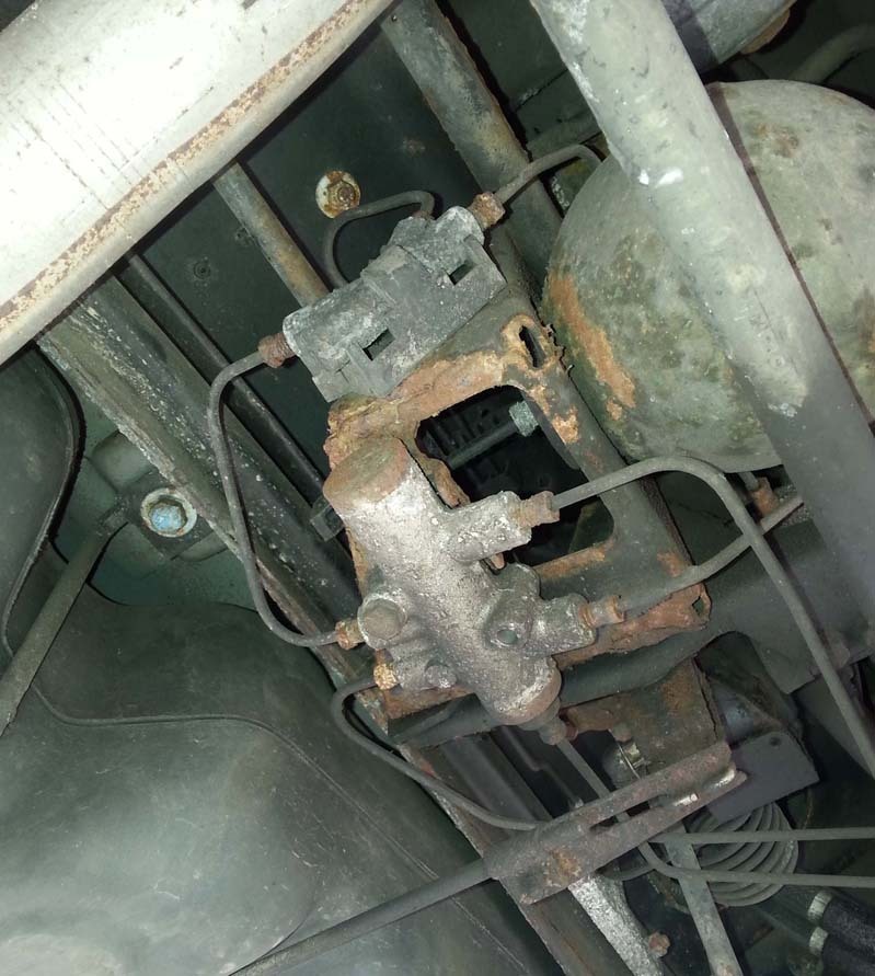

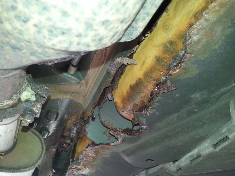

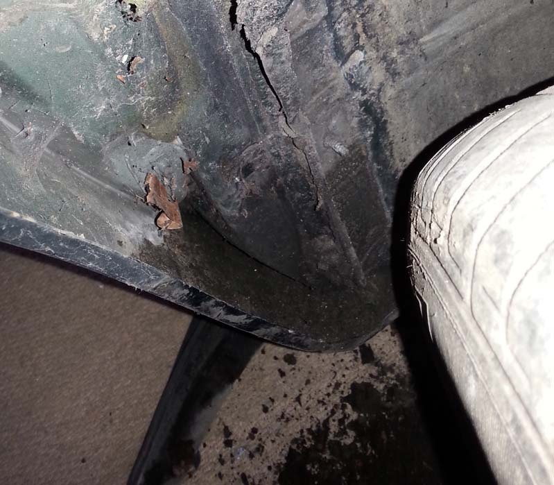

This is what I found on the Activa
Posts: 55020
x 8353
Re: shortly to become an Activa owner...Project Stictiva
That rust is both amazing and unique Sticky!!!
Those rams are not bad and both fixable..
You've sen my article on fixing them haven't you?

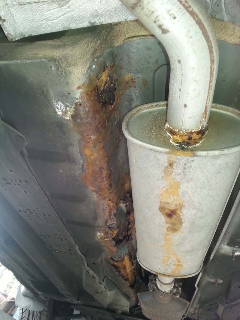

The rust is so localised......I an quite tempted, my mate up the road will be down to see it later and offer his view regarding cutting it out and welding it all up ........we shall see but I think this will stay as a Spares and Learn as you Strip car. Shame because the rest is not to bad it seems.
The Local Activa I saw yesterday was very flaky under, been stood on grass for 9 months....shame....and the owner thinks it is a super car and was thinking he should get about 3k....I laughed and left. Shame as it was so close.
I have read your ram notes, good stuff.....it will be one of the first things I do after having a good study to draw up some type of plan of works.....last thing I need is three cars without wheels and engines all at the same time.

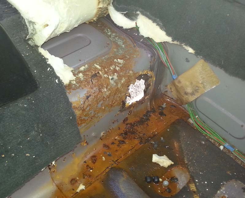

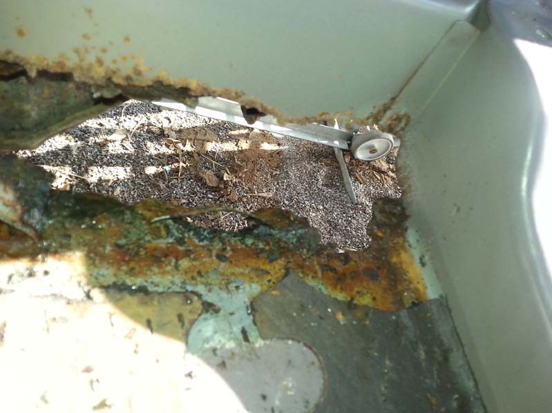

And from the Inside...carpets were sodden so that is what knives are for :)
The rot seems very localised to the side panel....strange

Killed by wet mats by the looks of it then....
Stickyfinger wrote: PS...if anybody really really wants a 2ltr UK Activa......I know where one in for £2.5K (little lol)
It would have to be super-concours to attract that kind of price-tag...
I've seen other cars that have stood on grass and they've been lovely...
From the top of the sills up...

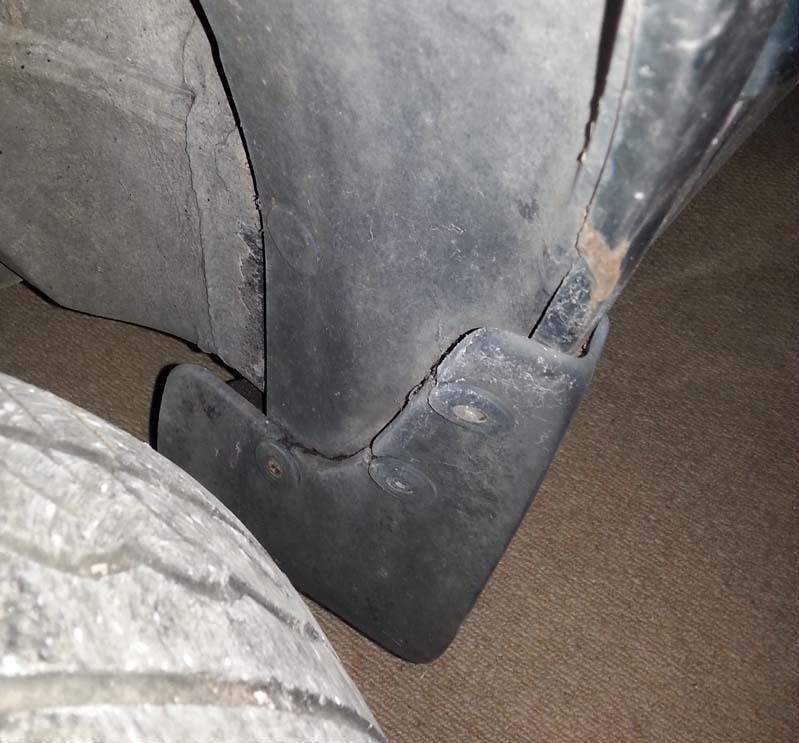

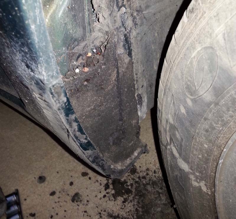

IF you have mud Flaps fitted like this....
Then THIS is what you could find :)
And Under that.....
No rot....amazing ...even deep inside

My Activa doesn't have front guards, but inside the wings was full of mud exactly like that, just the same.
No rot at all though :wink:
:shock: I am amazed at the rot on that transmission tunnel!

wurlycorner wrote:My Activa doesn't have front guards, but inside the wings was full of mud exactly like that, just the same.
I will be working out a better edge that seals the wing to the wheel arch liner.....I cannot think of a worse design than this for a liner and mud flap....defeats the object 100% good job :)
wurlycorner wrote::shock: I am amazed at the rot on that transmission tunnel!
Looking close, to me it seems to of rotted on the outside first and let water in rather than wet carpets, the tin work is thin double skin so will go quick if penetrated.

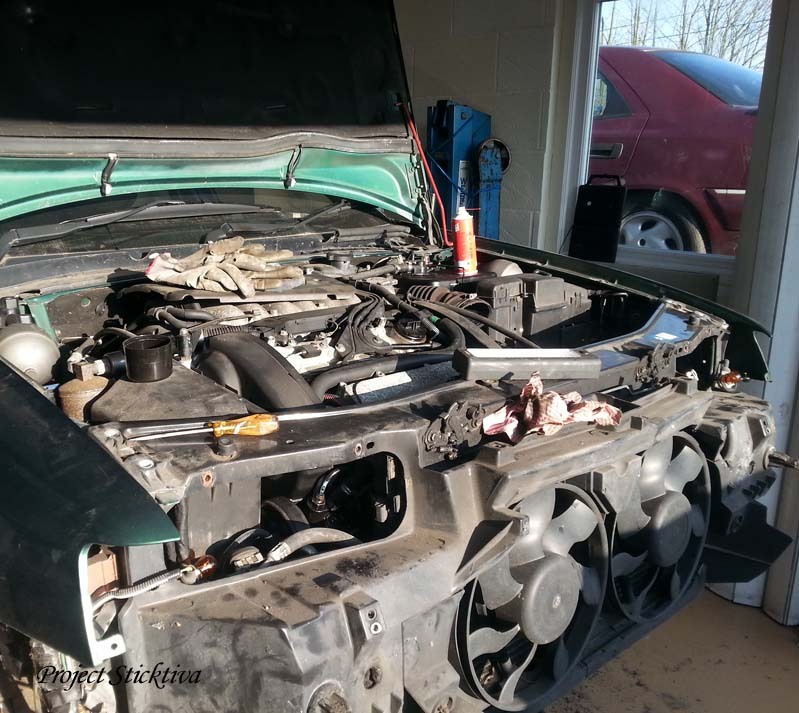

More work today on stripping the V6, my welder mate is here tomorrow to have a sniff at the Activa. (floating past the window ...)
The V6 strip-down starts in earnest, bumper and forward panel off.

The bumper was a pig but nothing broken an no wires pulled out from god knows where :)

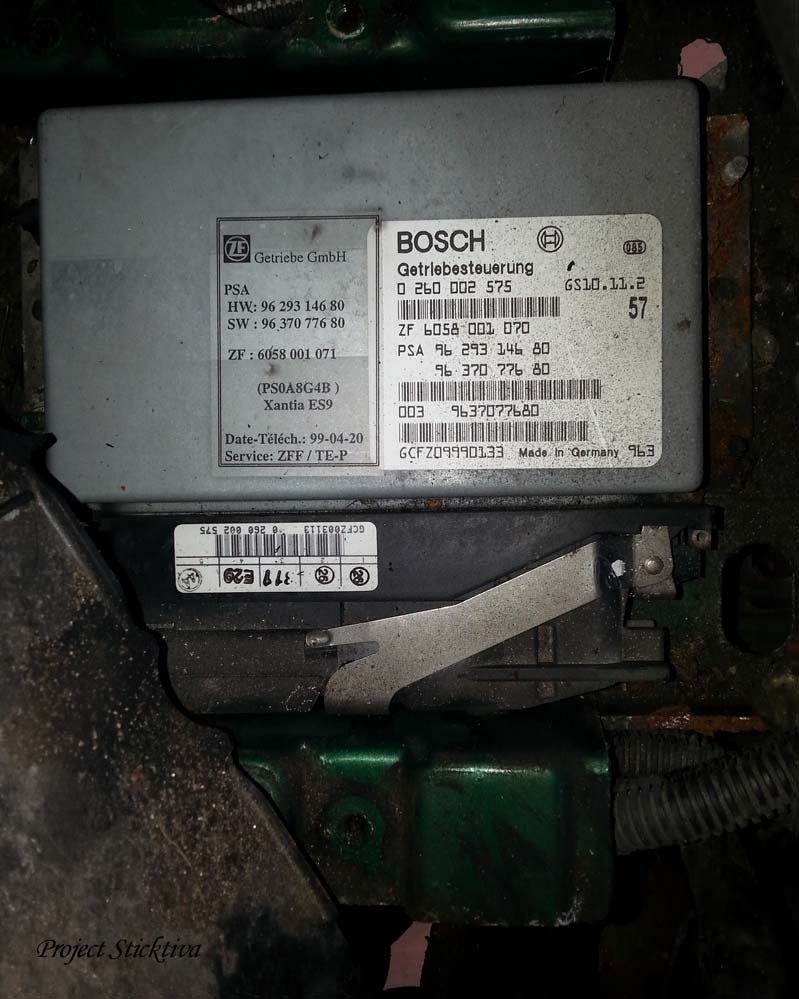

Looking at your pictures I always think what a stupid position that was for the autobox ECU in the V6 Xantia...
Your disassembly is coming along very well...
