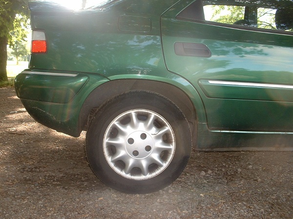

Re: 2.1 TD Xantia on a budget
This looks a suitable thread for the ride height (although there are a few more involving stripping down/refurbishment)
I'm hoping mine just needs adjusting and will then provide a smoother ride
and also reduce my overrated 70's hot rod look
Xantia ride height
I will try to add some before and after photos ... but please don't take the p**s out of her appearance
....she's sensitive you know
This is the before image idling with suspension set in the middle position to drive approximately 40mm too high
I'm sure you'll agree that she's in 'hot rod mode'

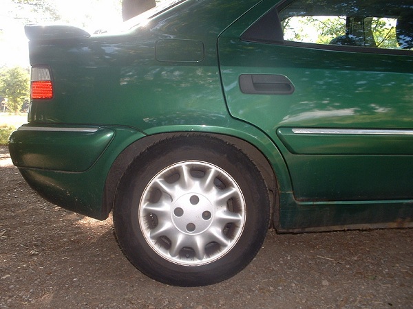

Followed the advice from CitroJim on the above link - still surprised how sensitive the clamp was to rotation. Pushed the bolt head up to reduce the ride height.
Cheers CitroJim
Much better - probably try a tinier tweek next time she's got her arse in the air

- Posts: 55209
- x 8455
Pleased to have been of assistance!
I'd say the rear ride height is still just a tad high.
How's the front ride height? That's even more critical to good ride comfort.
CitroJim I agree that she's still slightly high at the rear, according to my measurements the front was within tolerance prior to any adjustment.
I will get her back on the ramps and 'tweek' the rear slightly and then re-measure and post a full side on photo when I'm happy .......
