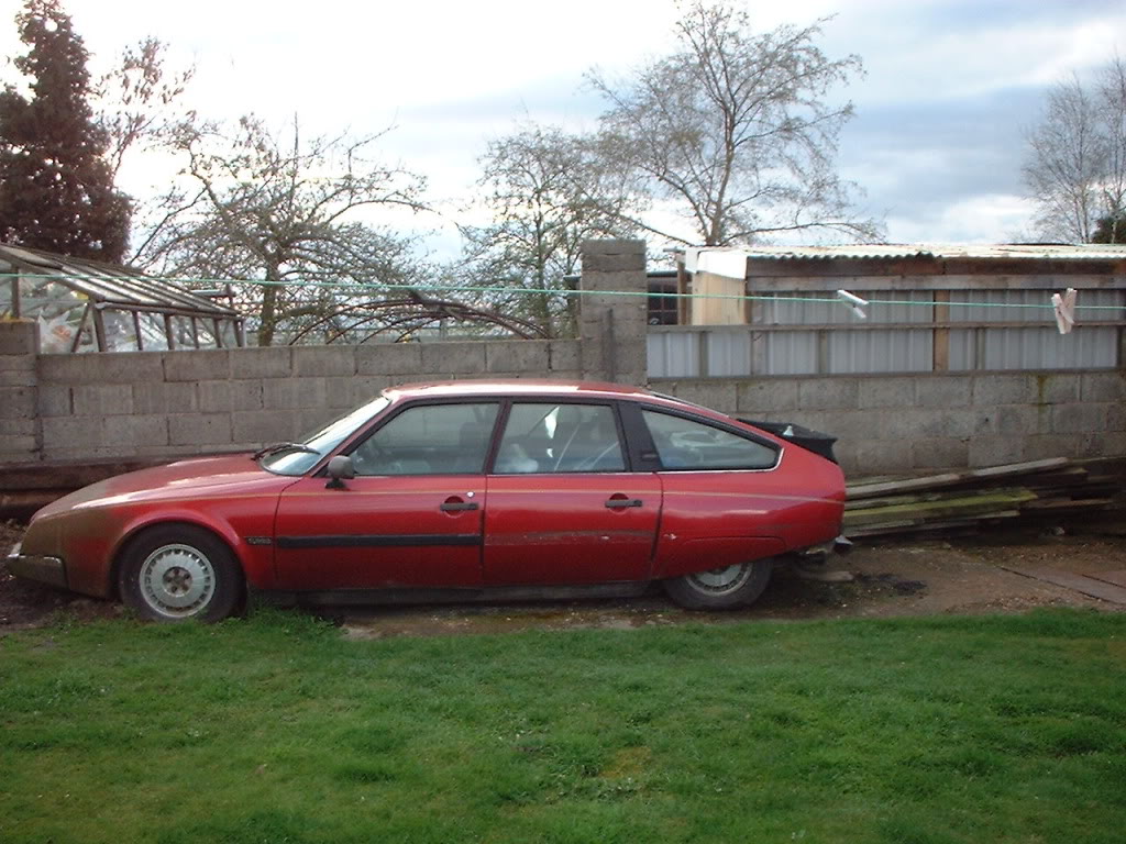

not good examples, this car donated it's head for the good of science 'gasflow and porting limits'
one of the originals :(

Did you buy and break this one from Stroud then Neil? I nearly succumbed...

andmcit wrote:Did you buy and break this one from Stroud then Neil? I nearly succumbed...
noo this one was in Doncaster about 3 years ago. I was looking for a cylinder head for a tuner with a flow to do some tests with.
It flows more now than the Maikonics head I have ;)
