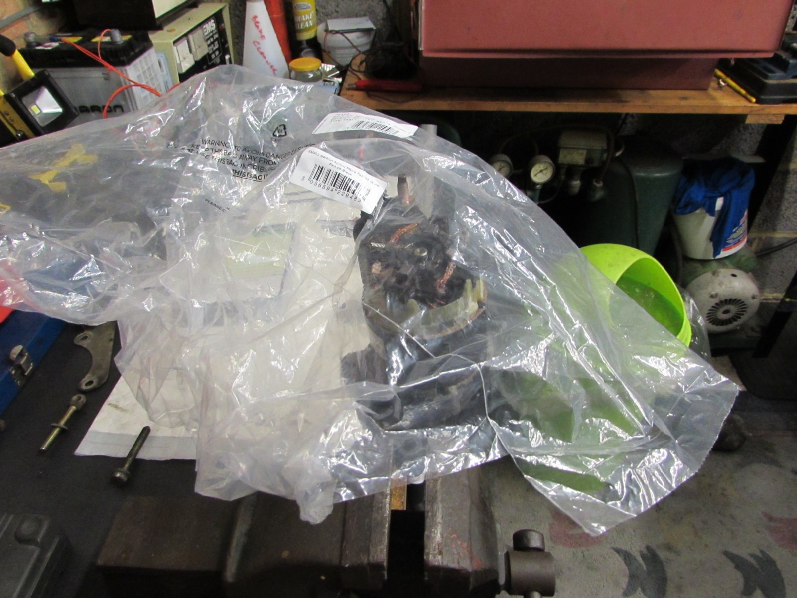

I then, once a lot of critical parkrun admin - in a coffee shop - was attended to, I could return to my 'springy' starter motor...

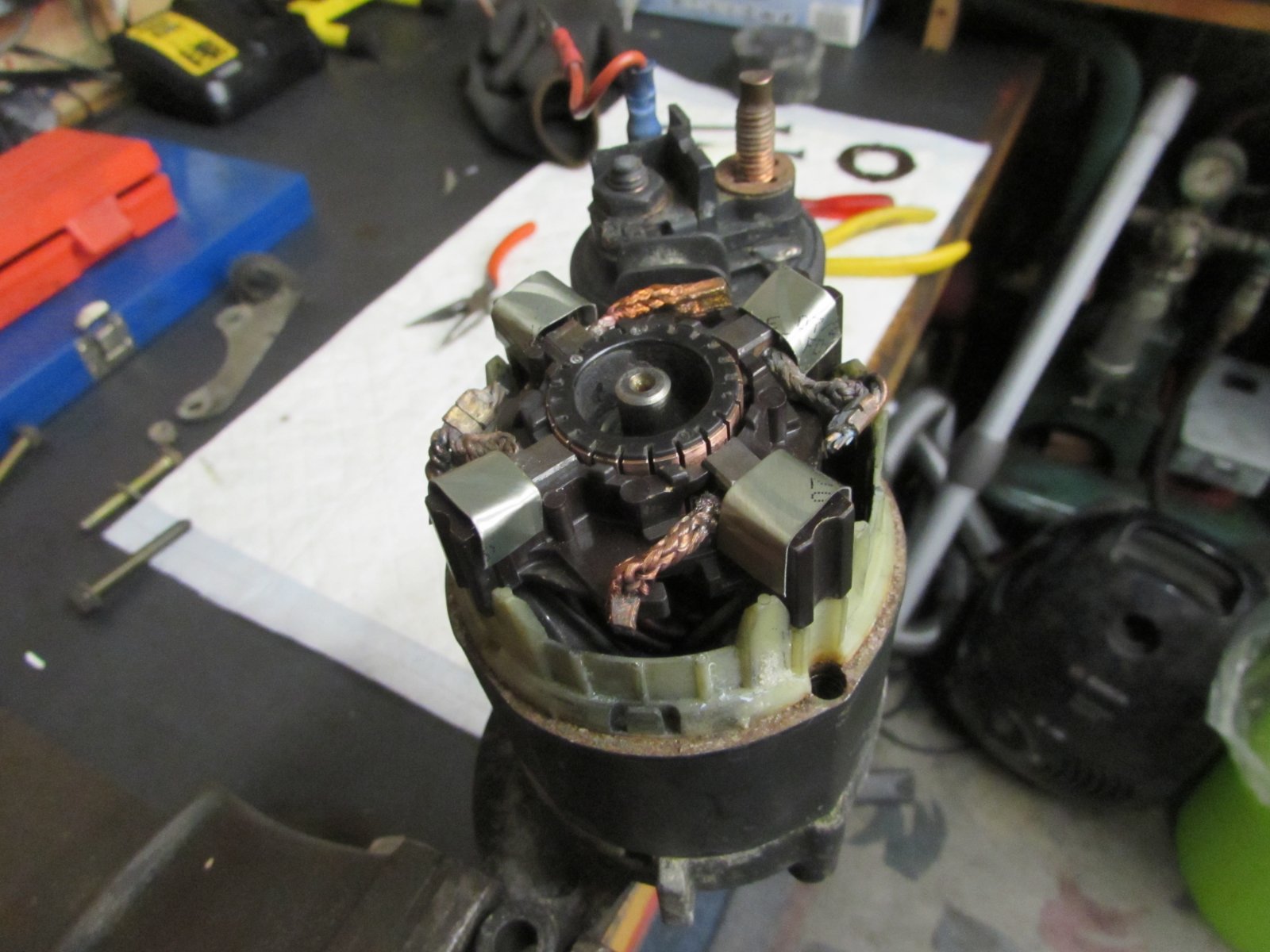

My 'tent' plan was tried but it failed :(
It worked insomuch as it contained a 'flyer' but the fundamental problem was that one spring, nicely placed, would go ping when another was fitted due to slight armature movements.
The solution to this was to make up a set of retaining clips using a tin can for the raw materials:
Once all were in, the clips could be carefully removed and the paxolin retaining plate refitted :D
Job's a good 'un ;)

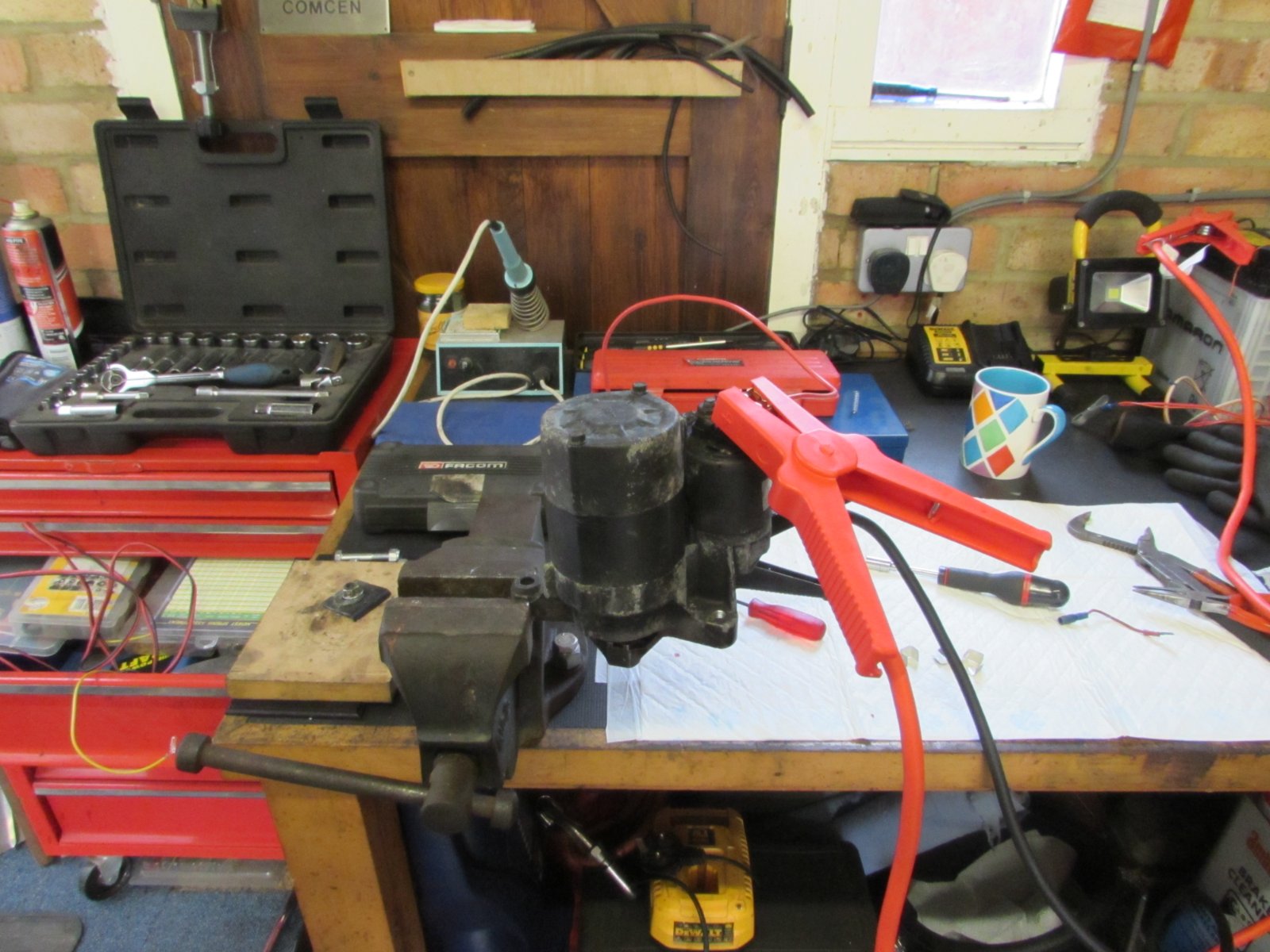

And even better today when I bench-tested it :)
